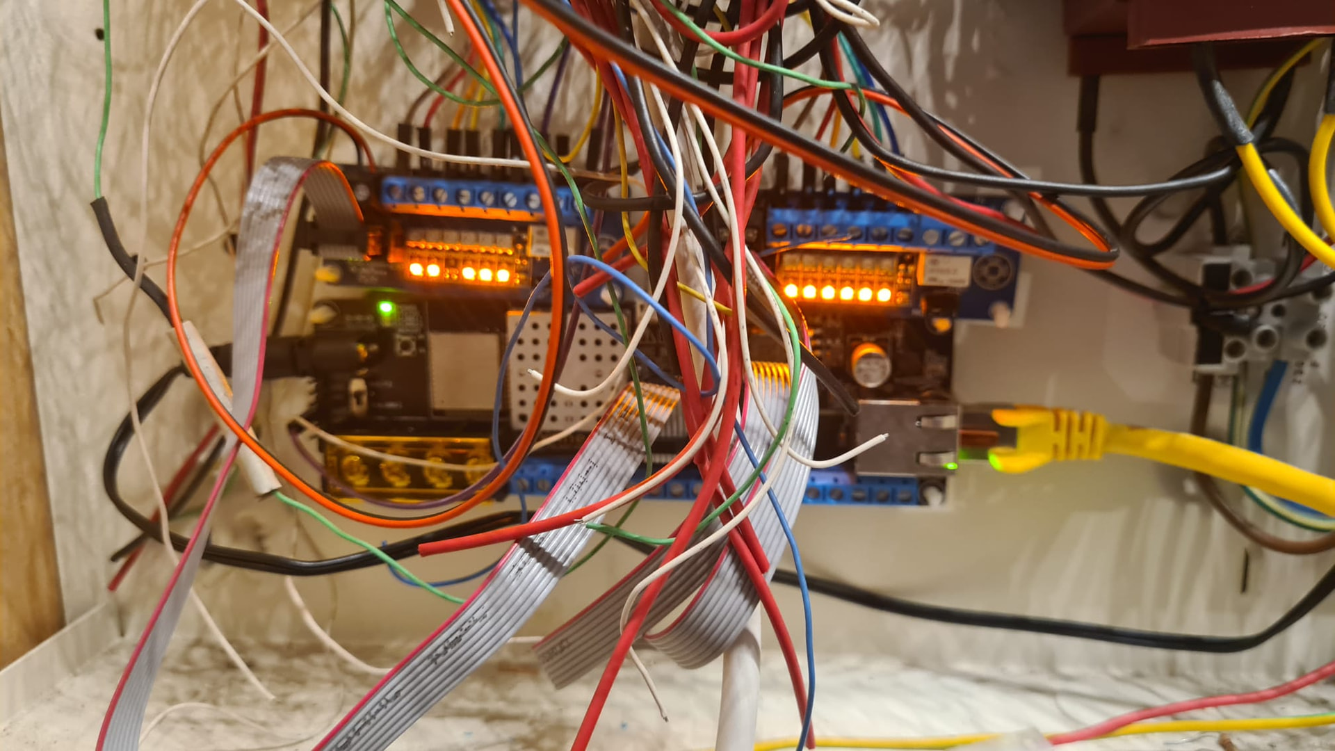

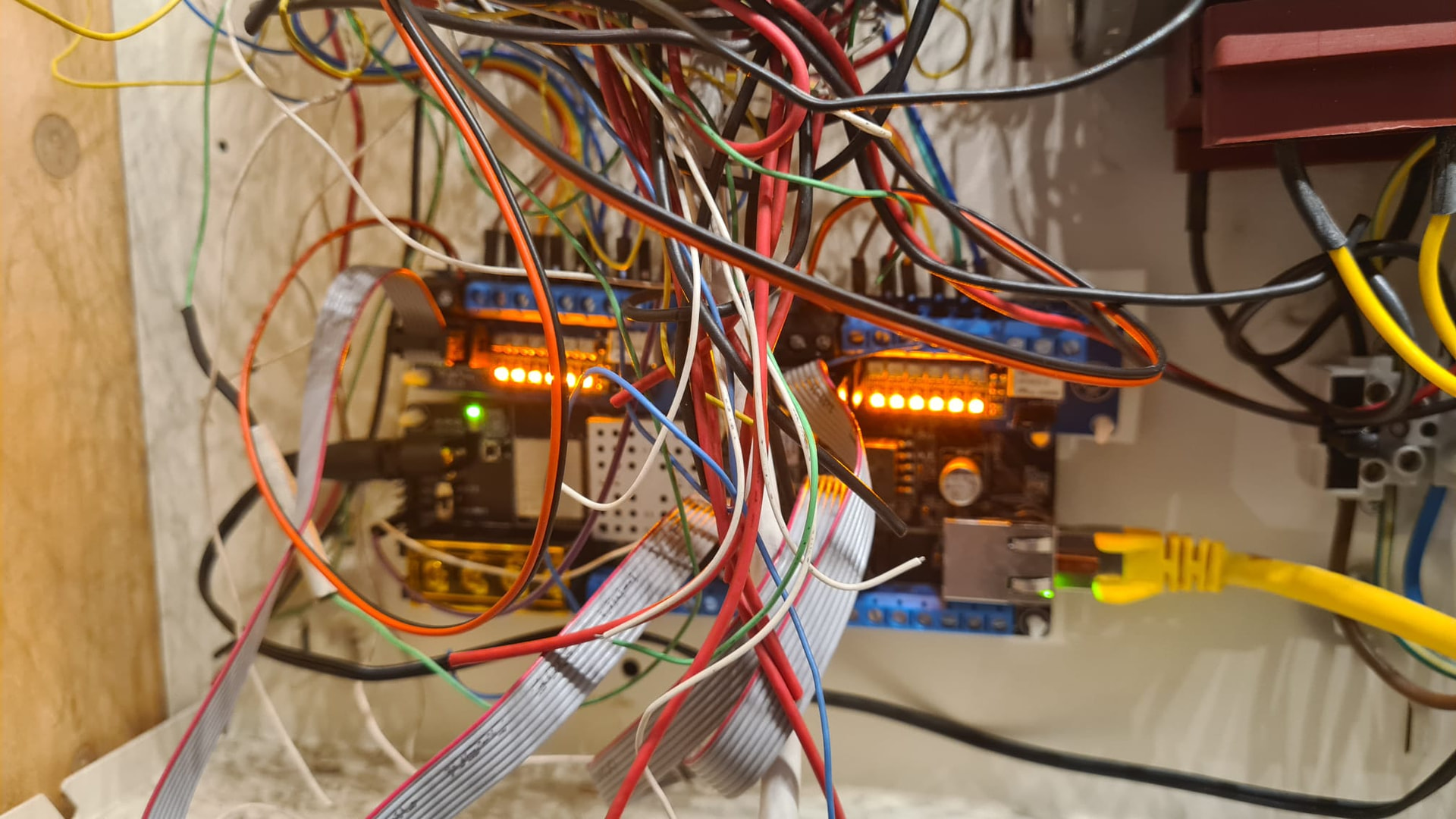

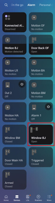

Issue 1: One of my inputs (Zone 3 named Windows BJ) remains ON all the time
It is cabled correctly and tuned properly, the orange LED turns OFF properly when physical sensor is activated:
And turns ON again when physical sensor is deactivated again:

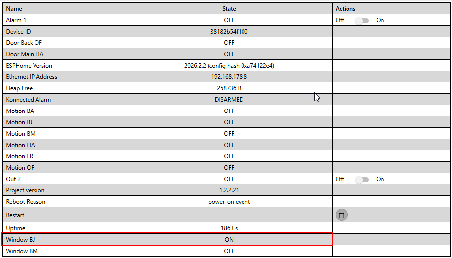

However it remains constantly ON in Konnected Web page:
or on SmartThings:

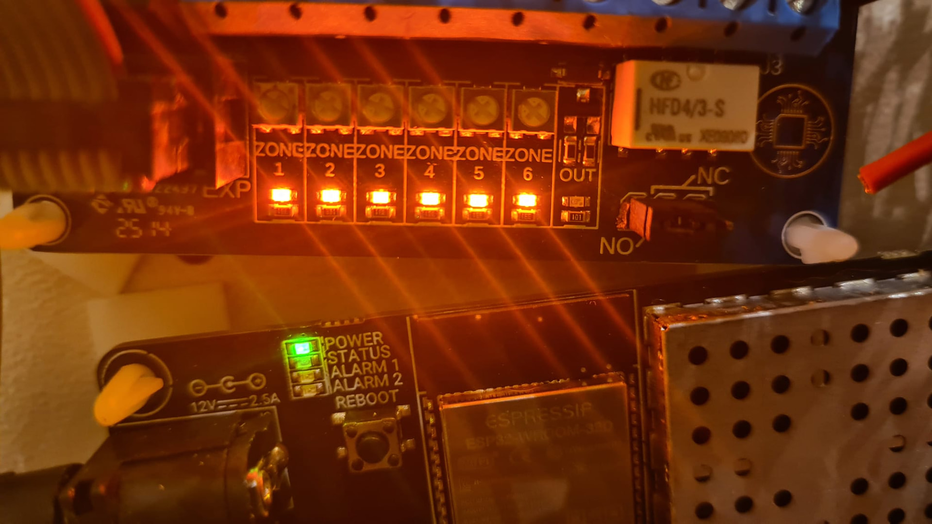

All my other inputs work fine, only this Zone 3 is stuck to ON, and to make sure it wa not a problem with the physical sensor, I swapped with the Sensor on Zone 4 that was working fine: Still the same Zone 3 is stuck. And actually by looking very carefully, it seems the orange LED on this faulty Zone 3 is shining less bright than all others:
Not easy to see on this picture, but just check the ‘ray of orange light’: you can clearly see it is less bright than the other 5 rays.
It looks to me like a hardware provlem on either the Module interface, or the main Konnected Panel Pro?

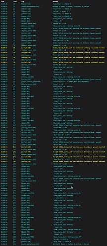

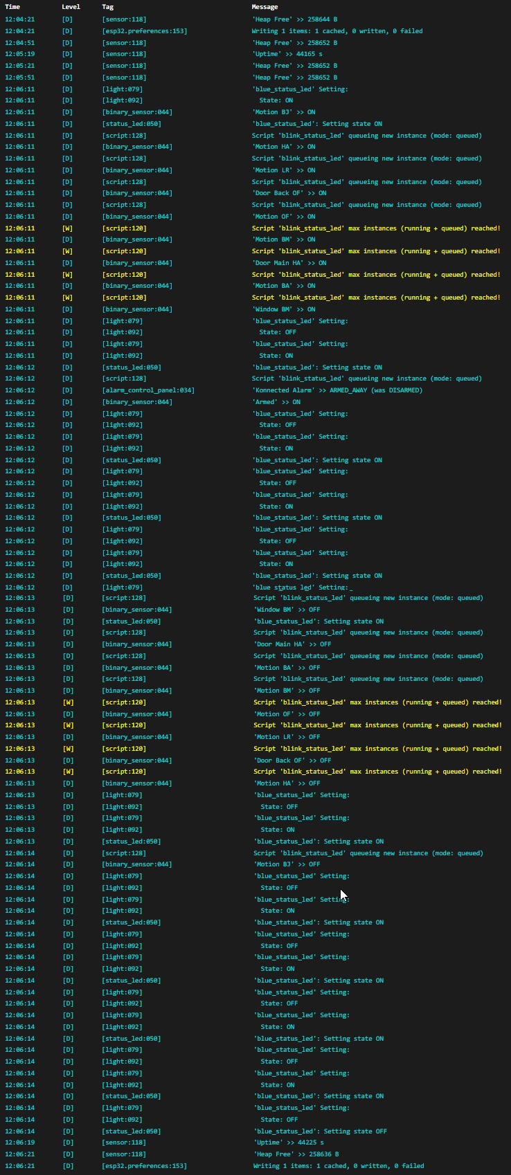

Issue 2: Full reset of all inputs every 2 minutes
When system is disarmed, every 2 minutes (1min59 exactly), all inputs will switch to ON then OFF, also triggerring a weird error ‘Script ‘‘blink_status_led‘ max instances (running + queued) reached!’. Even Armed input (zone11 in my case) will be activated, temporary changing the state to Armed:
Any idea what could cause this?

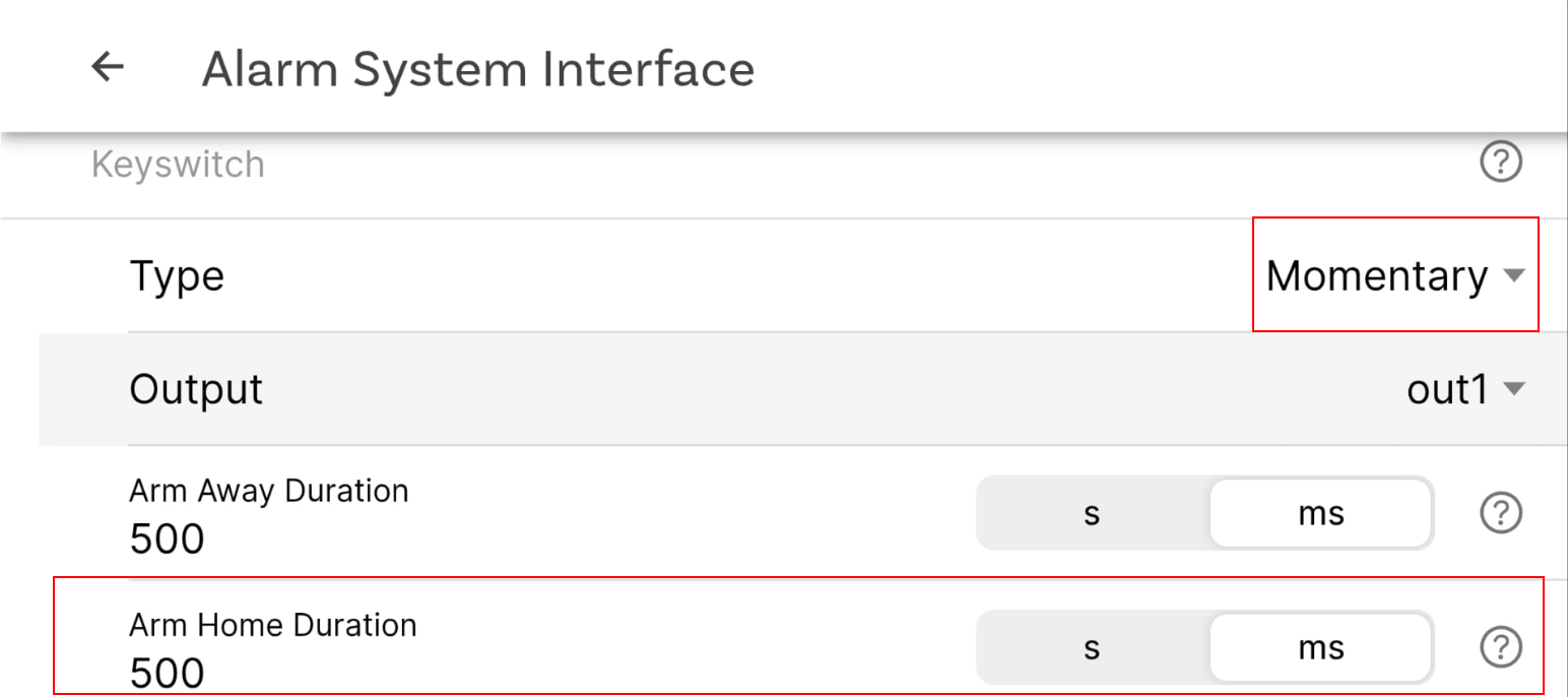

Issue 4: How to use the second Out and second relay for Armed Home:
My old alarm system is not able to distinguish Arm Away and Arm Home on its same zone input, or output from Konnected Panel:
So my question is: how could I use a second output (Out 2) wired to the relay of the second interface module to activate a different zone on my old panel for activating Arm Home?
Also, stupid question, but why is there a Type pulldown when only option I can choose is Momentary? Is there something I miss here?
