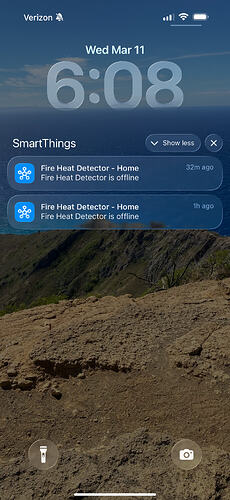

My smoke alarm keeps going off/on line. What would be the best way to trace fault ?

I would be very interested in a fix to this as I am getting annoyed with the notifications.

Seems to be acting the same….
