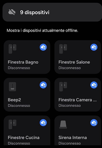

After the AWS down a few days ago, I’m experiencing communication errors between my PanelPro and Smartthings. Sometimes all inputs are offline, other times just the buzzer. I’ve tried restarting the devices and refreshing the connection between the ST platform and the Konnected service.
The problem is that they’re currently either randomly offline or not.
To resolve this issue, I also applied for the Matter program, hoping that a local solution (having an ST hub) would solve the problem.
If you have some suggestion please give to me!
