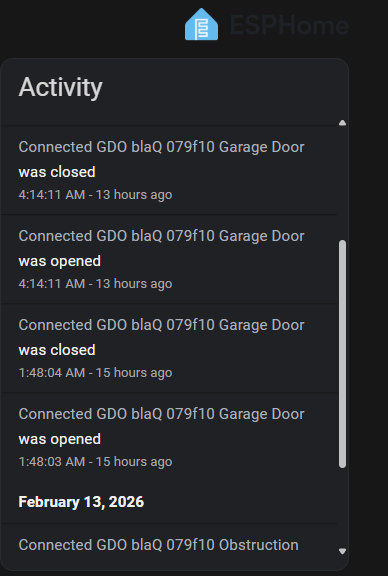

I’ve had a few occasions lately where my GDO Blaq reports, through Home Assistant (and passed along through Homekit Bridge to Apple Home), that my garage door opened in the middle of the night and then closed again.
These are just events though; the door itself did not open and then just as quickly close again. You can see from the attached screenshot that these event pairs happen within one second of each other. Last night I had two pairs of such events, one at 1:48am and another at 4:11am. I assure you I was not manually opening the garage at these times and I have no automations that would run then either.
I’m aware of the thread which discusses some bad interactions between Security+ wall buttons and the Blaq which causes the door to unexpectedly open. While that sounds pretty similar to my issue, the difference in my case is that the door doesn’t physically budge.

  1. Square purple learn button
  2. Chamberlain Motion Detection Wall Control Panel Model 935CB

The problem is the 935CB wall button. There’s an older generation of wall buttons that are problematic, and this is one. You can test it by removing the wall button completely, the blaQ should then work normally.
You can fix it by replacing with the 889LM wall button.
No it’s not possible to override the garage state with a physical sensor.

Progress to report:
  1. after I removed the wall button’s wiring from the motor I stopped getting the rogue event pairs (open, then immediately close)
  2. I installed the BILRESA matter-enabled button right below where my wall button sits (for now) and it works like a charm. Door up / door down / light on. Basically the same functions as the wall button but without wires.
