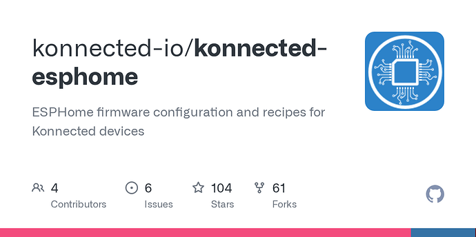

hi @brett19, the firmware is indeed open-source:
If you can provide some more details to be able to reproduce this and if there are any others reporting similar problems then we can look into it. If you find a way to fix it for you, let me know. You can also open an issue on our Github with additional details if you end up digging into it.

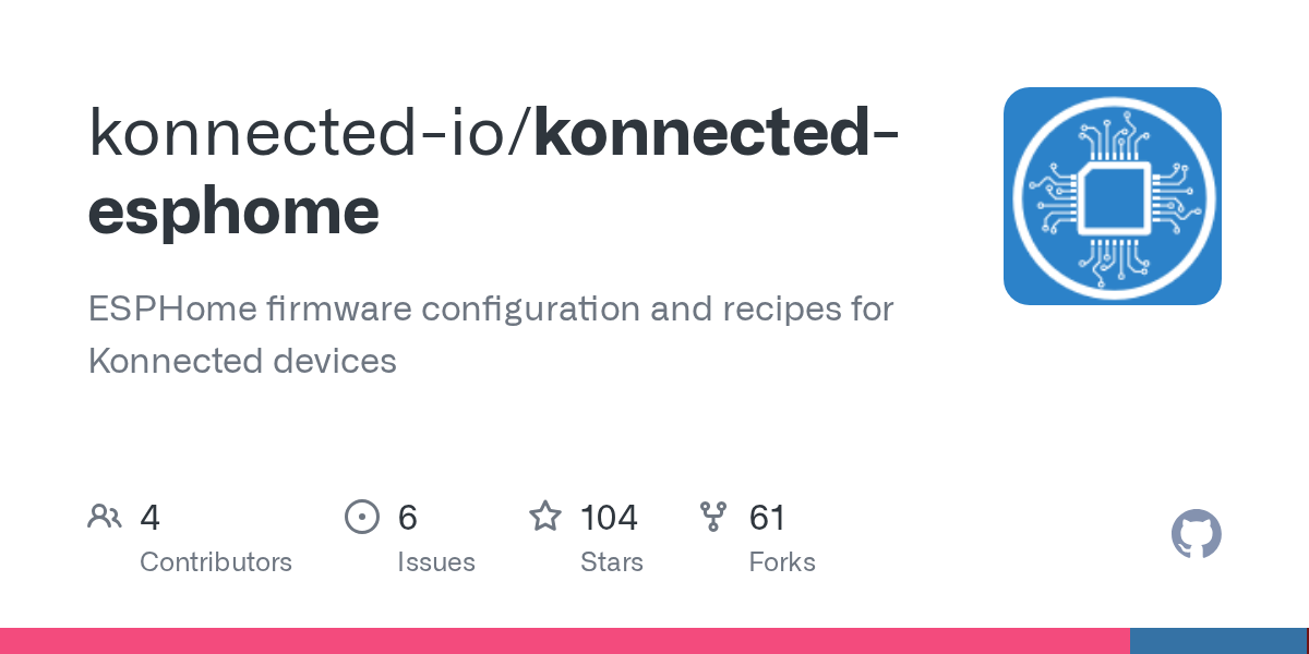

It does look like the library that manages the door has logic to try to deal with these scenarios, it just doesn’t appear to work with some doors:
