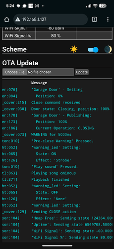

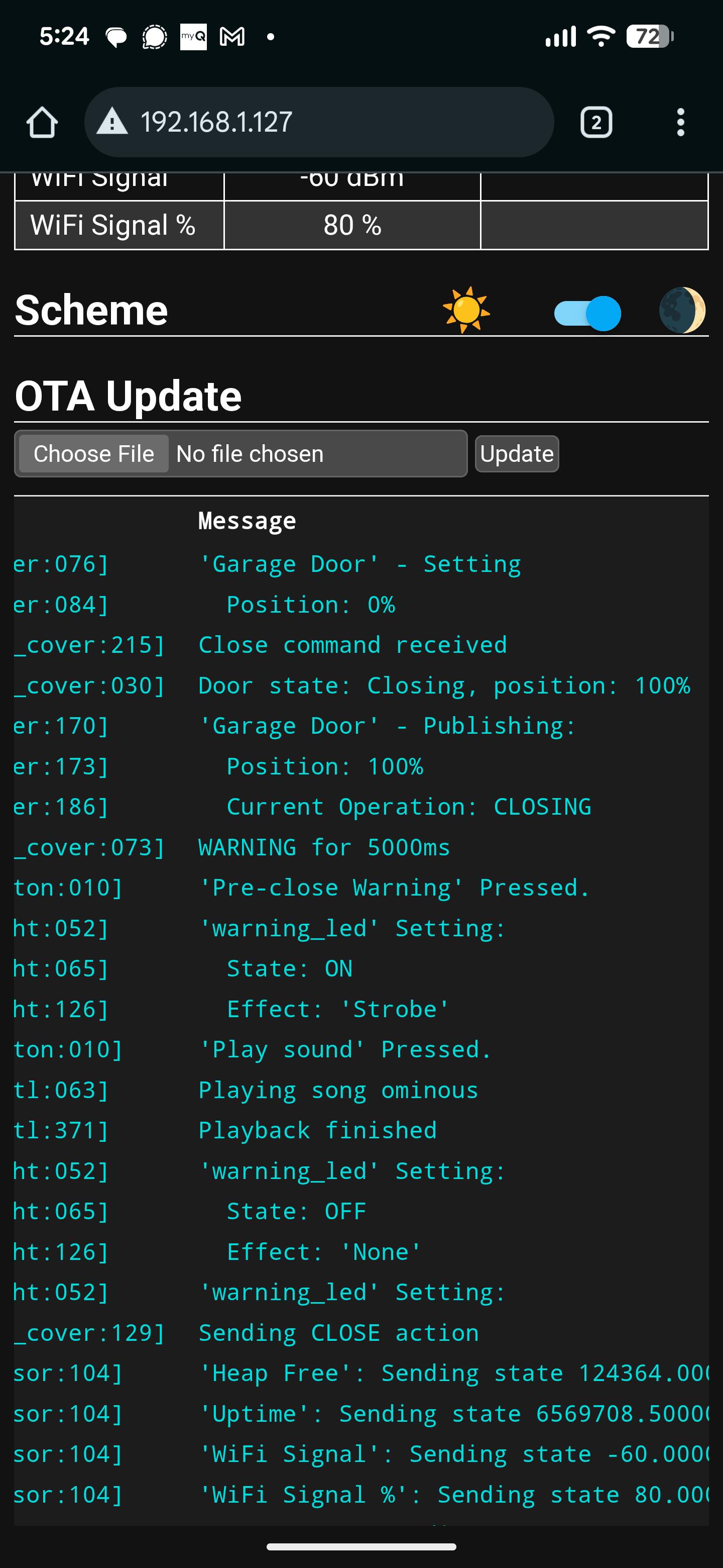

My GDO Blaq has been working, mostly. Using the controls in Home Assistant I need to press the open button twice to open but it does that reliably. The status is reported properly to the controls. But when I press close button I will hear it make the warning tones but after that it doesn’t close.
Is there something I missed?
I just have it wired into the motor of my LiftMaster with the two wires. My regular button that came with the unit still works to close it. I saw a mention of a sensor wired into the Blaq but I’m not finding anything specific about it.

My opener has the yellow learn button. I’ve tried the different security+ versions. I have the sensor installed that is connected to the opener but isn’t connected to the Blaq.
