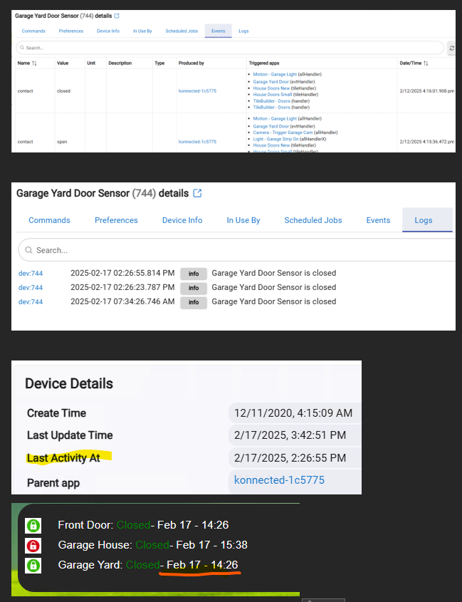

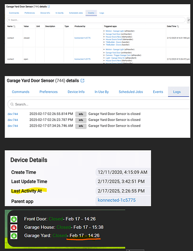

I have a konnected pro panel. For argument’s sake, let’s say all I have are contact sensors. I have a door which hasn’t opened since 2/12, per the Hubitat “events” screen. (1st screen grab below)
However, if I go in to see the logs, it has various updates of the status at different times:
(2nd screen grab below)
This then shows the last activity of 2/17 @ 2:26pm rather than it’s REAL last time it was USED, on 2/12:
(3rd image below)
This is affecting me as I’m trying to get spousal-approval of my dashboards which show when things were last used, however, these times are wrong:
(last image)
So to come full-circle with my question – what is making these lastActivity values update in addition to a contact sensor change? Ideally, I’d like a solution where the lastActivity (or some other variable) simply captures the last time the contact sensor’s status changed.
