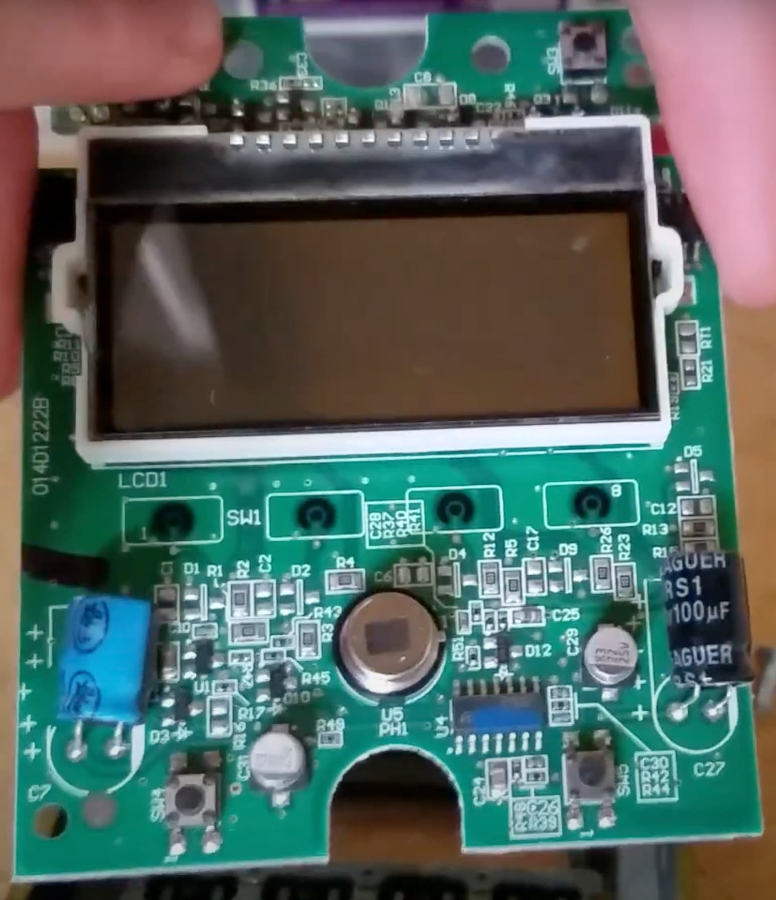

Someone replaced the capacitors on their 2018 dated wall control panel, with ones that have double the capacity, and seemingly hasn’t had a problem since. Read onwards from here:
I would imagine that user on github was referring to the big black and blue capacitors seen here near the bottom on the sides:
It doesn’t look like it would be too difficult to actually replace them, the problem seems to be that the larger capacity ones tend to be physically larger, and thus fitting the board back in was more difficult.
