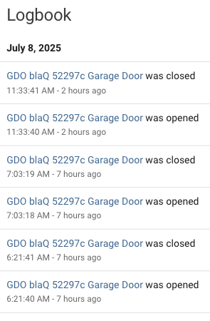

Anyway, I have alerts setup in HA to let me know if the garage door opens and no one is home, and it kept triggering, and I noticed this in the logs:
The garage door isn’t actually opening, so as a work around, I set a little delay on the alert I have setup. I suspect it’s either a failing wall control panel, and/or the wiring for it, rather than the blaQ itself.

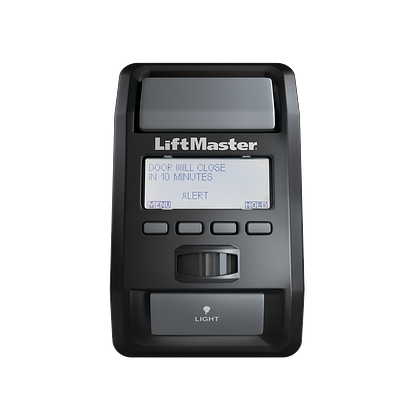

Just for reference, I have another location with a Lift Master on Security 2.0+ and was considering replacing the wall control with this one:

Yes, we have heard a few isolated issues with the 880LMW panel, but it’s not widespread. I was unable to reproduce the problem in my own testing with the 880LMW, and many others have reported it working fine. So, I’m thinking its a capacitor issue with certain wall buttons, and not a protocol or GDO blaQ issue necessarily.
Alright, I’ll grab one and give it a go! Thank you!
