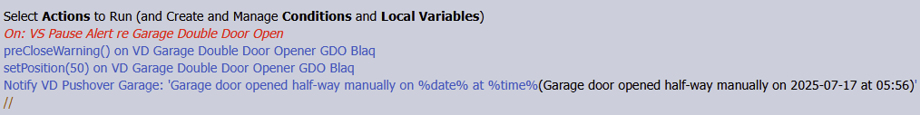

Problem #2: If door is open, setting to 50% open doesn’t work – door just closes.
I have the following Button Controller rule that fails to stop the door at 50% if the door starts at OPENED (the rule works if the door starts at CLOSED).
The rule is activated by pushing a button on a remote control unit.

It is a known issue that the partial opening/closing only works (on most openers) in the opening direction. This is something we’re still investigating and may be fixed in a future firmware update.
