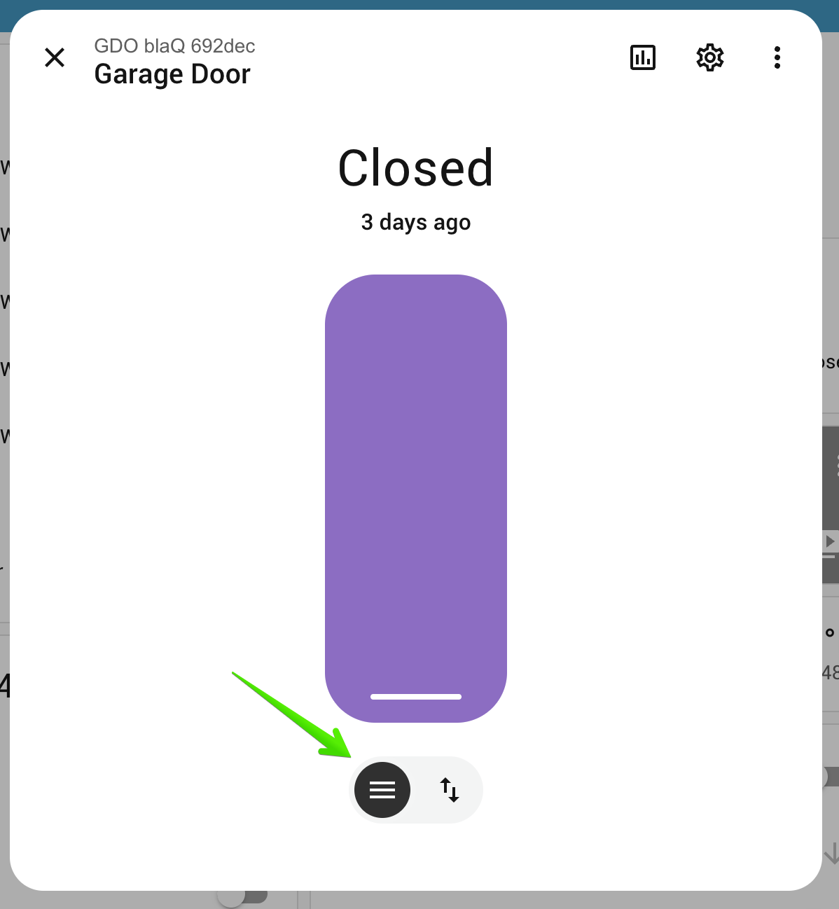

So to start with the second issue. (This may be very picky but its a feature i saw and i want) in home assistant i cant see the current status of the door. In promo videos it showed the percentage open and closed the door was but i don’t see that when the door is moving. I do see it in the web ui however. Can i fix this?

This should work out-of-the box. Click the three lines icon to show the slider view in the Home Assistant garage door (cover) entity.
