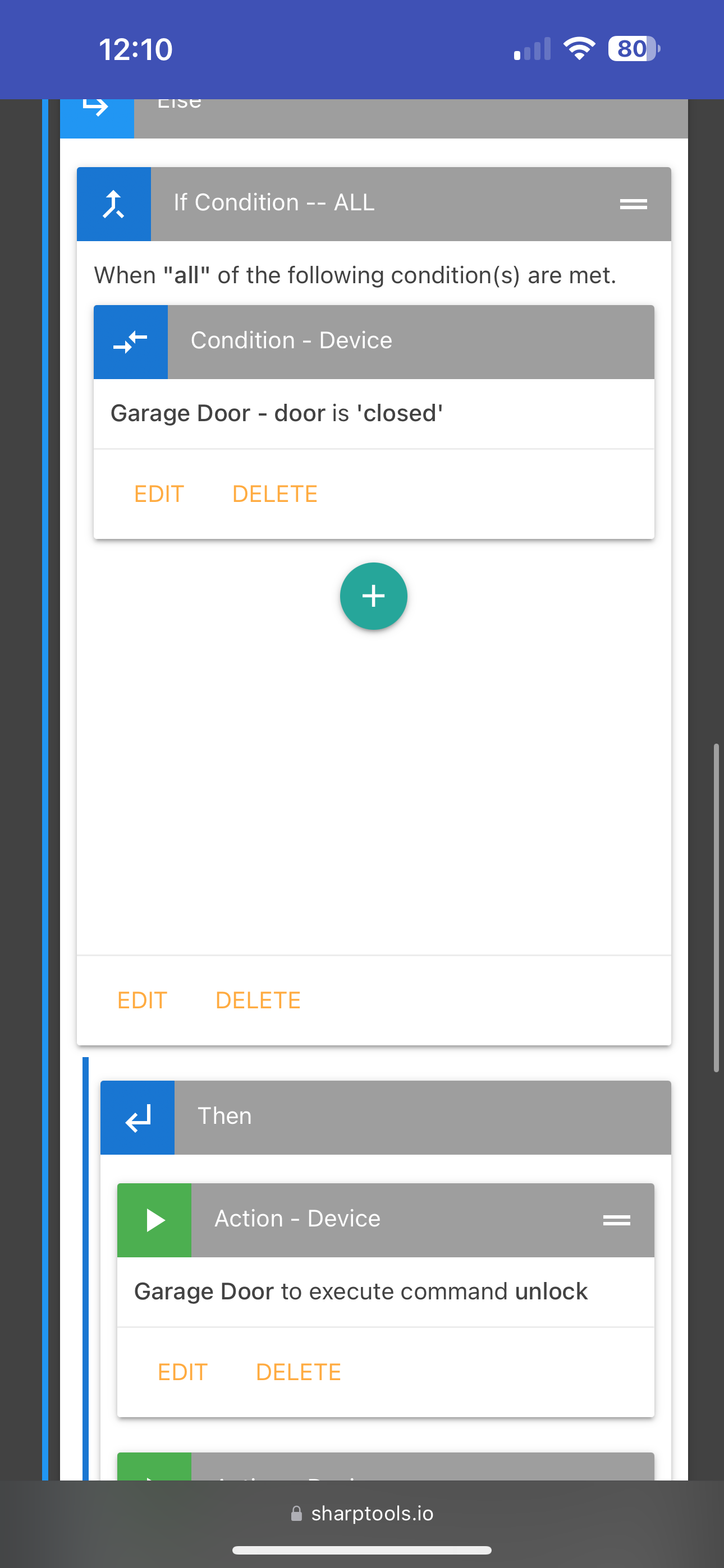

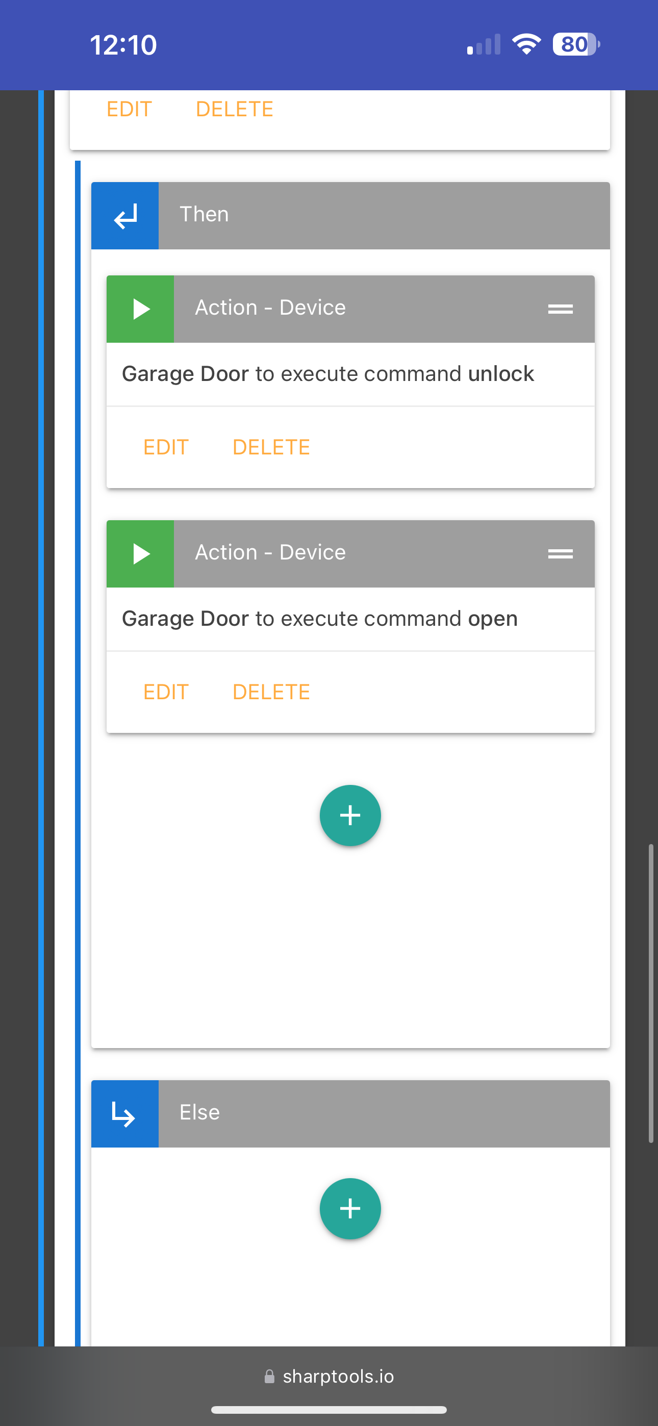

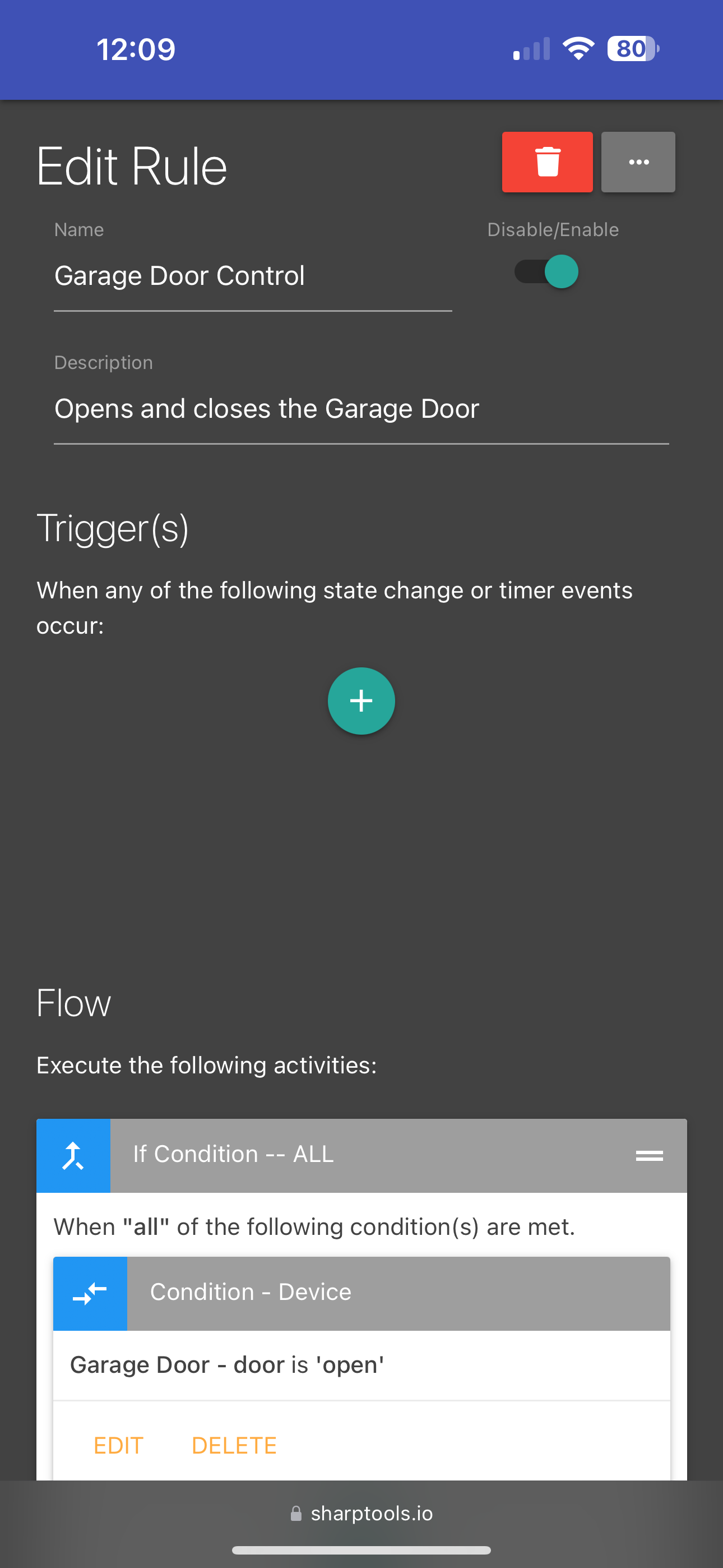

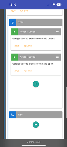

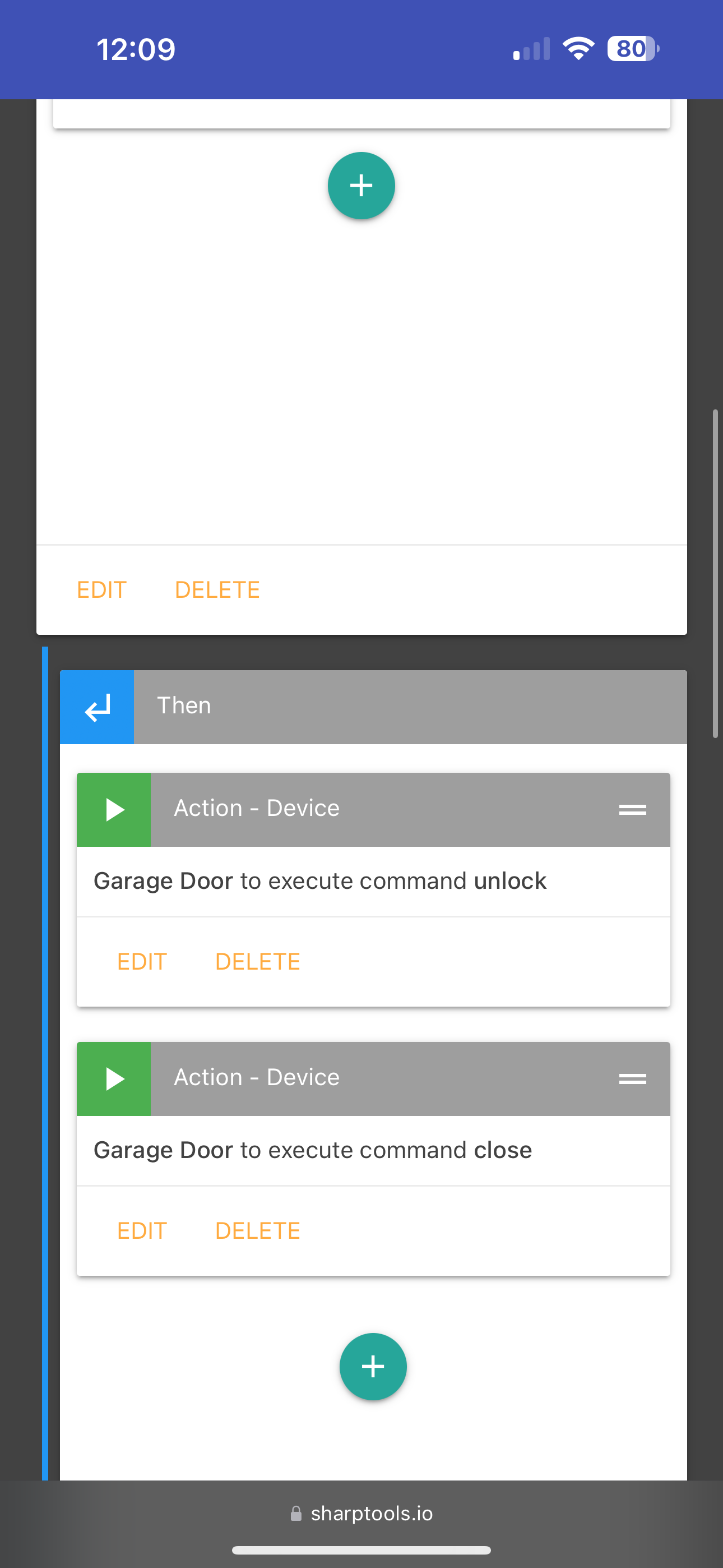

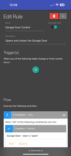

Yes, sounds like the exact same issue. SharpTools, I believe, gave me a workaround that has performed flawlessly. I’m trying to find the original info. It involves creating SharpTools rules.
I cannot find the original info - I believe it was a support item and not a community post. Here are screenshots of the SharpTools rule they suggested.
I don’t understand this at all. Why would you need to add additional rules? Why would sharptools be controlling the lock/unlock anyway?
I wish I could remember. The issue occurs in Sharptools, not if you are controlling the door directly in Hubitat. The rules are a workaround to take a bad? misinterpreted? variable and change it. The issue only occurs when controlling the door in Sharptools. I’ll see if I can find some of the emails that I exchanged.
Found them…
Last of a long exchange with Josh at Sharptools. The workaround involved a rule and proper configuration of the Sharptools tile. Hope this helps.
I suspect the issue is related to it being a single device with switch, lock , doorControl and other capabilities (rather than child devices). And when used with the Door Control Tile, it’s actually using a generic ‘Thing’ tile layout under the hood and it’s calling a virtual toggle() command under the hood that’s likely toggling multiple capabilities.
I’ll take a look at what options we have to improve that in the tile. In the meantime, you have a few options:
  • Create a rule that will send the appropriate open() or close() command based on the current door status
  • If there’s a different driver that either has just the Door Control capability or uses child devices which each have only the capabilities they control individually (Lock, Switch, Door Control), that would solve the issue as well
