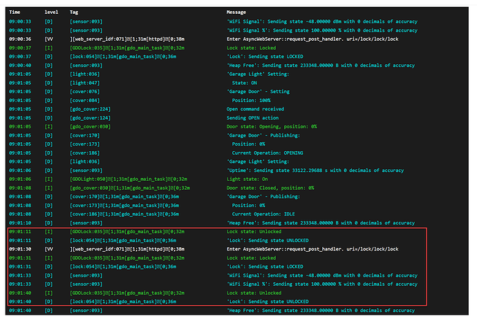

That said I have been encountering issues with my openers ‘randomly’ getting set to a Locked status which then disables remotes. More recently I have been unable to open my garage doors from Sharptools. I have been attempting to diagnose the issue and have managed to capture some of the behaviour.
Firstly I am not sure where the issue lies between Konnected, Hubitat, and Sharptools as when I initiate an open or close from Konnected or Hubitat things seem to work fine.

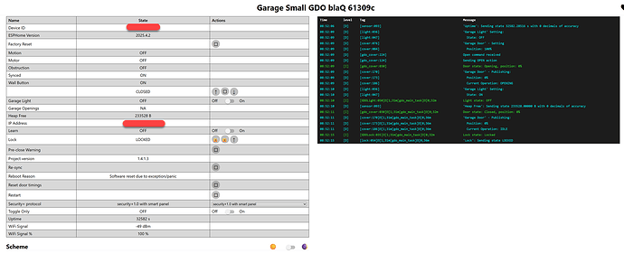

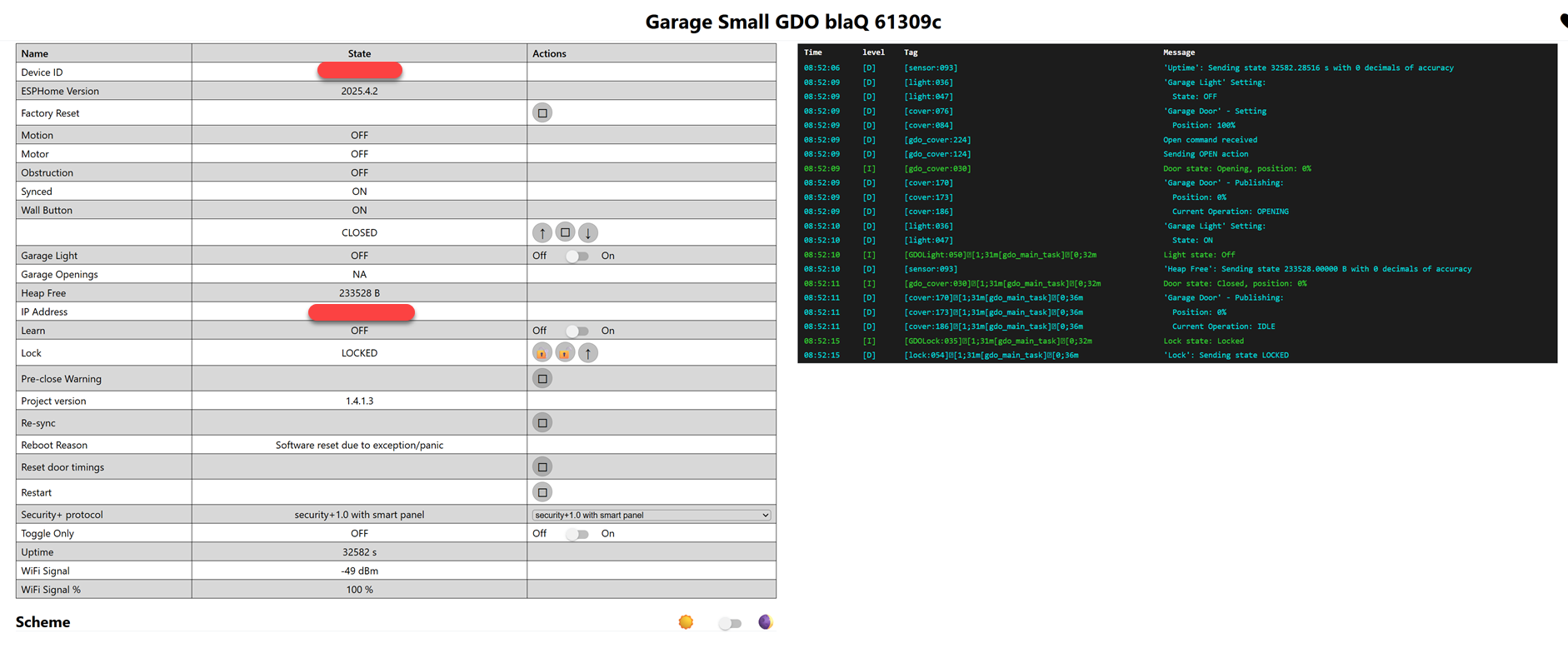

However, when I start from an UNLOCKED status and attempt to open the garage door from Sharptools I am getting this. So the door is not opening and is getting set to LOCKED.

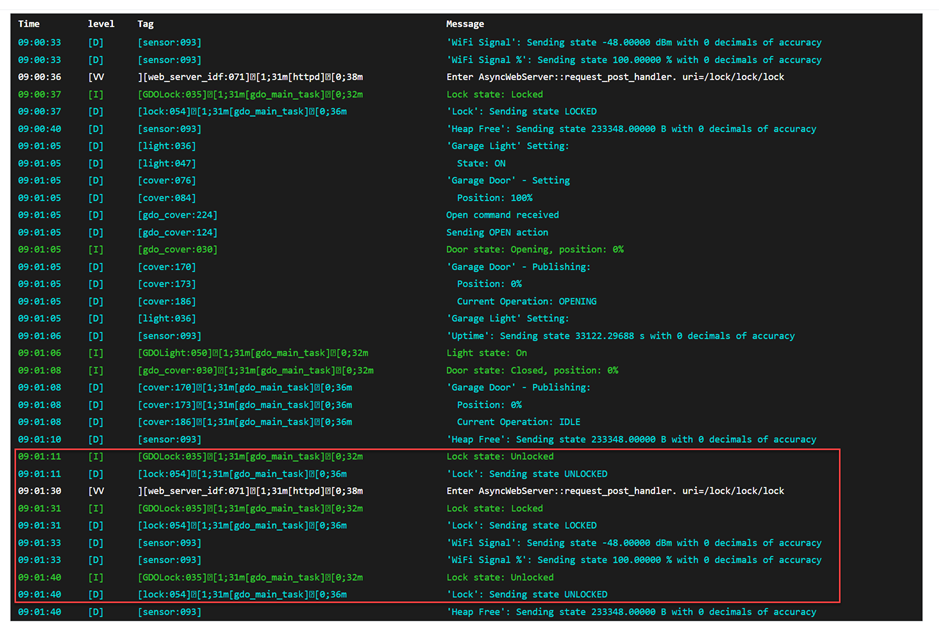

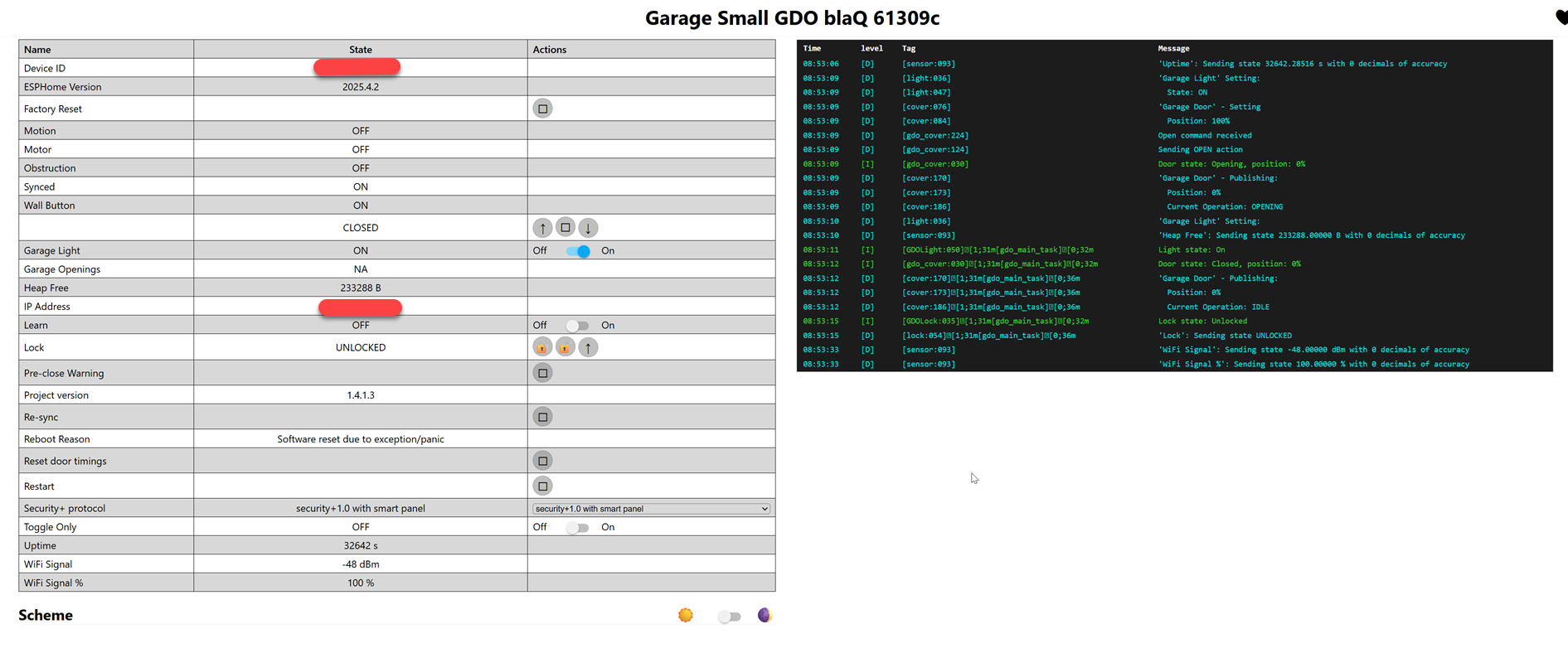

Interestingly when I run the same test starting from a LOCKED status the door is not opening but is then getting set to an UNLOCKED status.

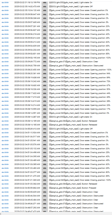

On one occasion I did also see this weird behaviour when initiating from Sharptools and a starting status of LOCKED.
