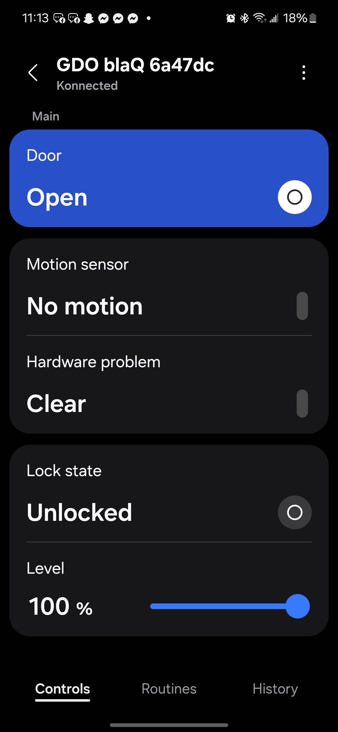

Anyway, SmartThings just had an update and now the Konnected Blaq Controller for it no longer has these features: Signal Strength, Dimmer (aka the garage door opening percentage), or the Contact Sensor. Not only this we can not use these features for routines anymore. We still have the motion sensor, light, lock state, and basic opening and closing functions and can still use them in routines, but we post many of the major funtions. With the state the controller is in now we basically just have a standard controlls that we have in myQ within SmartThings without the advanced features of the ratgdo. Below is a screenshot of what we have now. Can this be fixed back to what it was?
@MPHDodgeDaytona The problem you’re having is most likely related to this update. You beat me by a few minutes before posting new update/announcement!
The refreshed capabilities should populate in SmartThings soon. It seems there is a bit of a delay on refreshing the device profiles and I’m not sure exactly how it works on their back-end. You can try to force it to refresh by going to Settings > Linked Services in the SmartThings app and then tap on Konnected.
Keep an eye on it today and let me know when/if it updates like my screenshot posted above.

Thanks for the update I was able to refresh my linked account via SmartThings and that allowed the new capabilities to become populated. The only one that isn’t working right now is the “Hardware problem”. It’s blank for me and I’m not home right now to test it out by blocking the sensor eyes to see if that fixes it. I will test that when I get home and let you know, but as of right now everything else works fine and looks just like you have above.
@MPHDodgeDaytona great to hear!
The new Hardware problem capability probably just needs a state update to populate for the first time. The next time something crosses the beam or the next time the blaQ reboots it should be all fixed up.
Hi nate,
Just wanted to let you know that the Hardware problem is working now. I’m not home yet, but the Blaq must of rebooted like you said and everything is up and running like it should. Thanks for the update, looks good and should be less confusing for my family members with the new changes.
