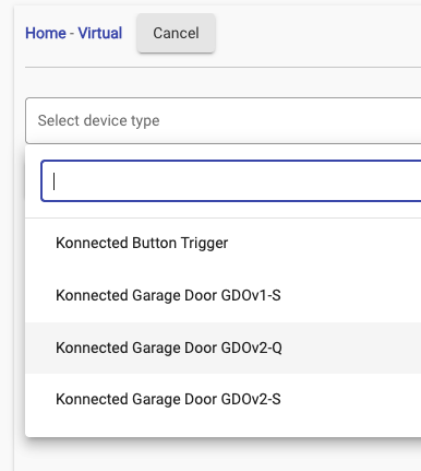

I then attempted to create a virtual driver as per the following webpage but there was no Konnected Garage Door GDOv2-Q Type in the drop-down list. It appears that the Hubitat interface has change a little since you created this documentation but it still should have shown up in the dropdown. Your guidance appreciated.
Scroll all the way to the bottom of the Select Device Type drop-down and it should be there under the subheading User.
If you still can’t find it, click on Drivers Code in the Hubitat menu sidebar and make sure that the Konnected Garage Door GDOv2-Q is listed there and installed properly.
