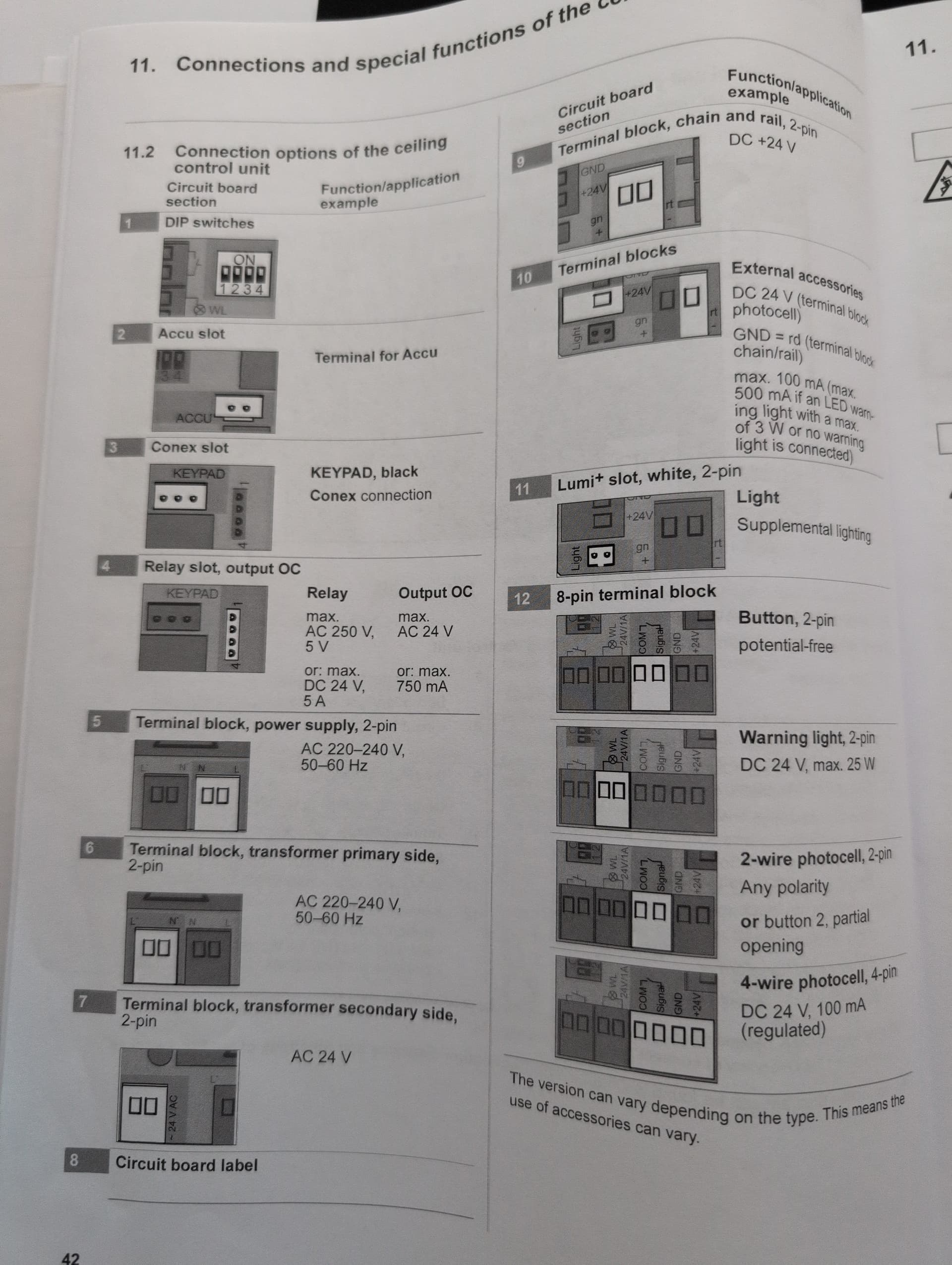

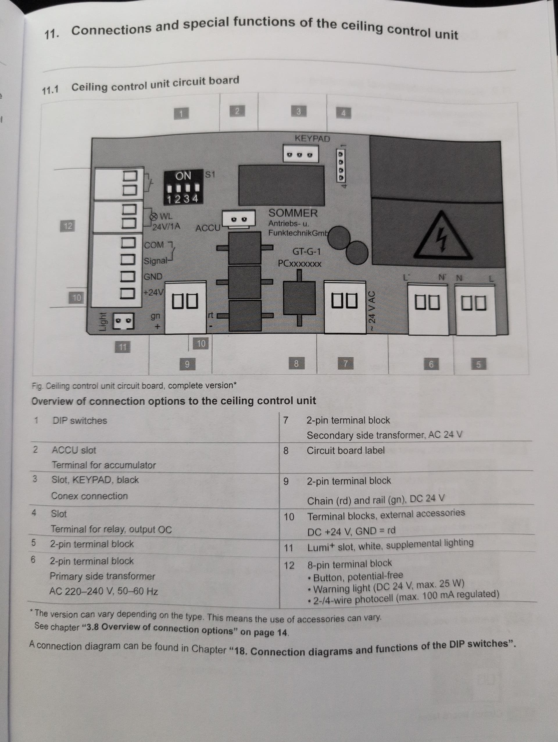

Has anyone used the door open on this brand / model please? I believe I’ll need the GDO White, but it’s not immediately clear to me which contacts on the door opener I need to work with, despite having the installation manual. I don’t have a wall switch installed, just a remote.
It looks like you would hook up the DOOR terminals on the GDO White to the Button terminals on the 8-pin terminal block (section 12 in that diagram).

Confirming that this has worked.
