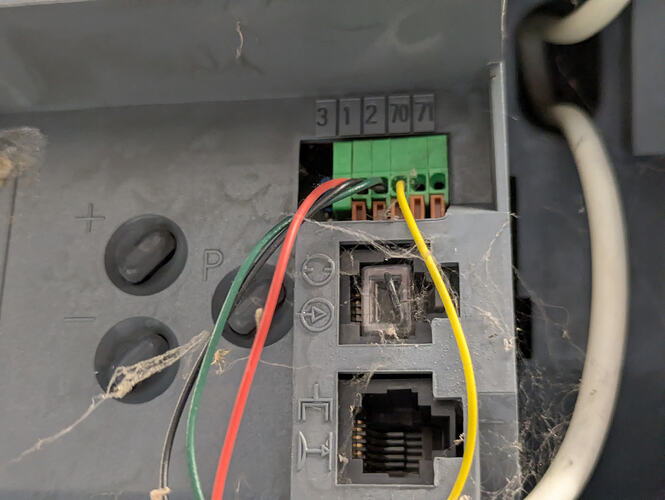

Post a photo of the controller terminals if you can and I will take a closer look.

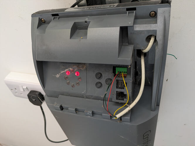

Pics below.
Thanks again - your help is appreciated. :+1:
Close up pic
I see. Yes, you can wire the DOOR terminals from the Konnected GDO White to terminals 1 and 2 on the Marantec. This will enable the GDO White to trigger the door.
You can test this by shorting terminals 1 and 2 on the Marantec box with a small piece of wire or a metal paperclip. If the door moves when the terminals are connected via wire, it works!
However, this doesn’t give it feedback if the door is open or closed or not. For that, you can either use the built-in optical laser sensor on the GDO White if it’s mounted correctly, or use an external sensor wired to the INPUT terminals on the GDO White.
