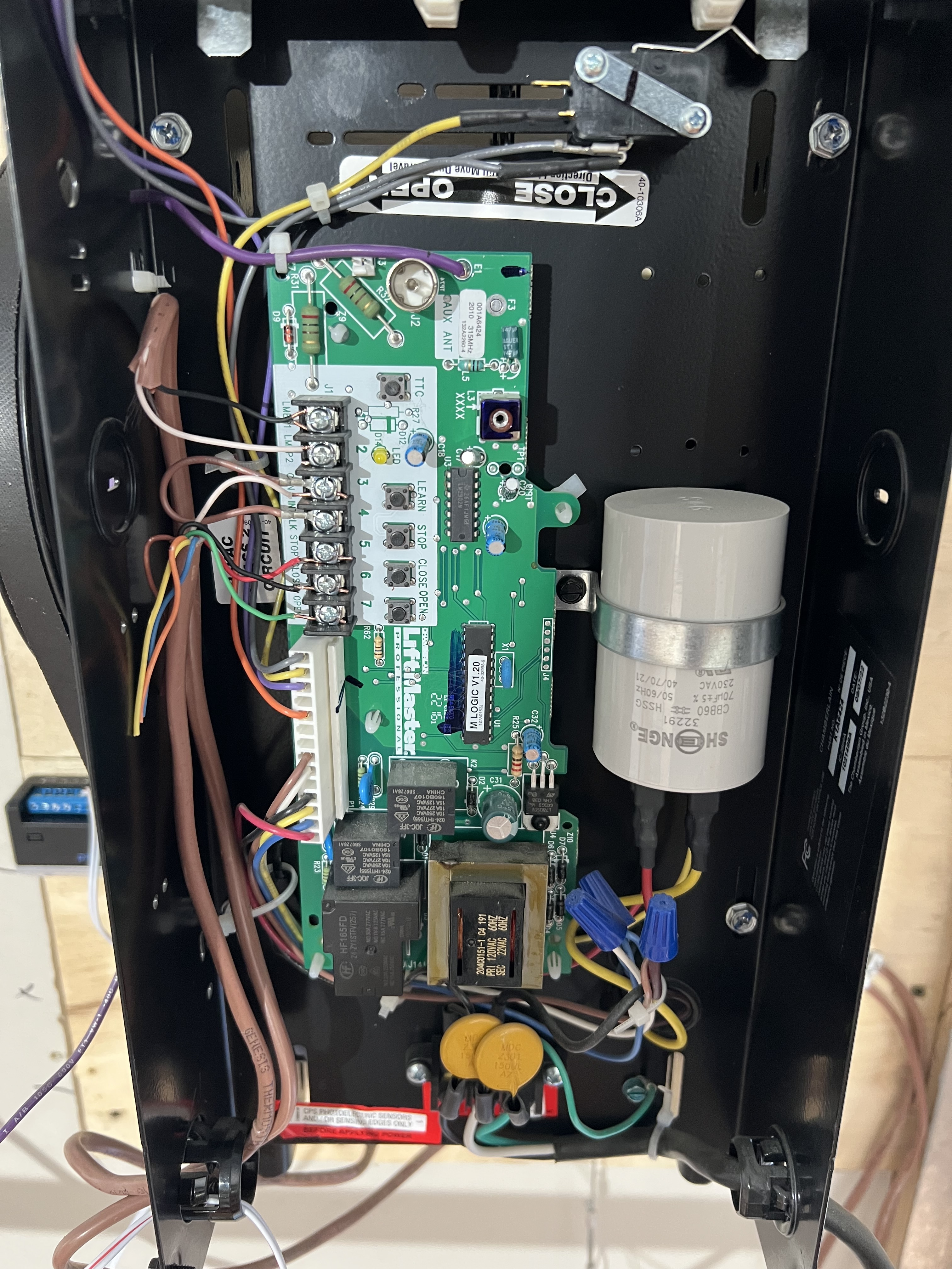

I have a Liftmaster MJ5011U medium duty logic that I world like to use the Konnected Blaq with. I can’t seem to figure out the wiring. It seems that for my opener to work at all it must have the wired 3 button (Open/Close/Stop) station switch installed. If this switch is not installed the opener won’t work at all with a wireless remote. I tried to connect the blaq to the “open” and “close” terminals on the GDO board but then nothing works.
I tried to install it on the pass-thru method as well but like I said If all wires are not connected to start/stop/close/common wires, nothing functions.

Unfortunately I don’t think it will work on this device yet. We haven’t tested or developed a way to interact with these commercial grade LiftMasters, which use a different wireline protocol from the residential garage openers. The blaQ works with openers that use a wired serial protocol to a smart wall button, indicated by a yellow, red or purple learn button – which I don’t think this one has.

One thing I’ve observed about these commercial openers is that they all appear to have dry-contact inputs for open/close/stop triggers. So, that would imply that it should be pretty easy to automate with relays… but this is not how the blaQ works.
The blaQ works by emulating one of the Chamberlain/LiftMaster digital wall buttons, which aren’t compatible with the commercial grade openers.
It’s unknown to me at this time if the commercial devices use a similar digital wireline protocol as the residential openers. Maybe they do, but the commands are slightly different. If that’s the case, it may be possible for the blaQ to communicate with it, once we are able to reverse engineer the data protocol.
