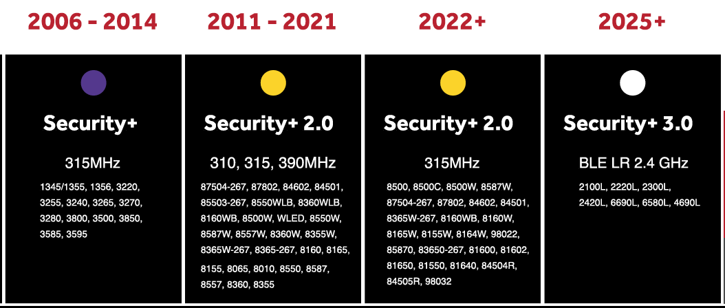

The information is out there, you just have to look for it. For LiftMaster brands, the most concise info on model numbers can be found on that comparison chart that I posted above:
LiftMaster are generally only available through garage door installers and professionals, and Chamberlain are the consumer brand available in retail stores like Home Depot, Lowes and Amazon.

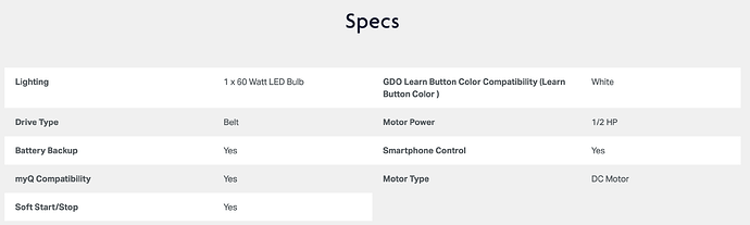

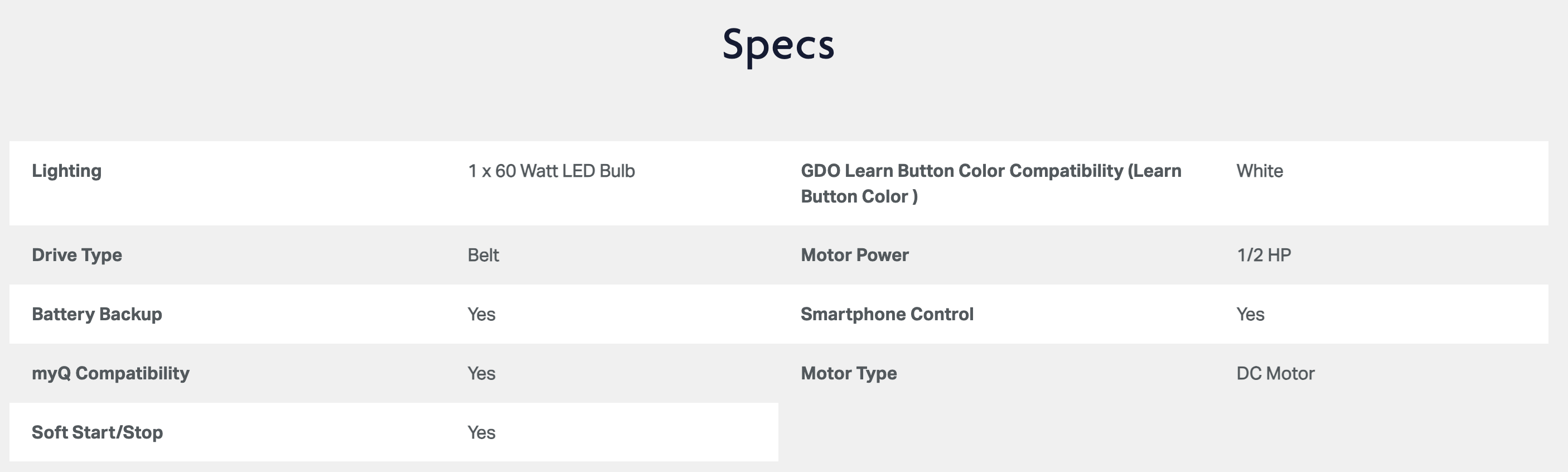

For Chamberlain brand, the details are on the Chamberlain website, just click on the Specs tab and there it shows the Security+ version and the learn button color.
Yellow (round) learn button means Security+2.0 and is what you should be looking for for the best compatibility with the GDO blaQ. The newer Security+3.0 have a white (round) learn button.
I recently brought b3010 garage door opener from hope depot.It had a white round button. Does this mean it’s using security 3.0? Is this supported through Smart Garage Door Opener White (v2)?
Yes that sounds like a Security+3.0 new model. Unfortunately no 3rd party controllers will work with these. This is an intentional move by Chamberlain/LM to lock you in to myQ.

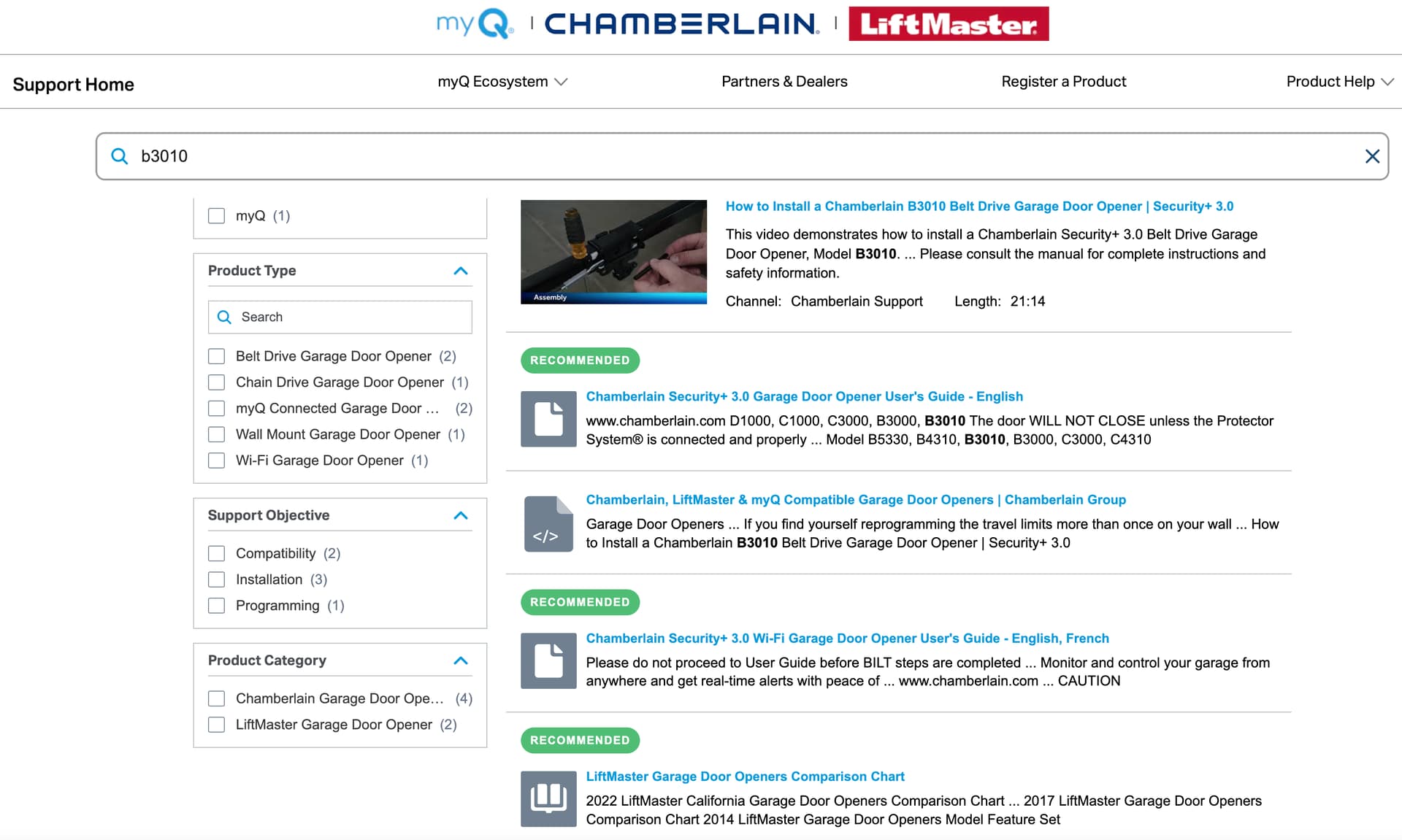

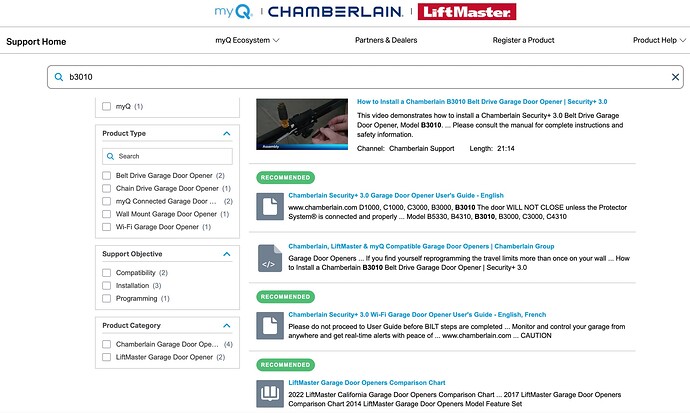

Looks like they’re completely hiding it as much as possible now. They know EXACTLY what they’re doing and why. This is straight from their website, and other than knowing about what kind of accessories would be supported otherwise, there’s no clue until you go to their support site and search for the model number, where you’ll start actually seeing signs, even the Home Depot page is devoid of any mention of Secuirty+ 3.0….
The company continues to be one of the scummiest companies around, who just happen to otherwise have the best garage door openers.
