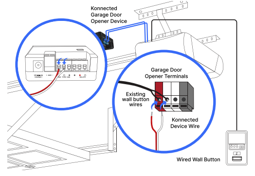

This indicates that the GDO blaQ is not communicating/syncing to the garage opener motor. This is separate and unrelated from the Hubitat connection. Is your GDO blaQ wired up properly?
All three are wired like below . . .
Nothing had been changed from the original installation.
Since you noted a potential connectivity issue, I reseated the wires.
This is what the activity is reporting now . . .
