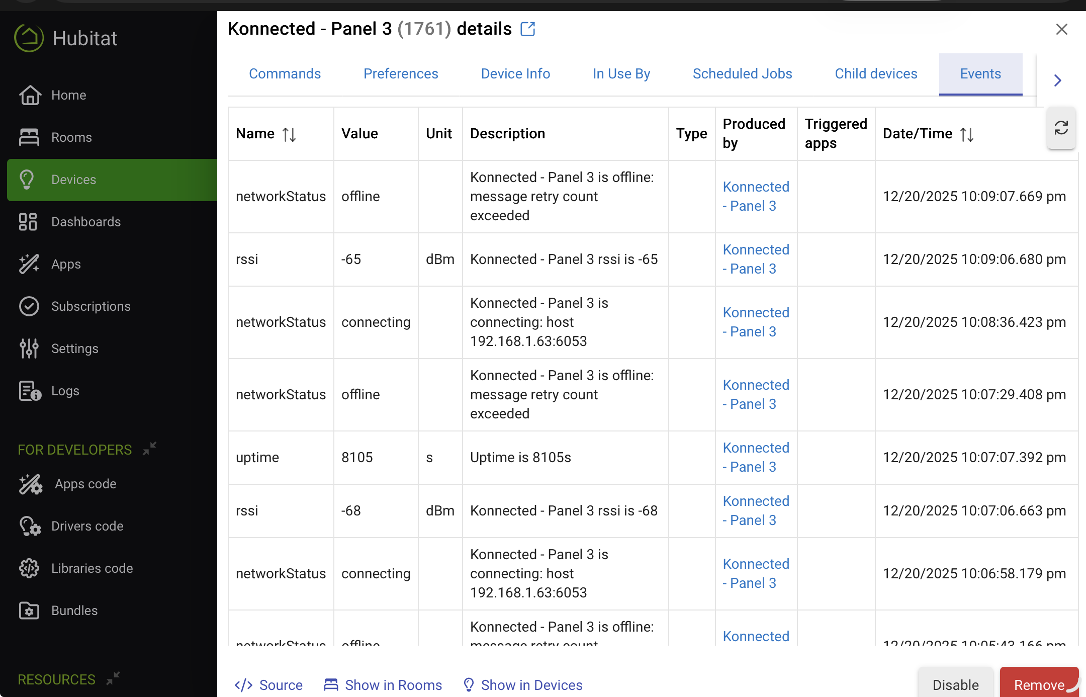

I have a Konnected system (5 modules), and recently they have started not reporting status and also the blue light is blinking like they have lost Wi-Fi. They are integrated with a Hubitat C8. In Hubitat, these entries keep repeating:
the modules are available on the network, but this is what I see in their logs:
