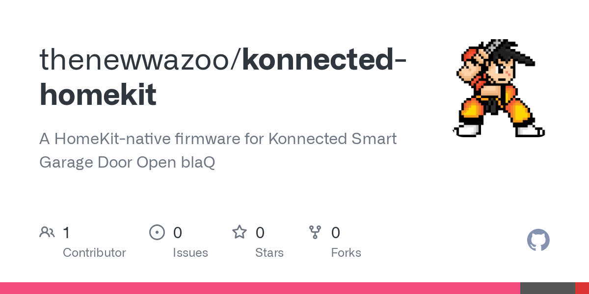

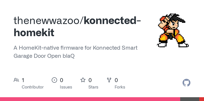

There’s also this new attempt at a native homekit firmware for the GDO blaQ, developed by a community developer named Brandon:
Right now, very experimental, but I would love to get a few people trying it
