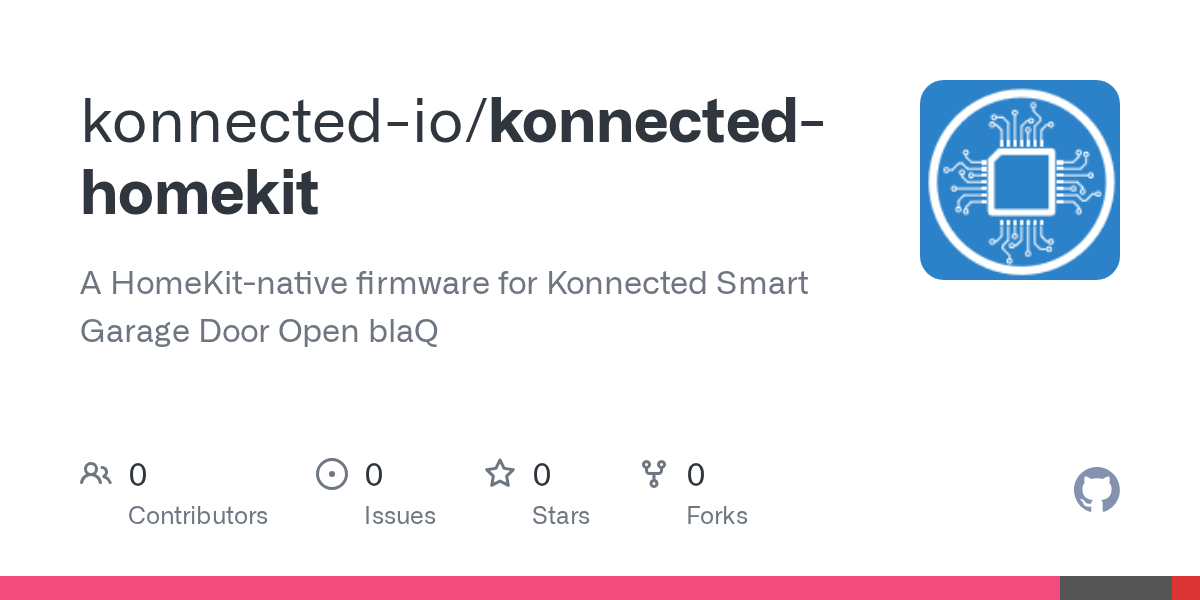

We have adapted a Homekit specific firmware, adapted from RATGDO (actually originally authored by the same developer who maintains the RATGDO Homekit firmware)
Here’s the GitHub repo:
Still under development and not thoroughly tested yet, but it should work. To use this, you will have to re-flash the device. Download the linked ZIP file, expand it to get the flashable bin file, and flash this to address 0x0 on your GDO blaQ. You can use esptool command line or via web at ESP Tool
Eventually we will add this to our web-based installer at https://install.konnected.io.
Here’s the latest firmware build (ZIP download):
https://github.com/konnected-io/konnected-homekit/actions/runs/20399807725/artifacts/4933829670
