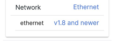

Found this on Gemini. It answers my questions.
No, you cannot update a non-Pro Konnected Alarm Panel (6-zone) to Ethernet or v1.8 firmware.
The non-Pro board and the Alarm Panel Pro are entirely different physical hardware platforms:
  • Hardware Limitations: The non-Pro Konnected board relies on an ESP8266 microcontroller chip, which only supports 2.4 GHz Wi-Fi. It completely lacks the physical RJ45 Ethernet port, PHY transceiver chip (such as the RTL8201 introduced on the Pro v1.8), and Power-over-Ethernet circuitry present on the Pro boards.
  • Firmware Compatibility: The v1.8 firmware build is created explicitly for the Alarm Panel Pro board hardware. Attempting to flash Pro v1.8 firmware onto a non-Pro board will result in a flash error or render the non-Pro board unbootable, as the ESP8266 cannot run ESP32/Ethernet-specific binaries.

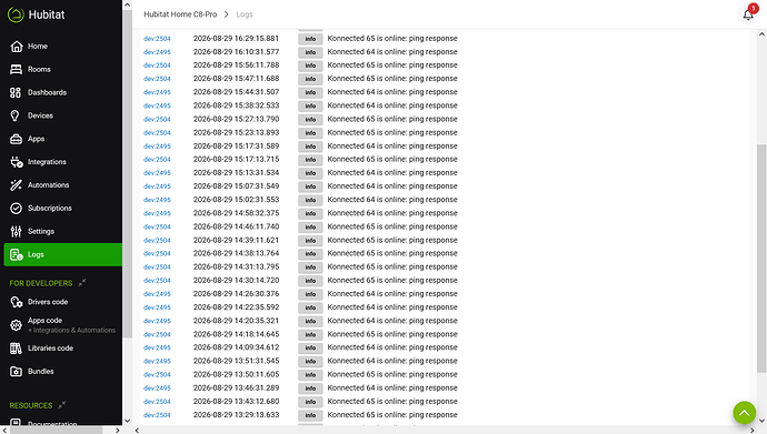

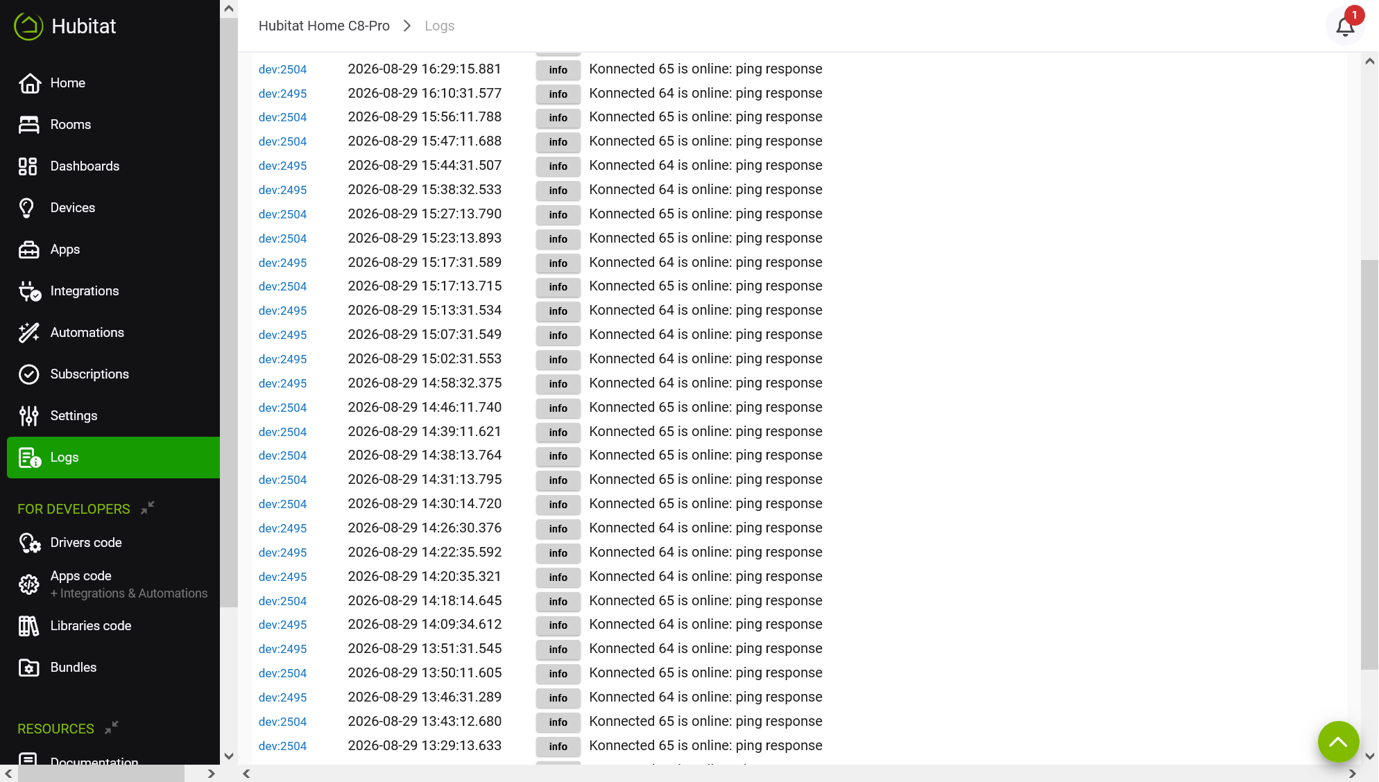

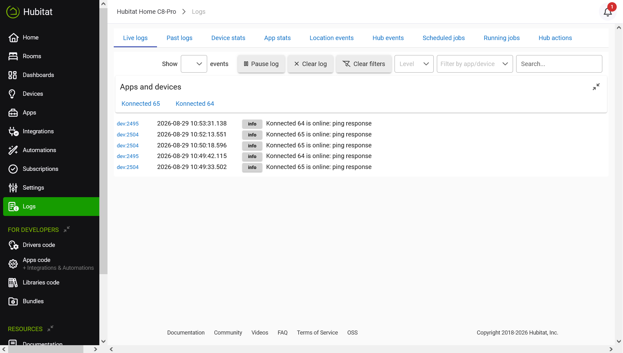

The impetus for trying to update my Alarm Panel board was to be able to change it’s logging status in Hubitat from full to error. My Hubitat logs are full of useless ESPHome log entries.
Any suggestions on how to stop these logs would be welcome. I am getting the following in my Hubitat log many times a day. Multiple attempts (>10) to change the logging with the Konnected app, updating firmware, results in unresponsive boards that require flashing again. Because of the location of the boards, I have to disconnect them from my system and bring them to my desktop to do the USB flashing, again…..
Do I need to toss out both of my non-pro boards and upgrade to the Pro in order to get the hubitat log spamming under control? The boards work fine. But the logging has exploded recently. I have read and read and read on firmware updates and device settings in Hubitat and I continue to get tons of logs like the above and even more PING entries for both boards. I have attempted every firmware/ESPHome update that I can find. I am getting very frustrated with all of this. Hubitat device info for both boards below.
WOW! 60 views……………….

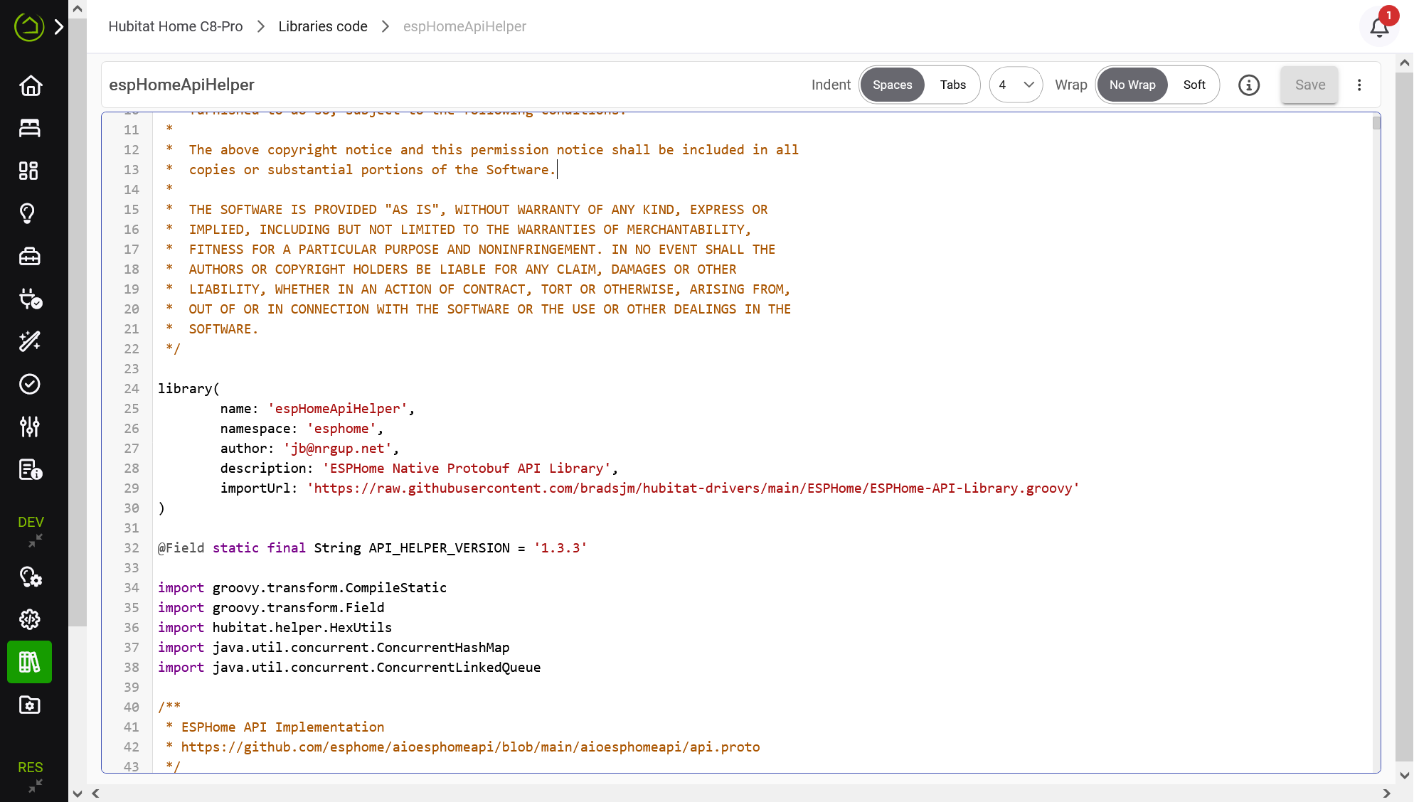

Those logs in Hubitat are not coming from the Konnected panel. They’re coming from the ESPHomeApiHelper library. The library was updated about a month ago to quiet down the noisy communication logging that was added by an open-source contributor.
Make sure you’ve updated the library in your Hubitat instance, and that debug logging toggle is off.
Also see:
Nate, thanks for helping me here. I have updated the ESPHome/ESPHome-API-Library.groovy and I have turned off the debug logging for both of my 6-zone boards. Also, I used the app to update my firmware on both boards (I THINK it worked) and set the Logging to Warn for both. Will that take care of the pings and the ESPHome log entries?
Still getting lots of ping log entries. Is this correct?
Nate, I don’t know what else to do. I did as you suggested above. Actually, I had already tried that. And yet, here are my most recent logs….
This is NOT fixed or I am missing something…

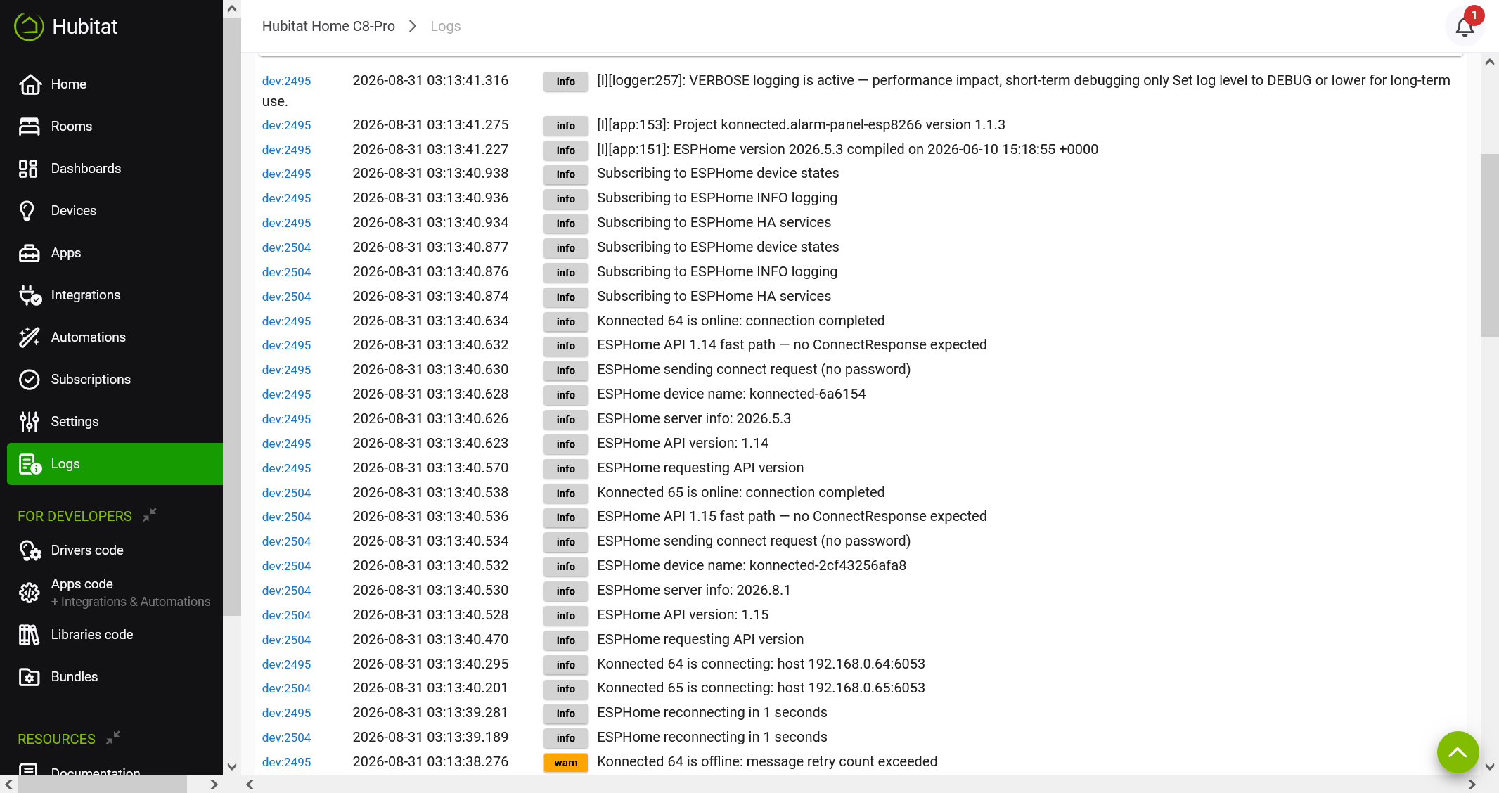

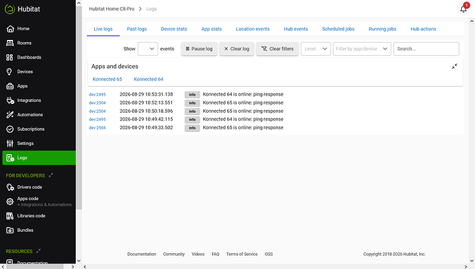

Ok, I deleted the Alarm Panel driver and ESPHome/ESPHome-API-Library.groovy and re-installed them from the site above. I have turned off all of the log switches on both cards. And I am still getting a flood of logs.
That “INFO Konnected XX is online: ping response” line should only show once after the device comes online after being offline. Which makes it seem like your device is constantly going offline and then online again. That’s why you would be seeing it repeatedly

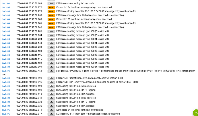

I would suggest turning on debug logging temporarily to help figure out why it’s going offline so frequently. That’s not normal.

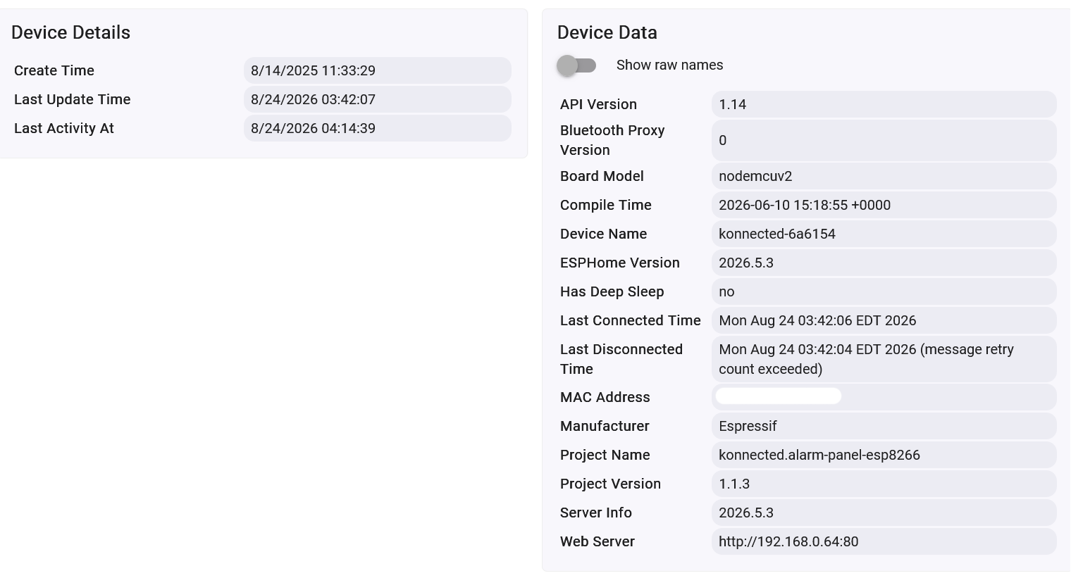

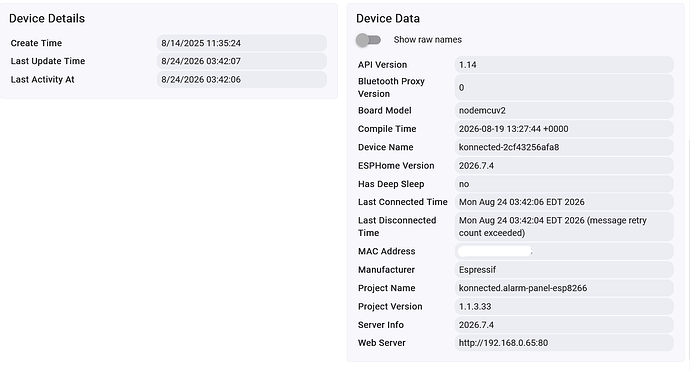

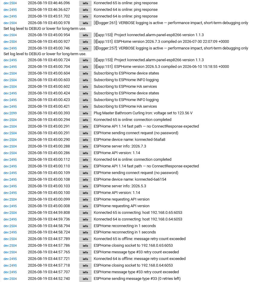

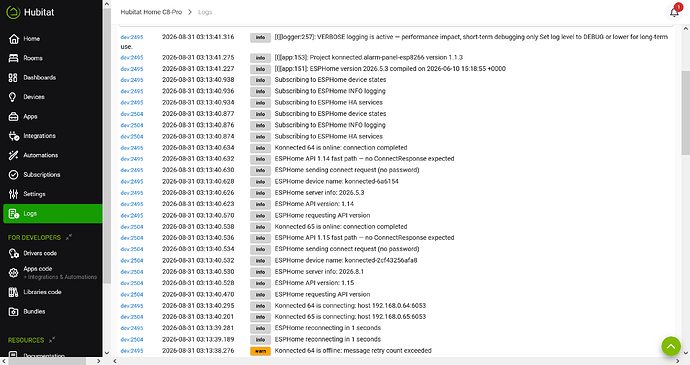

Could it have something to do with a weak wifi signal? WiFi Signal RSSI -67 -70 both boards.
Definitely could be. Please share some logs with the debug toggle enabled and that might give us more clues.

Konnected 64 is online: ping response
dev:25042026-08-29 19:10:20.103info
Subscribing to ESPHome device states
dev:25042026-08-29 19:10:20.101info
Subscribing to ESPHome INFO logging
dev:25042026-08-29 19:10:20.099info
Subscribing to ESPHome HA services
dev:25042026-08-29 19:10:19.799info
Konnected 65 is online: connection completed
dev:25042026-08-29 19:10:19.797info
ESPHome API 1.15 fast path — no ConnectResponse expected
dev:25042026-08-29 19:10:19.795info
ESPHome sending connect request (no password)
dev:25042026-08-29 19:10:19.793info
ESPHome device name: konnected-2cf43256afa8
dev:25042026-08-29 19:10:19.791info
ESPHome server info: 2026.8.1
dev:25042026-08-29 19:10:19.789info
ESPHome API version: 1.15
dev:25042026-08-29 19:10:19.588info
ESPHome requesting API version
dev:25042026-08-29 19:10:19.307info
Konnected 65 is connecting: host 192.168.0.65:6053
dev:24952026-08-29 19:07:52.271info

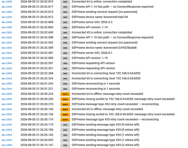

@37kdeep thanks for the log details. This was helpful.
There was a bug in the Alarm Panel driver that was causing this. Fixed now in release 2026.8.1 which you can download/install from there or get from HPM.
After tracing this, I don’t think it was actually your device disconnecting, there was a bug that was causing the connection status to not track properly.
Awesome that you found it. I will install the new driver and get back to you. Thank you very much!
Here is the Hubitat log for the last 6-8 hours after I updated to release 2026.8.1
So I turned on logging for both boards for a short period of time. Is all of this normal?

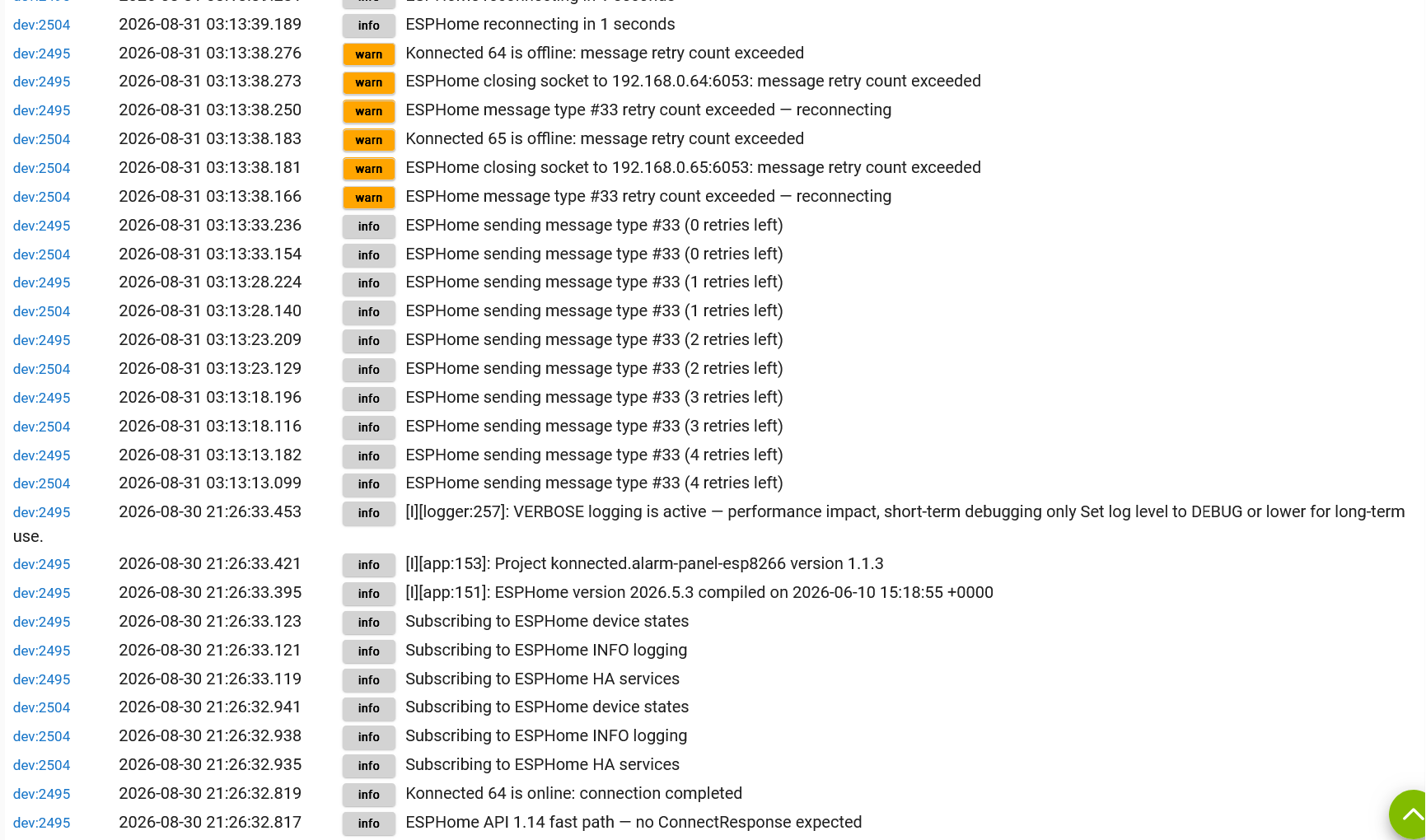

dev:25042026-08-31 19:59:18.179
debug
ESPHome scheduling healthCheck in 37s
dev:25042026-08-31 19:59:18.176
debug
ESPHome send msg type #8 with [:]
dev:24952026-08-31 19:59:03.301
debug
ESPHome scheduling healthCheck in 54s
dev:24952026-08-31 19:59:03.299
debug
ESPHome received: [type:state, platform:sensor, key:1324261225, state:246422.984375, hasState:true]
dev:24952026-08-31 19:59:02.581
debug
ESPHome scheduling healthCheck in 48s
dev:24952026-08-31 19:59:02.579
debug
ESPHome received: [type:state, platform:sensor, key:2654868797, state:-60, hasState:true]
dev:24952026-08-31 19:59:02.552
debug
ESPHome scheduling healthCheck in 38s
dev:24952026-08-31 19:59:02.550
debug
ESPHome received: [type:state, platform:sensor, key:513204495, state:80, hasState:true]
dev:25042026-08-31 19:58:43.802
debug
ESPHome scheduling healthCheck in 40s
dev:25042026-08-31 19:58:43.800
debug
ESPHome received: [type:state, platform:sensor, key:2654868797, state:-71, hasState:true]
dev:25042026-08-31 19:58:43.768
debug
ESPHome scheduling healthCheck in 42s
dev:25042026-08-31 19:58:43.766
debug
ESPHome received: [type:state, platform:sensor, key:513204495, state:58, hasState:true]
dev:25042026-08-31 19:58:42.903
debug
ESPHome scheduling healthCheck in 49s
dev:25042026-08-31 19:58:42.866
debug
ESPHome received: [type:state, platform:sensor, key:1324261225, state:215943.546875, hasState:true]
dev:24952026-08-31 19:58:37.158
debug
ESPHome scheduling healthCheck in 35s
dev:24952026-08-31 19:58:37.156
debug
dev:25042026-08-31 19:58:18.105
debug
ESPHome scheduling healthCheck in 44s
dev:25042026-08-31 19:58:18.076
debug
dev:24952026-08-31 19:58:03.352
debug
ESPHome scheduling healthCheck in 43s
dev:24952026-08-31 19:58:03.350
debug
ESPHome received: [type:state, platform:sensor, key:1324261225, state:246362.984375, hasState:true]
dev:24952026-08-31 19:58:02.627
debug
ESPHome scheduling healthCheck in 45s
dev:24952026-08-31 19:58:02.625
debug
dev:24952026-08-31 19:58:02.602
debug
ESPHome scheduling healthCheck in 36s
dev:24952026-08-31 19:58:02.600
debug
dev:25042026-08-31 19:57:43.690
debug
dev:25042026-08-31 19:57:43.688
debug
dev:25042026-08-31 19:57:43.670
debug
ESPHome scheduling healthCheck in 52s
dev:25042026-08-31 19:57:43.668
debug
dev:25042026-08-31 19:57:42.769
debug
dev:25042026-08-31 19:57:42.767
debug
ESPHome received: [type:state, platform:sensor, key:1324261225, state:215883.546875, hasState:true]
dev:24952026-08-31 19:57:37.059
debug
ESPHome scheduling healthCheck in 46s
dev:24952026-08-31 19:57:37.057
debug
dev:25042026-08-31 19:57:17.975
debug
ESPHome scheduling healthCheck in 59s
dev:25042026-08-31 19:57:17.973
debug
dev:25042026-08-31 19:57:05.794
debug
ESPHome scheduling healthCheck in 56s
dev:25042026-08-31 19:57:05.786
debug
ESPHome received: [type:state, platform:binary, isDigital:false, key:2131827574, state:false, hasState:true]
dev:25042026-08-31 19:57:03.994
debug
dev:25042026-08-31 19:57:03.984
debug
ESPHome received: [type:state, platform:binary, isDigital:false, key:2131827574, state:true, hasState:true]
dev:24952026-08-31 19:57:03.384
debug
ESPHome scheduling healthCheck in 53s
dev:24952026-08-31 19:57:03.382
debug
ESPHome received: [type:state, platform:sensor, key:1324261225, state:246302.984375, hasState:true]
dev:24952026-08-31 19:57:02.667
debug
ESPHome scheduling healthCheck in 33s
dev:24952026-08-31 19:57:02.665
debug
dev:24952026-08-31 19:57:02.635
debug
dev:24952026-08-31 19:57:02.633
debug
dev:25042026-08-31 19:56:43.715
debug
ESPHome scheduling healthCheck in 47s
dev:25042026-08-31 19:56:43.713
debug
dev:25042026-08-31 19:56:43.690
debug
dev:25042026-08-31 19:56:43.688
debug
dev:25042026-08-31 19:56:42.789
debug
dev:25042026-08-31 19:56:42.787
debug
ESPHome received: [type:state, platform:sensor, key:1324261225, state:215823.546875, hasState:true]
dev:24952026-08-31 19:56:36.929
debug
dev:24952026-08-31 19:56:36.927
debug
dev:25042026-08-31 19:56:17.809
debug
dev:25042026-08-31 19:56:17.807
debug
dev:24952026-08-31 19:56:03.370
debug
ESPHome scheduling healthCheck in 55s
dev:24952026-08-31 19:56:03.368
debug
ESPHome received: [type:state, platform:sensor, key:1324261225, state:246242.984375, hasState:true]
dev:24952026-08-31 19:56:02.649
debug
dev:24952026-08-31 19:56:02.647
debug
dev:24952026-08-31 19:56:02.620
debug
dev:24952026-08-31 19:56:02.618
debug
dev:25042026-08-31 19:55:43.733
debug
ESPHome scheduling healthCheck in 39s
dev:25042026-08-31 19:55:43.729
debug
dev:25042026-08-31 19:55:43.679
debug
dev:25042026-08-31 19:55:43.677
debug
dev:25042026-08-31 19:55:42.778
debug
ESPHome scheduling healthCheck in 57s
dev:25042026-08-31 19:55:42.776
debug
ESPHome received: [type:state, platform:sensor, key:1324261225, state:215763.546875, hasState:true]
dev:24952026-08-31 19:55:36.775
debug
ESPHome scheduling healthCheck in 31s
dev:24952026-08-31 19:55:36.772
debug
