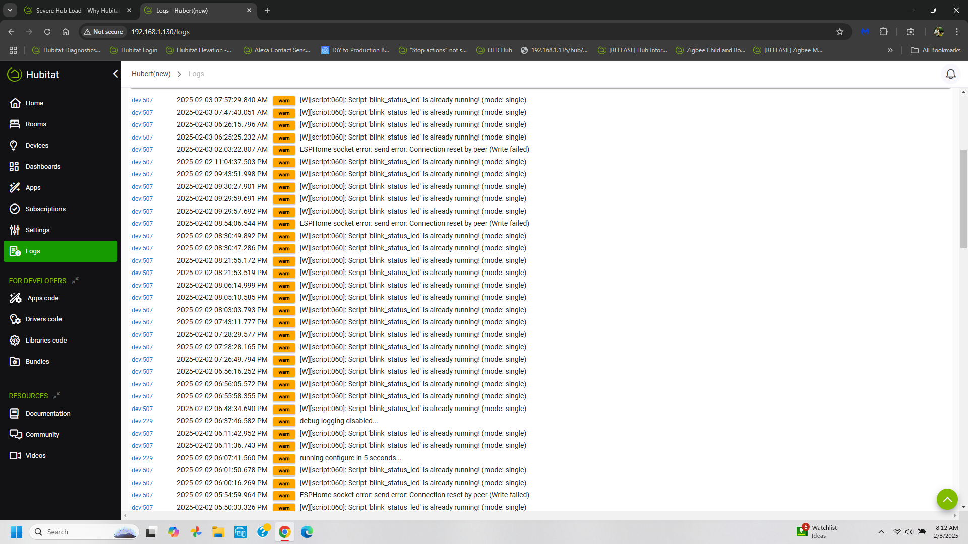

My change from the legacy went well for my pro board except for a couple things dealing with short outputs for controlling relays. I have resolved those and have it working just like before however the logs have these warnings.
