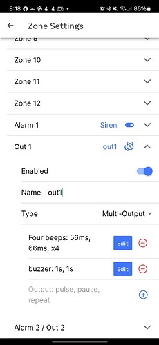

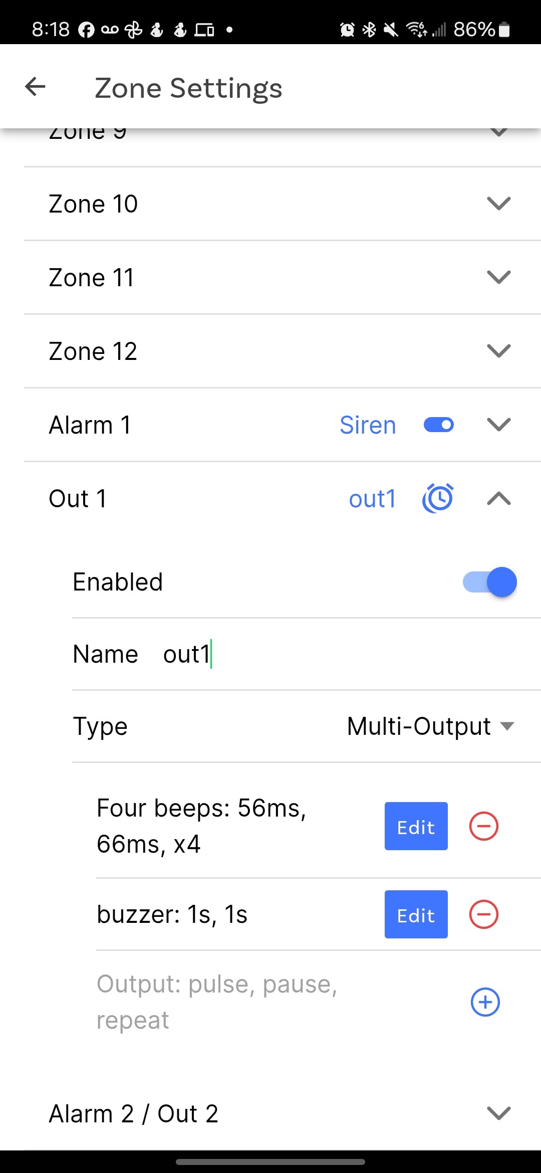

Would be nice to have multiple “channels” for the piezo out on the add-on panel. I.e on the 6 channel add-on board have more than 1 out, say 3, with unique parameters (beep duration and pause) for each. Today it is listed as “out” and you get only one. For example: set Piezo Out 1 as a single beep, channel 2 Out as a triple chirp and piezo 3 Out as a repeating multi-beep with delay. With this it could be used for various alert types. I use routines on my ST hub to create a repeating triple beep when my water sensors trigger. I use the same piezo triple beep without my repeat routine when my doors open. Would love to have other options like single beep and a built in repeat option (while command is on). Seems this could be done entirely with software and no change to the hardware!
This can be done with our new firmware platform (based on ESPHome) by choosing the Multi-output zone type. When you select Multi-output, you can then configure any number of output patterns, just like you described.

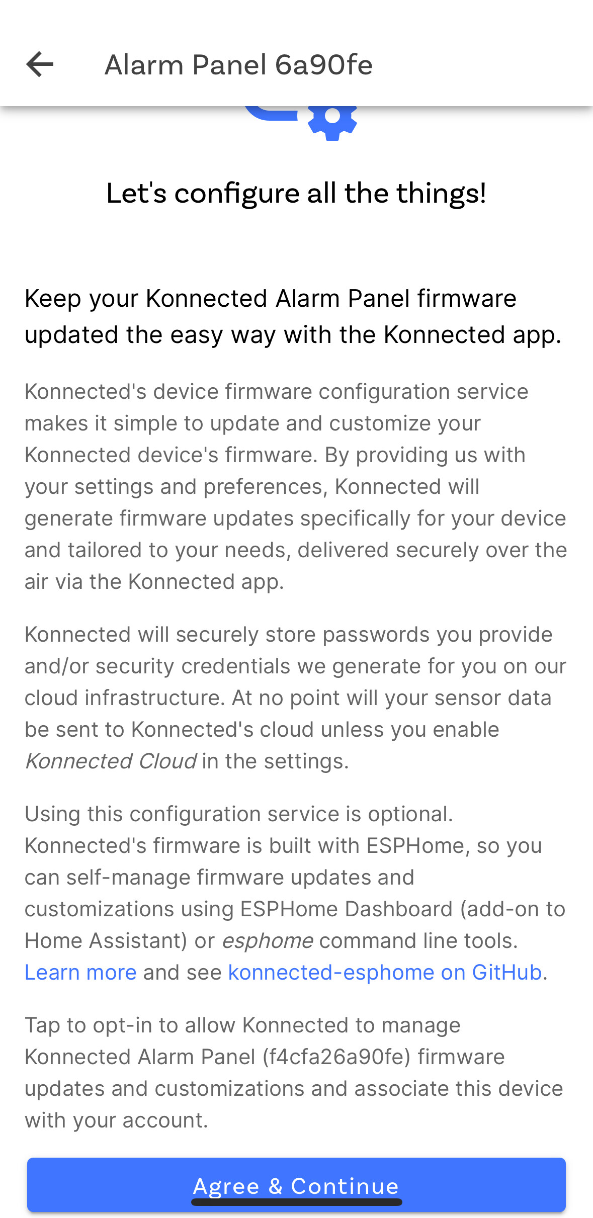

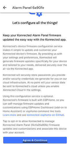

Gotcha. So then I think my problem is in the Konnected app. Nothing happens on any of my 3 panels when I press “Agree and Continue” on the “Let’s configure all the things!” screen.
Try de-registering and then re-register the device.
Thanks Nate, de-registering did the trick.
