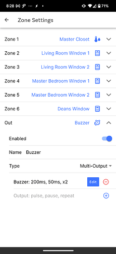

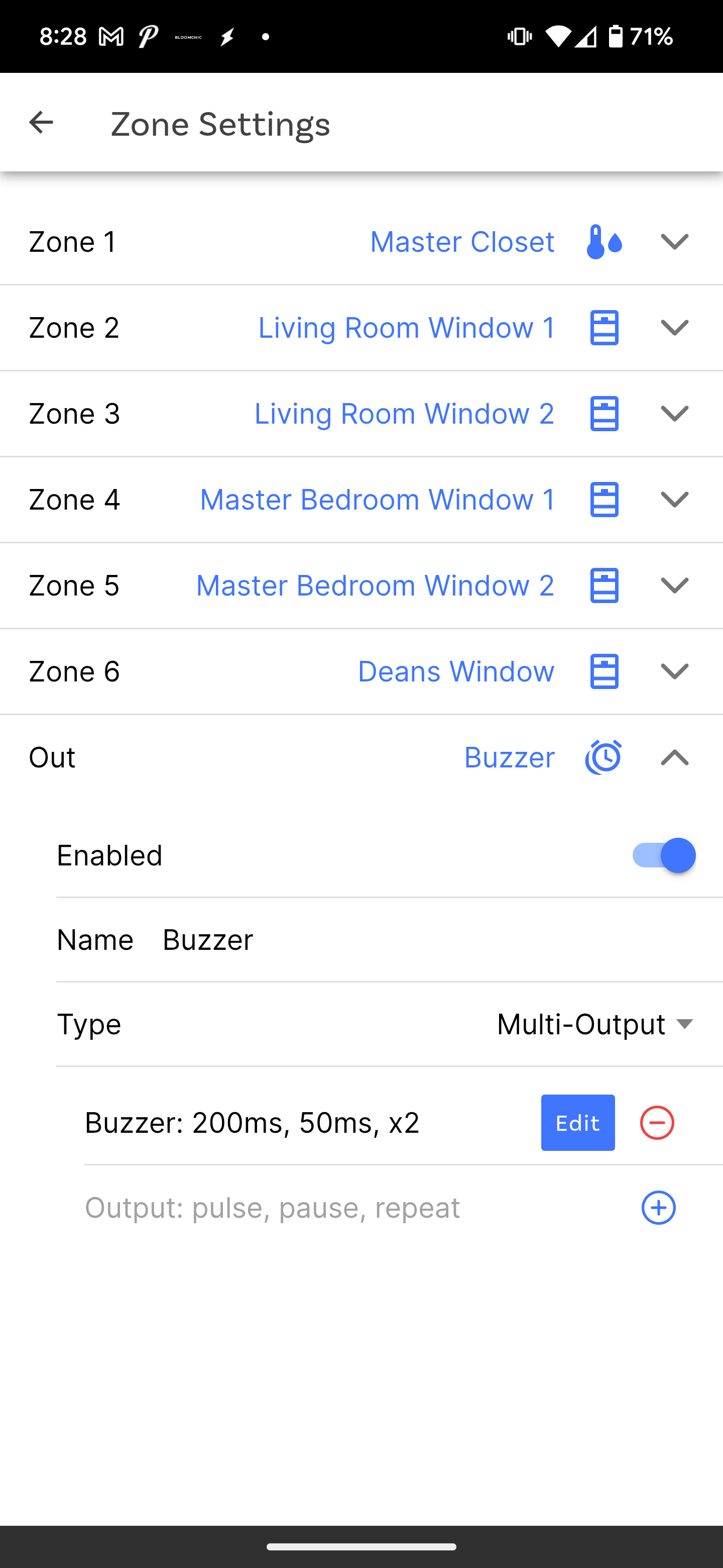

Hi Nate, I am running the ESPHome code on an older 6-zone board. It is working fine but i could not find where to setup the zones (i ended up doing it directly in Hubitat and HA, yep that worked too) but i could not figure out how to setup the piezo buzzer. You mentionned the “App”. The Konnected App or the hubitat/ha app. If it is the Konnected app, i dont see where to set it up. Can you help?
With esp home the easiest is to use the app to edit the zones. You’ll need to setup the buzzer’s zone (I used the out zone on my board) as a multi-output and setup the output (see pic below) than you’ll save and upload the new firmware to the device
I found out why i was not able to access the zone settings in the app. I had to de-register my board from the Konnected Cloud in order to use it in ESPHome. Only then, i was able to change update the zones and perform the update to the FW.

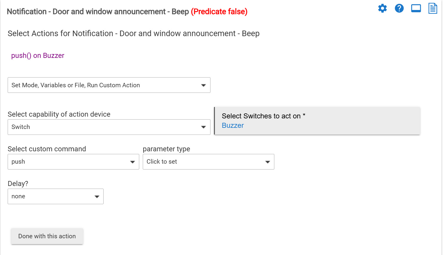

@scubamikejax904 I’m having this same issue. I pasted the 4 capabilities into the Button Trigger Driver as you mentioned and the device is visible in Rule Machine, but it still does not trigger. I tried using “Beep:” like I had on the older device, but it doesn’t trigger “out1”. I know “out1” works if I manually press “Push” in the device details. It seems Hubitat really wants it to be a Push Button, but the device is not shown under buttons. Any ideas?
you will need to run a custom action select the device and than use the push (see the attached screenshot) my device is named buzzer
That worked! Thanks for the help!

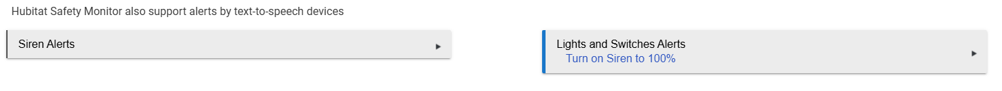

Any advice on switching the siren over? I’ll be working on that next.
For the Siren I had to tinker with. I was a le to found an Esphome switch driver that Mike Maxwell created that I was able to modify to create a siren driver that worked. If you find a better way let me know I’m always open to suggestions.
siren Driver code

I was able to trigger the siren as a switch within HSM just using the default driver.

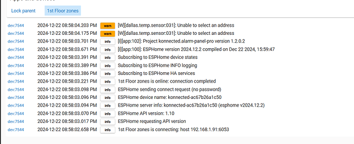

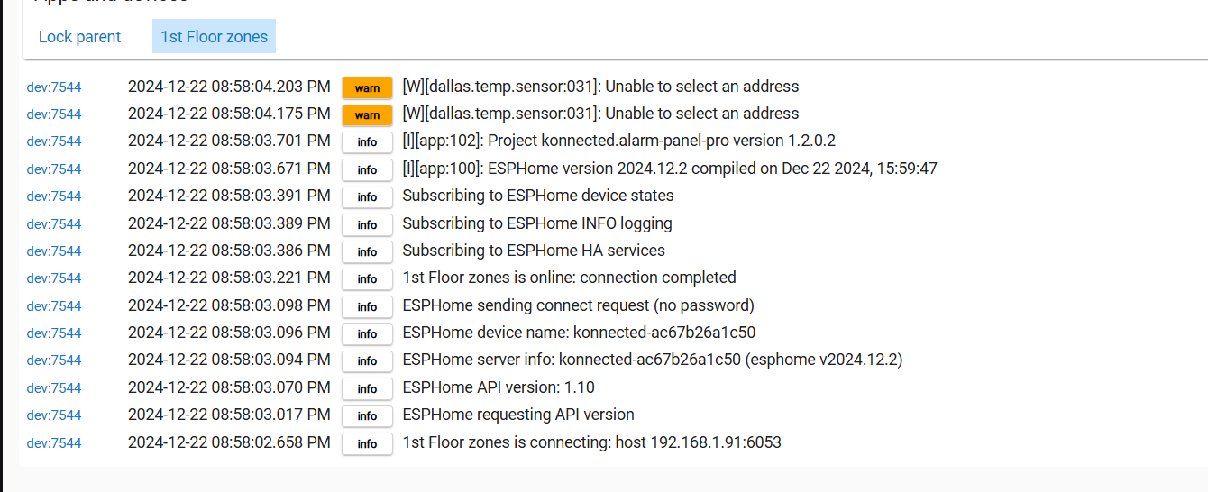

@nate what am i looking for in ref the temp sensors? is there something i need to do in order to get them to get found?
I get this in the logs.
Is there only one per zone allowed on ESP? One one zone has come in and that only has one on. The others have 2 on and are not came in.

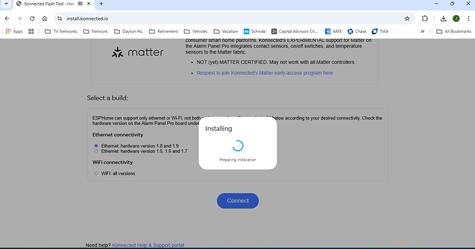

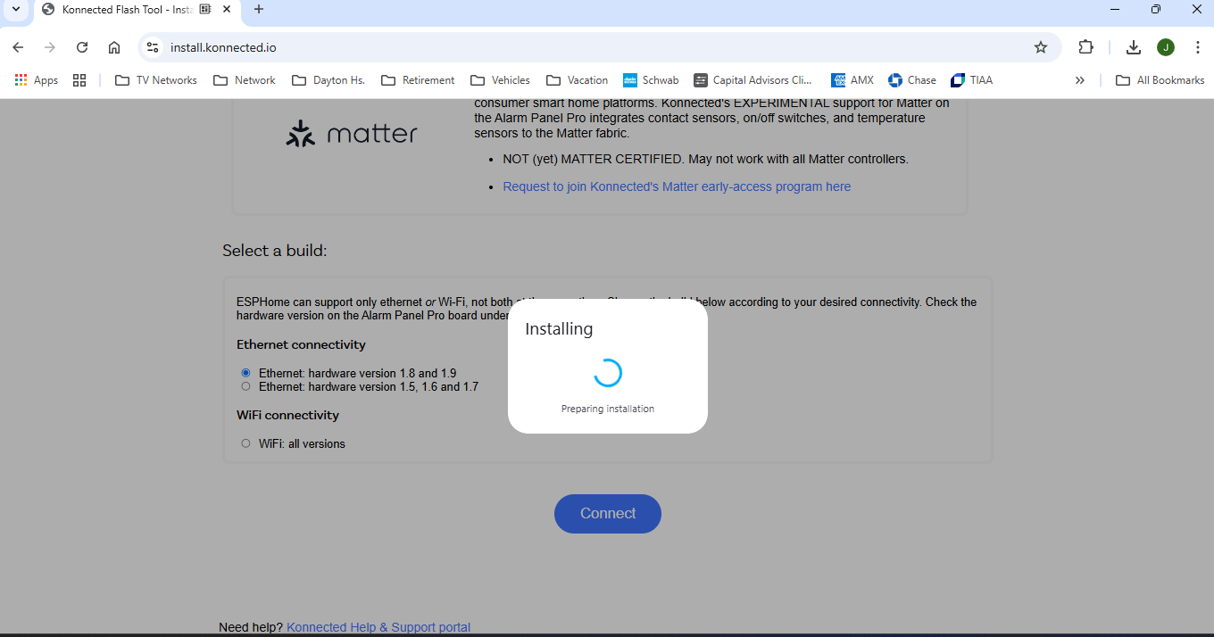

My alarm panel pro failed at step one, hangs for hours at this step and is currently a brick after the failed flash attempt, with no recovery option. Tried to go back to legacy and that wont flash either. I’ve just created a support ticket and would appreciate this getting some attention early next week. - Very frustrated customer.
The whole flashing process should only take ~2 minutes total. If it’s hanging, then there is something wrong with either the device or you may have chosen the wrong port or driver in the web flash tool. Can you send a screenshot of the previous step where you select the port to connect to?
More help and info here: Flashing Konnected Firmware
Thanks for the response, the konnected support team helped me work this out.

Getting the following error on Step #4.
Error Occurred During Installation
An error occurred while installing the package: Failed to install driver “https://raw.githubusercontent.com/konnected-io/konnected-hubitat/master/drivers/konnected-alarm-panel.groovy. Please notify the package developer…”
