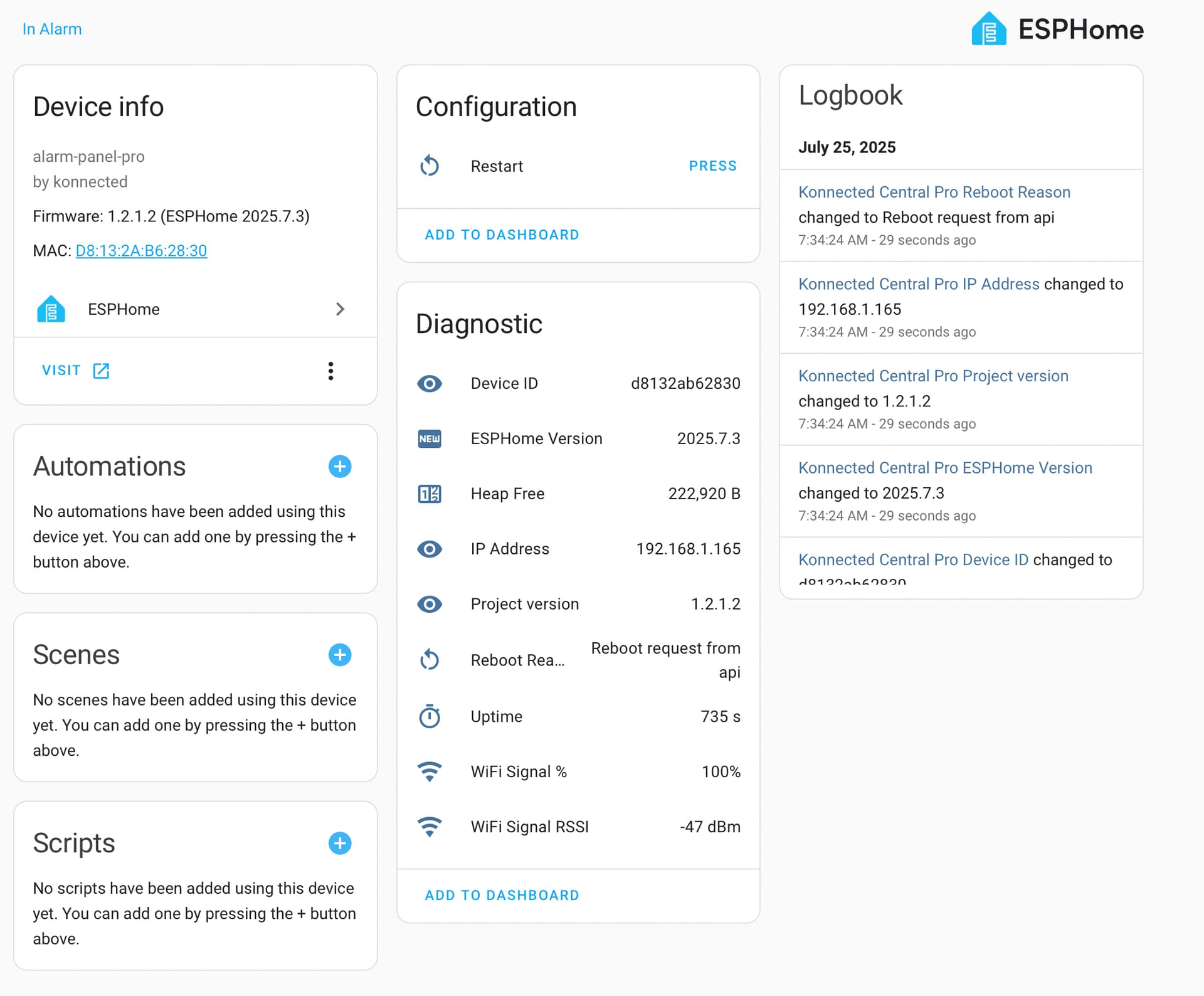

Don't see any zones in Homeassistant for Alarm Panel Pro?
ESPHome discovers the Alarm Panel Pro and can be added no problem, but only 11 entities are created and they all related to the ESPhome, no zones are present. Have flashed it twice and imported it several times. Any tips? I am using the WiFi version with the AlarmPanel Pro.

Thank you, I did not use the Konnected app as the instructions said not to use it at all. I shall give it a try.
Ended up switching back to the legacy firmware and flashed that on and it’s now working again with Home Assistant properly. Will stick with that until I am forced to update all the software. Which hopefully will be never, as long as Home Assistant continues to support the Konnected firmware.
Yeah. There seems to be a problem with the image generated from the Konnected APP and Home Assistant. All the sensors are gone, the only thing that works is to flash the image with USB.
