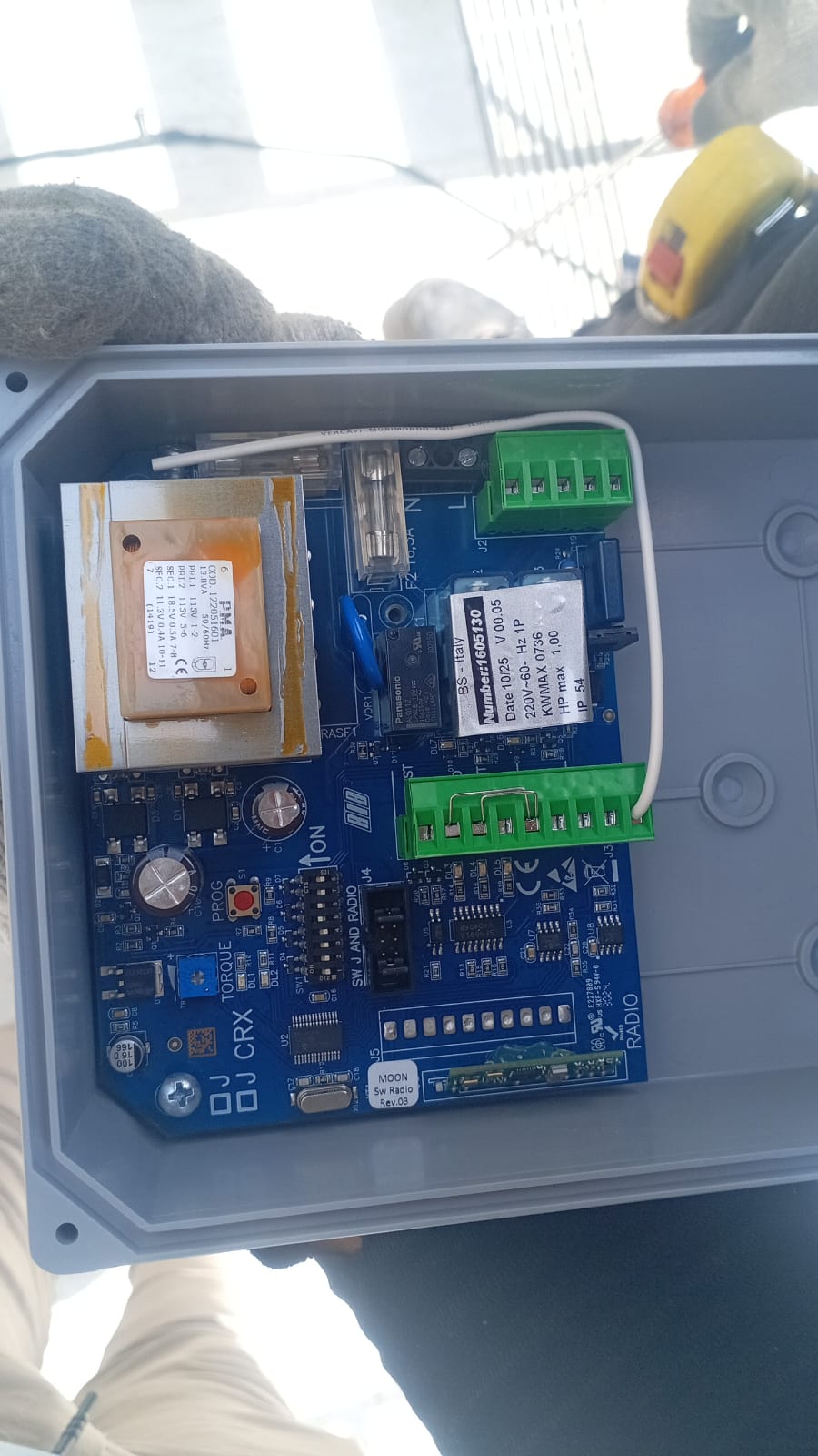

I would like to confirm if the Konnecred GDP Blaq is compatible with my roll-up garage door controller (photo attached).
Controller details from the board (as seen in the attached photo):
  • PCB marking: MOON 5W Radio Rev03
  • Label: J CRX
  • Transformer: PRI 230V – SEC 24V 1A
  • Relay: Finder 65.30 series, 220V~50/60Hz, 10A
  • Green terminal blocks for inputs/outputs (one currently bridged with white wire)
  • DIP switches and torque/force adjustments on board
Could you please confirm:
  1. If the GDP Blaq can be connected as a dry-contact push button to this controller.
  2. Which specific terminals I should connect it to for the Open/Close/Stop function.
The short answer is no, the GDO blaQ is not compatible with this opener.
The blaQ is made specifically for Chamberlain and LiftMaster brand residential garage openers with Security+ or Security+2.0 technology. This is not a Chamberlain or LiftMaster brand.
The GDO White may work, though. The GDO White can be connected as a dry-contact push button. I can’t see the terminal markings well enough in this pic to see which terminals should be used, though.
