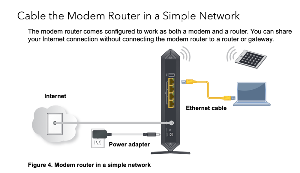

Thanks, Nate. Perhaps you could advise. I have a very simple (out-of-the-box) home network with only a single wifi/router. Here is a diagram of the network;
Netgear documentation states:
Cable Your Modem Router to a Router and Use Bridge Mode
If you want to cable the modem router to a router, then you must log in to the modem and change its Router MOde setting. Changing this setting prevents certain network conflicts that can occur when two devices on the same network perform routing functions such as network address translation (NAT) and DHCP. This setting turns the modem router into a bridged modem.

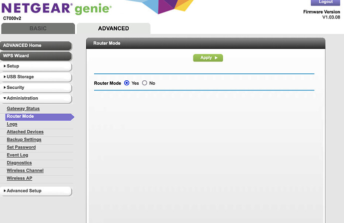

Here is the current setting:
Any thoughts appreciated.
