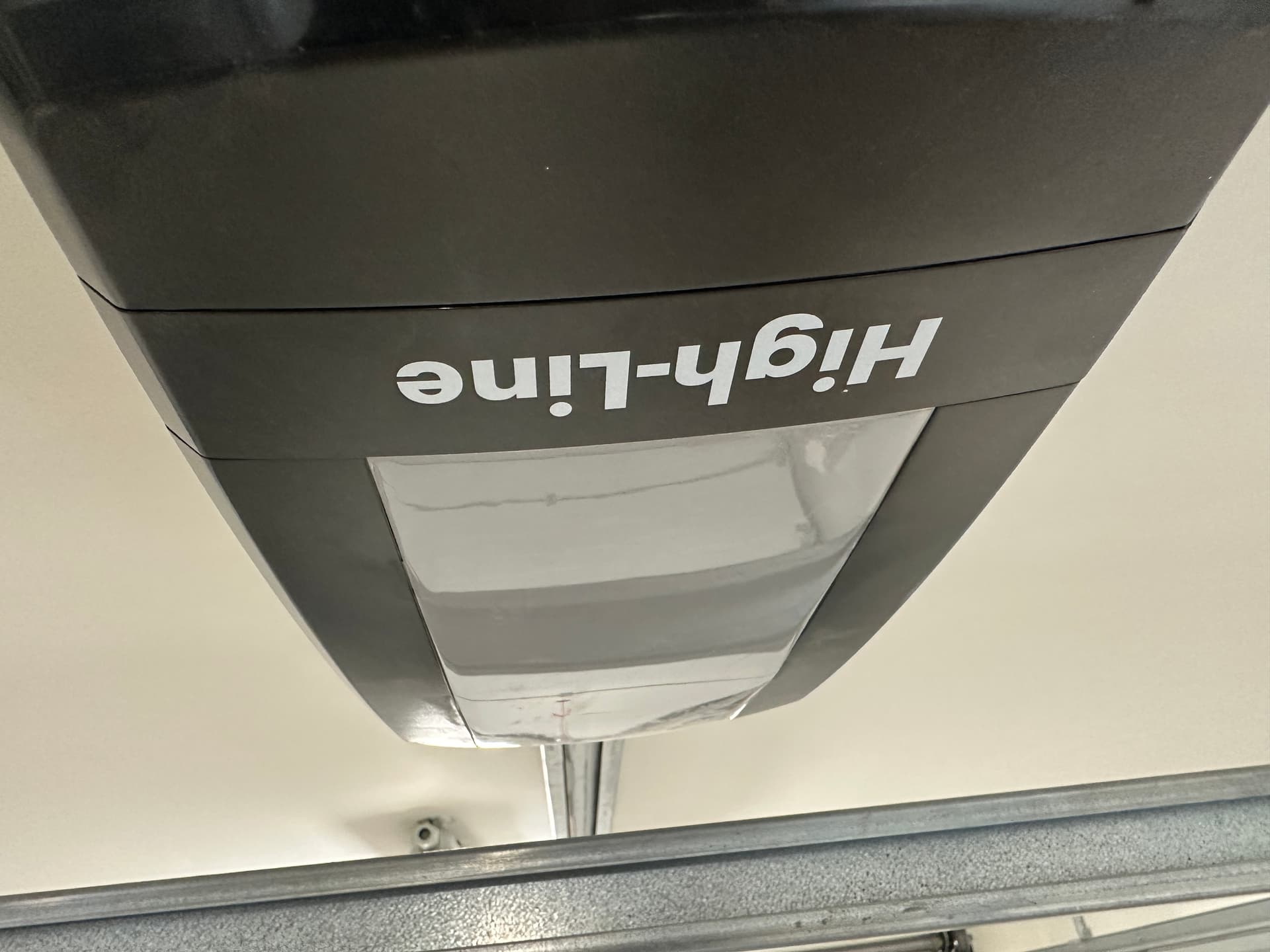

Today I received my BlaQ GDO V2-Q so I can control my Chamberlane Highline 10 ( year 2022) garagedoor opener. (The one with the round yellow button.

If I take a look at my setup;
I have a wireless receiver on the wall (battery powered)
This type is known as a “condoor” High-Line LM switch.
If I take a look at the back of my Garage door opener I notice on the backplate it is engineered by “Chamberlane” but distributed by “Condoor”
Besides this switch I also have 2 wireless keys / receivers.

I have good news. After further investigation on this forum I tried the following procedure.
1: Reset “door timings”
2: Enable “Learn”
3: Open and close the garage door completely by using the wall switch of Chamberlane.
Now it works :slight_smile:
