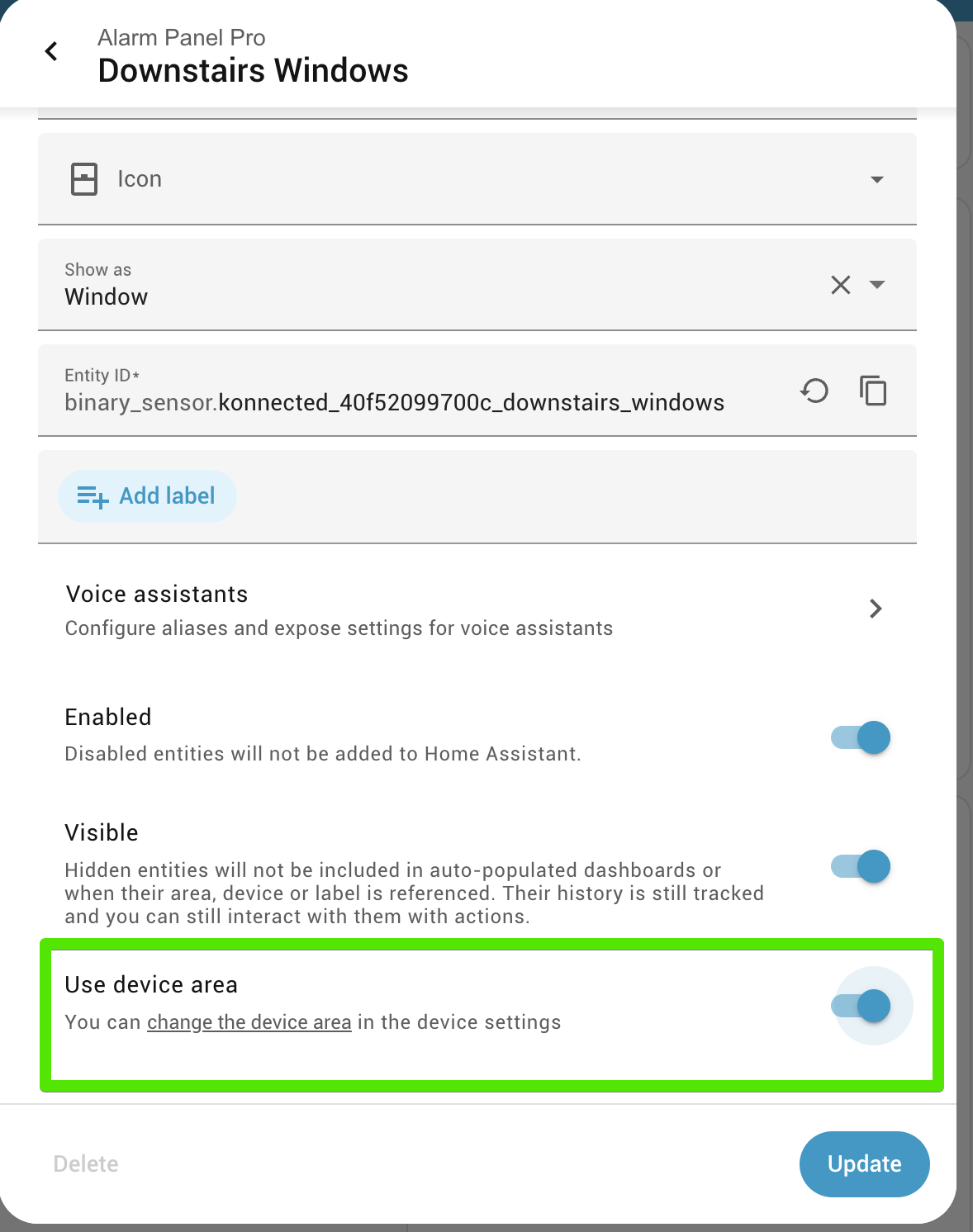

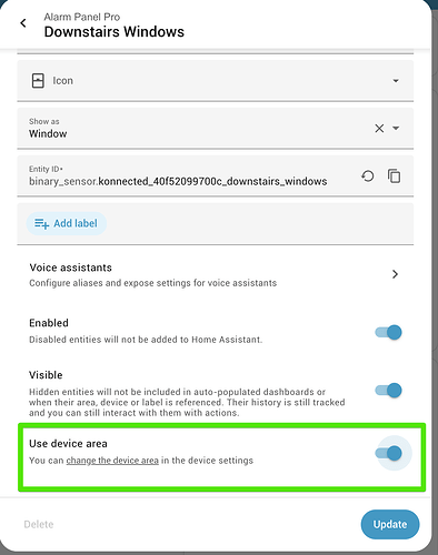

@jasleinstein You can change the Area in Home Assistant for an individual sensor by clicking the Settings (gear icon) on that entity, then un-check the Use Device Area toggle. This will reveal a select box where you can select a different Area for that individual sensor.
Nate, thank you this worked perfectly.
