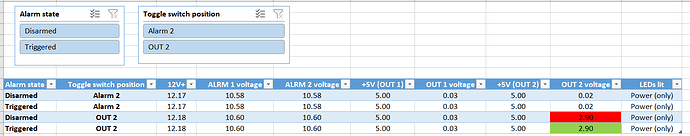

New to Konnected but got the panel setup and integrated with HA. All sensors are operating as expected. However, when I arm it and trigger it, I’m getting unexpected behaviour:
OUT 1 voltage never changes. OUT 2 voltage is always ~3v regardless of triggered/untriggered state. Also, neither Alarm 1 or Alarm 2 LEDs will illuminate (despite HA showing the state as triggered).
I’m confused
None of the outputs will automatically change state based on Triggered/Untriggered state.
You need to configure the outputs to trigger either via automations in Home Assistant or using the Standalone Alarm System feature in the Konnected app, under Alarm Response.
