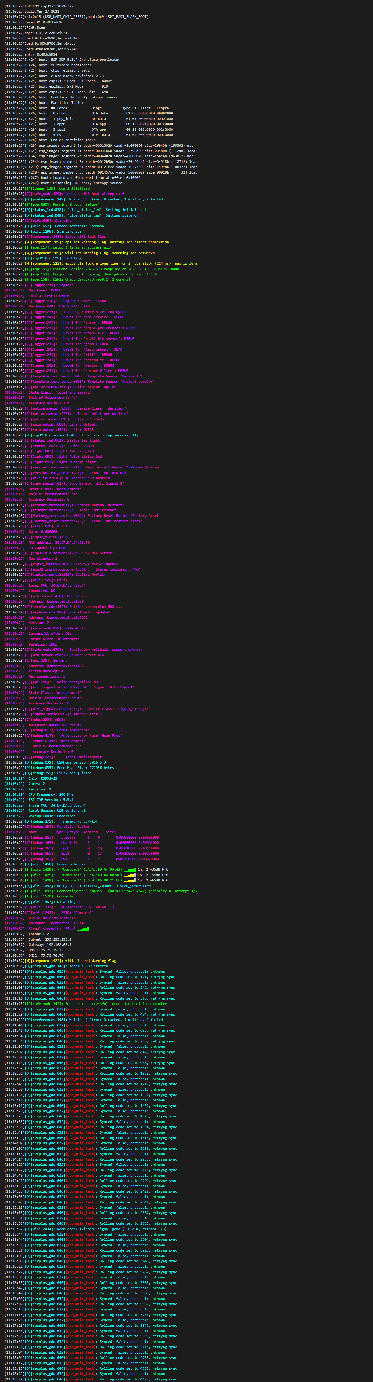

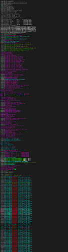

12.) Here it the log file that has been created
The last error just continues to scroll in the Log file… changing the “rolling code set” number.
So, how to I go about getting this device to actually connect to my network ? I have a 172.16.0.0 network.

The log shows that it’s connecting to a network called Compusol at 192.168.68.113. Do you own that network?
Yes, that is correct…but I finally figured it out. I have 3 Deco network extenders. For some reason they reset to be DHCP servers. This allowed the gdo blaq to connect to them getting the 192 ip range. Once I set them back to access points the gdo connected to the correct ip range.
