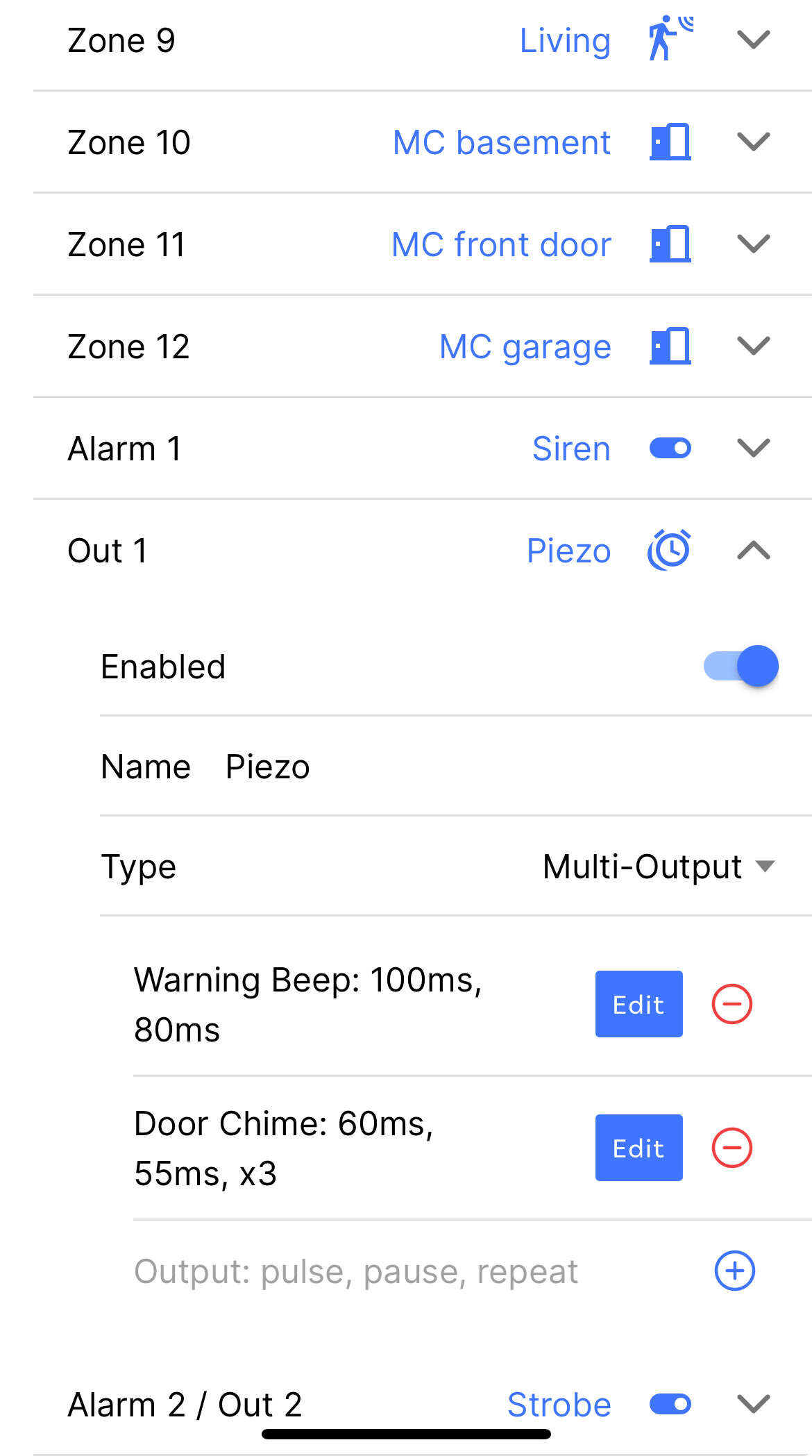

  1. I set up the Alarm Panel Pro board as a stand alone alarm - works very well - wish I had it turned on a few weeks ago :frowning:
  2. Configured Out1 as a “multi output” with different on/off patterns as suggested in the app (“door chime” and “warning beep”). See below
  3. Checked the “door chime” boxes for the door-type zones - works fine
But I cannot find where to configure so it turns on the “warning beep” pattern during the exit and entry delays, I.e. when the alarm is in the arming or pending state.

Just to summarize, Nate mentioned in Jan 2025 that this “feature” (allowing the app to configure the warning buzzer) would hopefully soon be put into the Konnected app.
So far that hasn’t happened because the latest version of the app (1.6.5) was released on Jan 29, 2025 and it’s not in that release.
A workaround is to install Home Assistant’s Alarmo plug-in as your keypad and configure an Alarmo automation to turn the buzzer on/off. This works well!
On the other hand, it kind of defeats the whole purpose of having a Konnected standalone alarm system when you have created a dependency on Home Assistant for the keypad and to turn the buzzer on/off.
