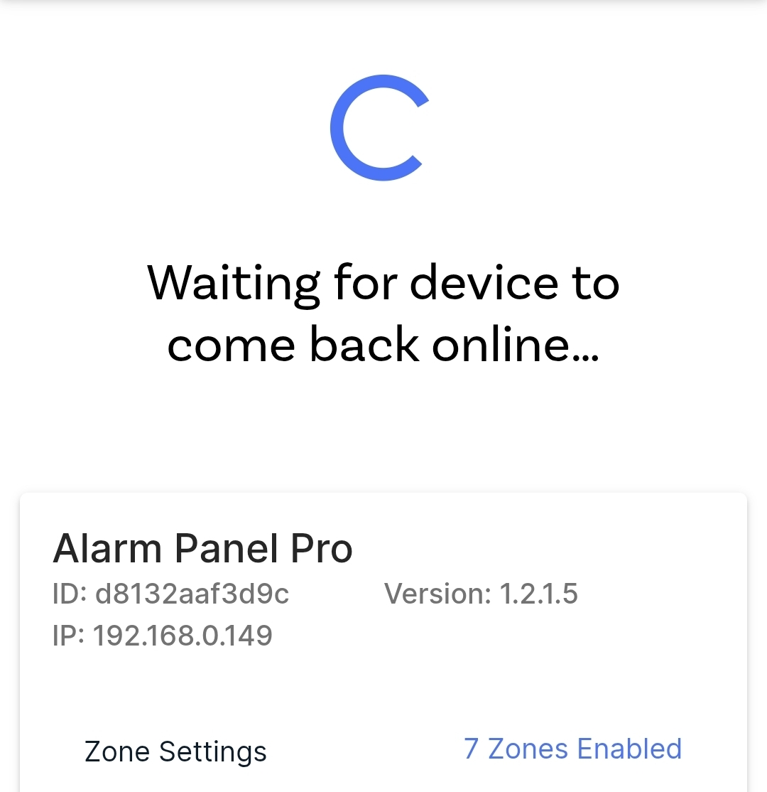

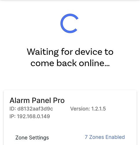

Thanks @nate, it has been unstuck for me. But I can’t install the updated firmware over WiFi. My router has assigned an I.P to the panel, I can access the info page and even trigger the alarm siren manually. However, the firmware install gets stuck with waiting for device to come back online. See attached.
The blue light on the panel keeps flashing which suggests no network connection which isn’t the case.
Also, after installing via usb and log is being checked, nothing is printed after calling app_main(). Could it be related to the blue LED flashing?
Sometimes the network discovery doesn’t work perfectly after an update and the app can’t confirm that the update was completed. It doesn’t necessarily mean that the update failed.
The blue light blinking (on the ESPHome firmware) means that either it doesn’t have an IP address or there’s no native client connected (i.e. Home Assistant) so if you can get to the device via browser and see it in your router, then you know that it does have an IP. The blue light will continue to blink until you discover it in Home Assistant (or Hubitat, etc). If you are using our cloud integrations exclusively, and don’t have a local native platform, then disable the Local Native API in the firmware settings to avoid this.
If you can load the web page, you can manually check that the Project version is updated. Every time you build/update the firmware, the last digit should increment by one.

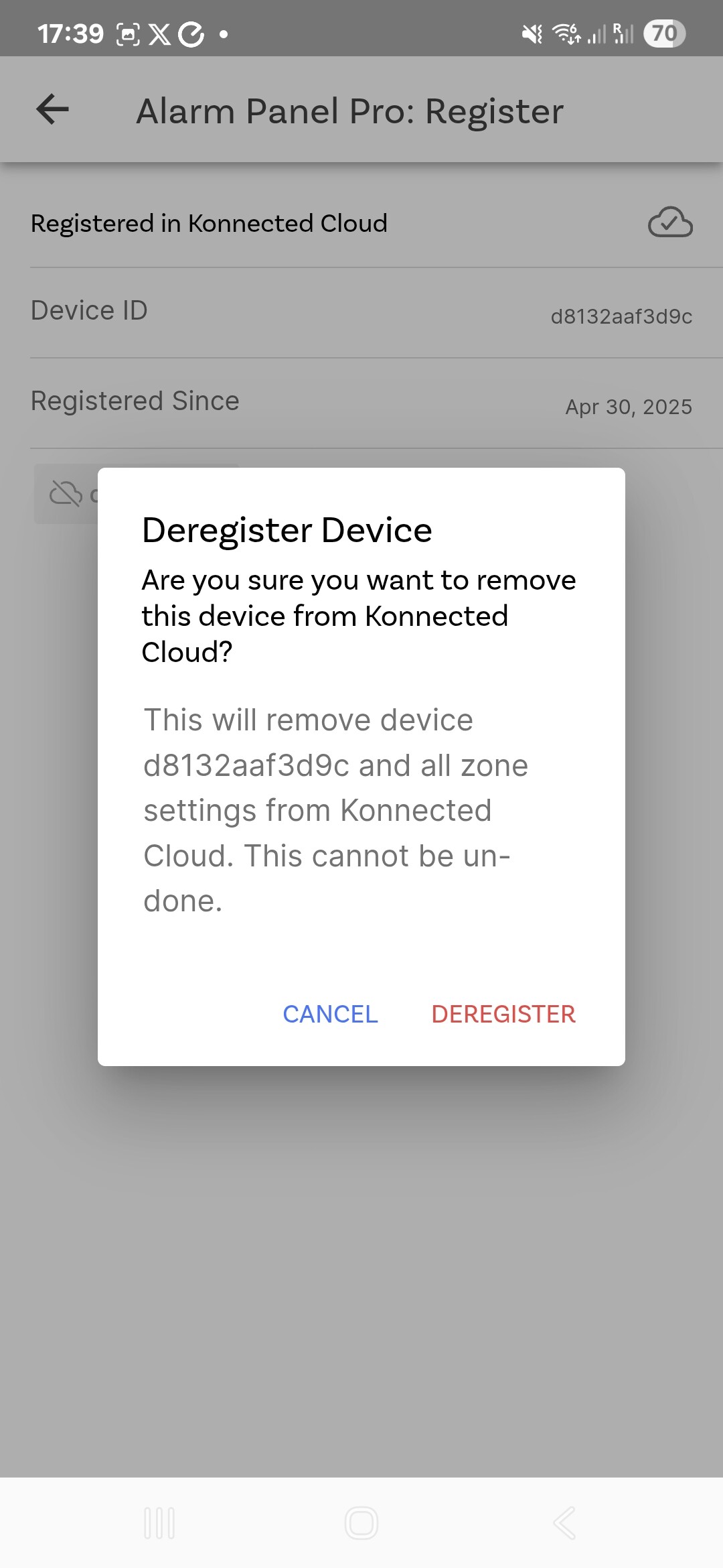

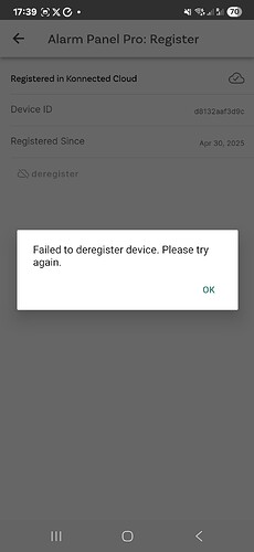

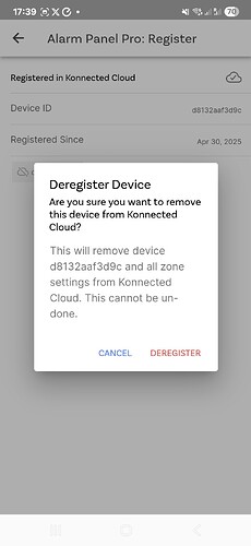

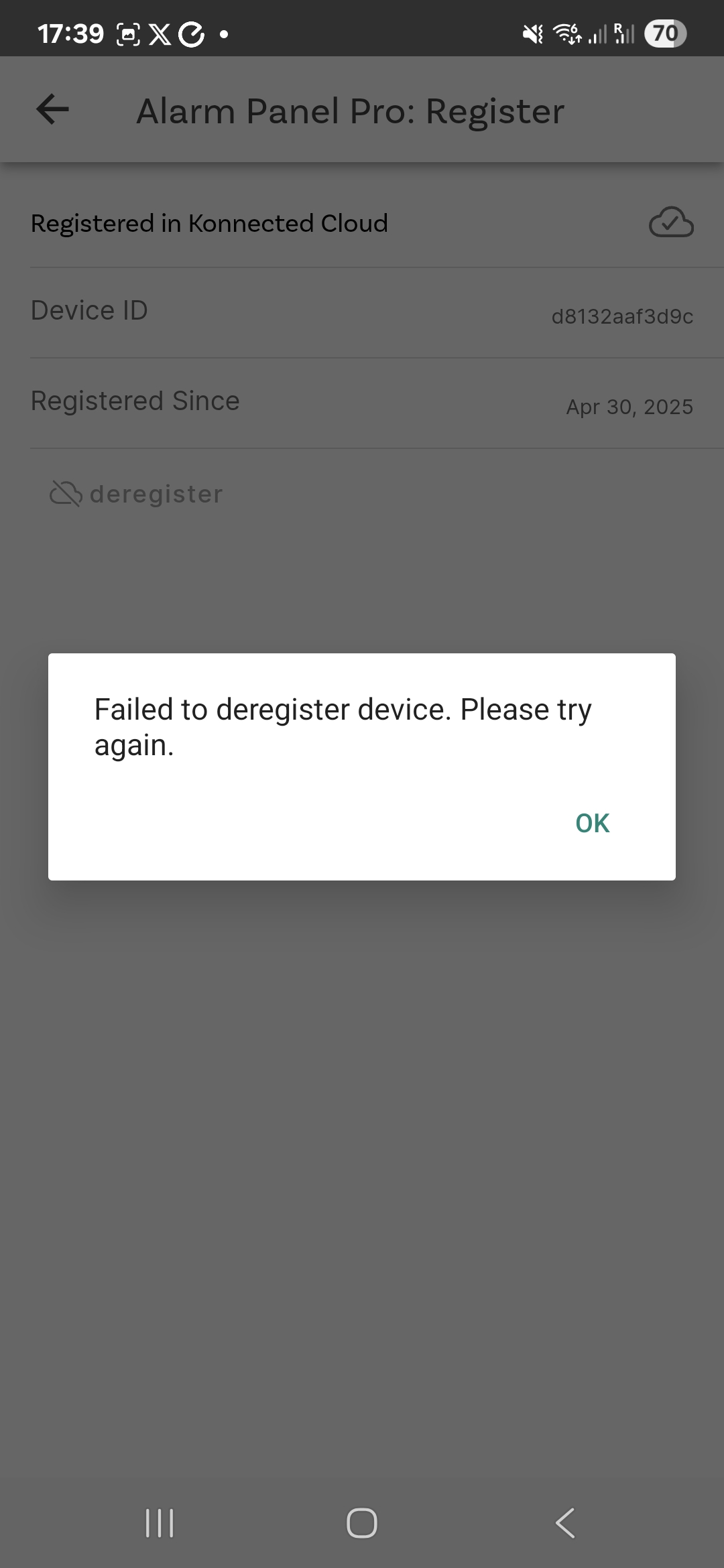

I have tried to deregister the device but it does not work. I have tried this previously and it failed. You can see it was registered in April but I purchased it in June. How is that so? I have raised a separate email about this. I suspect it was registered with a different account before purchase? Please see the attached screenshots. I’m really grateful for your assistance. Thank you.
The registration date in April is actually the date that it was pre-provisioned at our facility. The language in the app is confusing, I know. Last year we changed the way we QA and provision devices, and the app language just needs to be updated to be more clear. Your device is from batch number 2504 which indicates it was manufactured in April(04) 2025.
I will look into the de-registration error and get back to you.
@novince-installer In the meantime, I have de-registered your device for you. You can proceed to re-register it in the EU region using the steps outlined above and that should get you back up and running.
