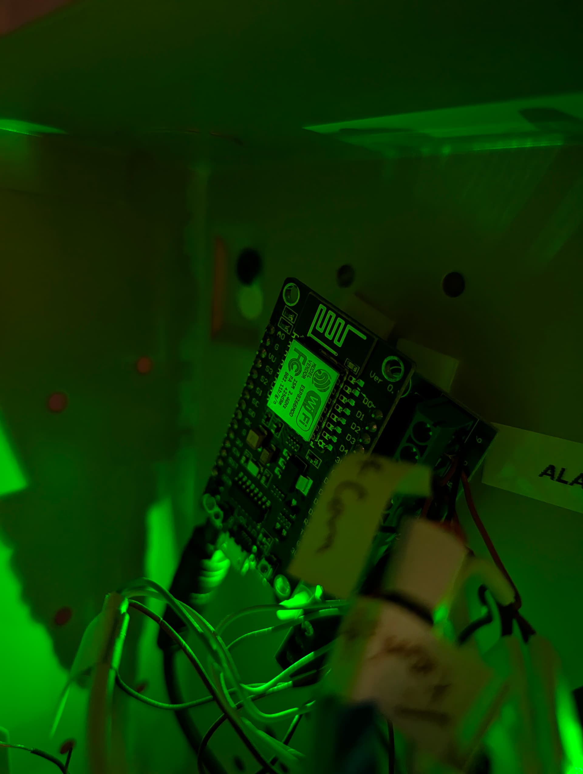

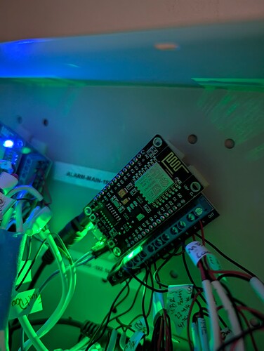

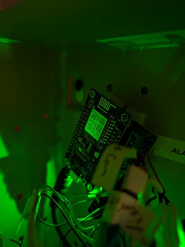

looking to replace a gen1 panel from 2019, the 3 boards are making hissing sound.
believe this is 3 wifi boards 6 zones each. My question is, to go POE, is that one Conversion kit + small 6 alarm add-on with the ribbon between them? Making sure that I’m getting the right models.
