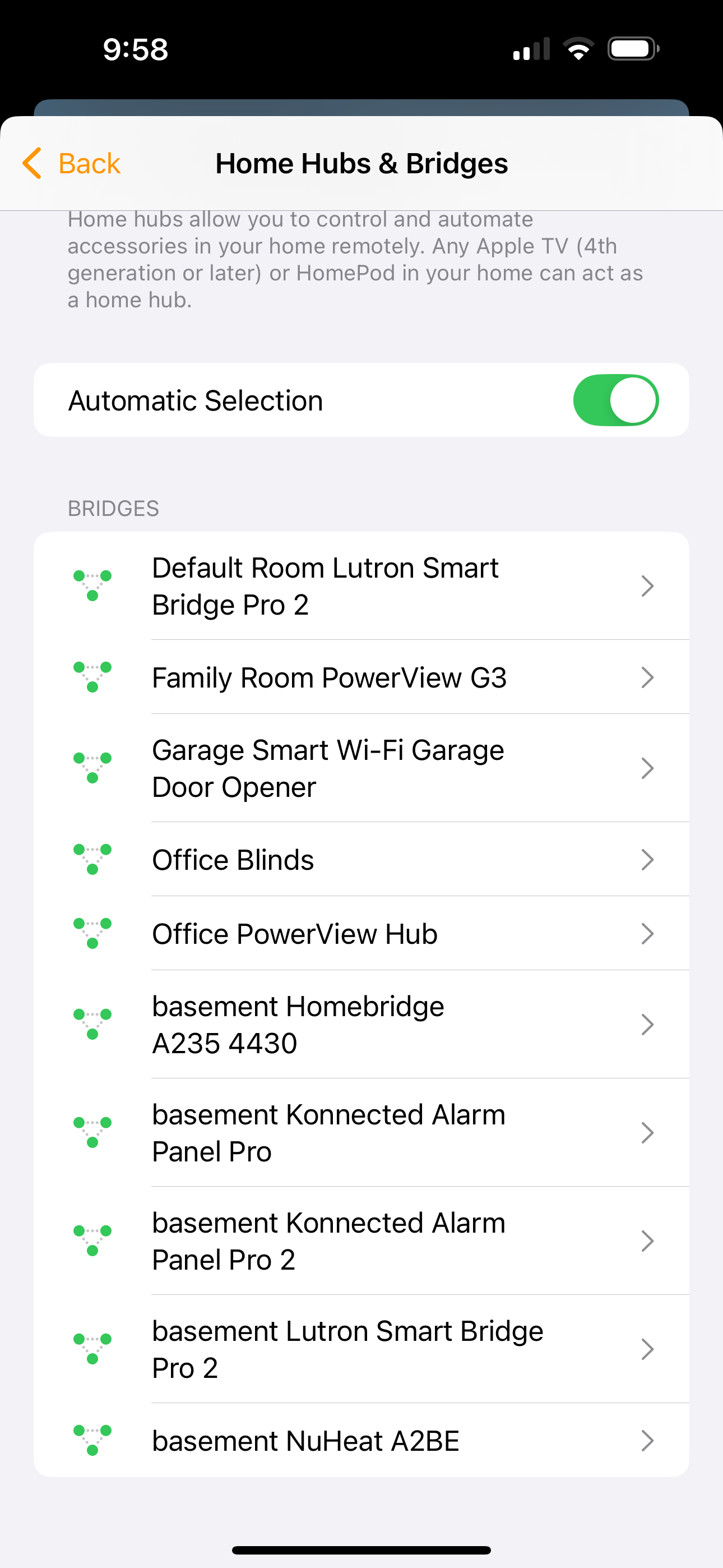

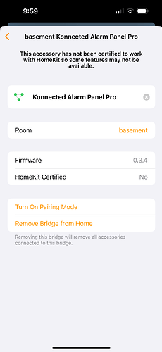

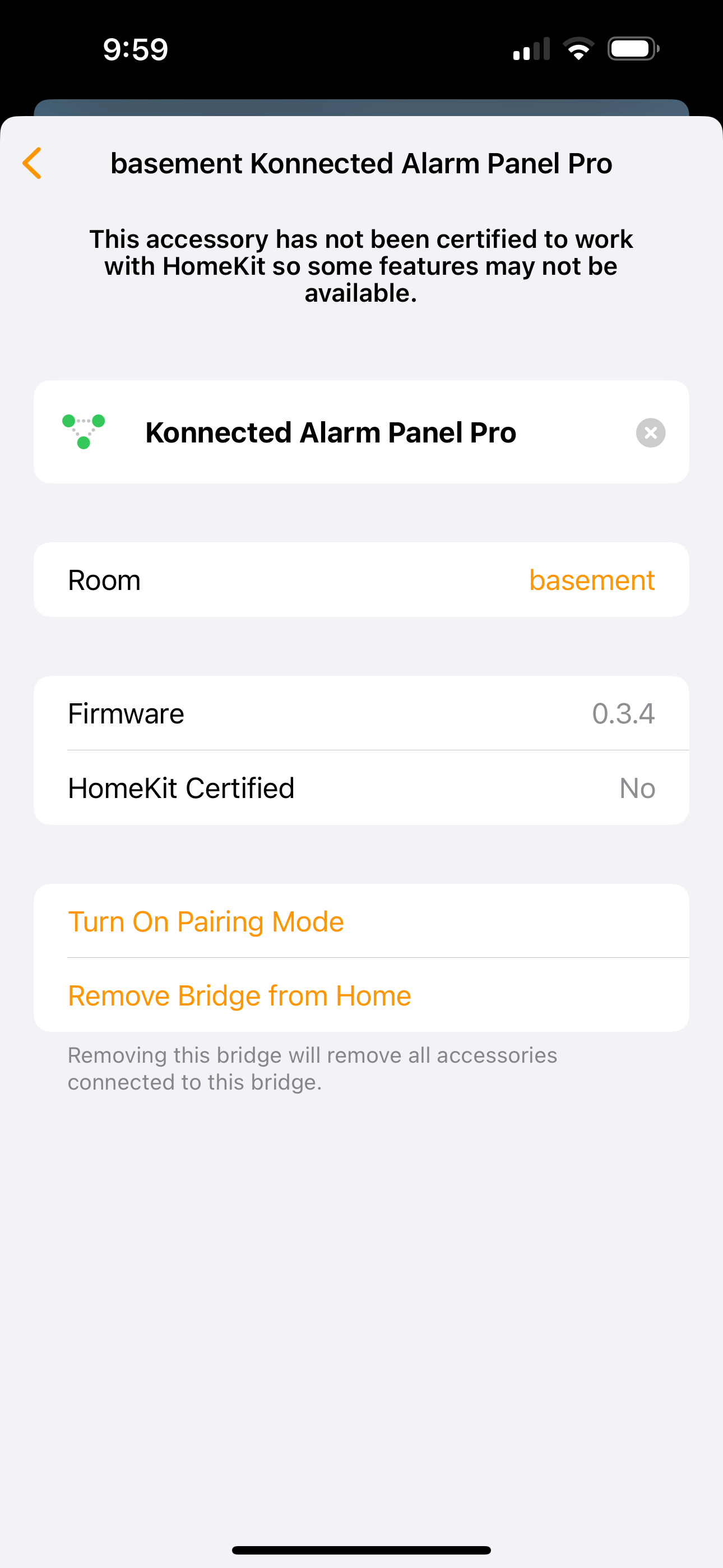

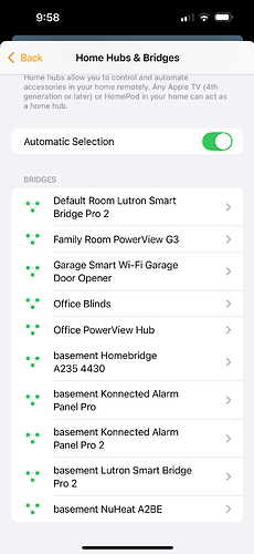

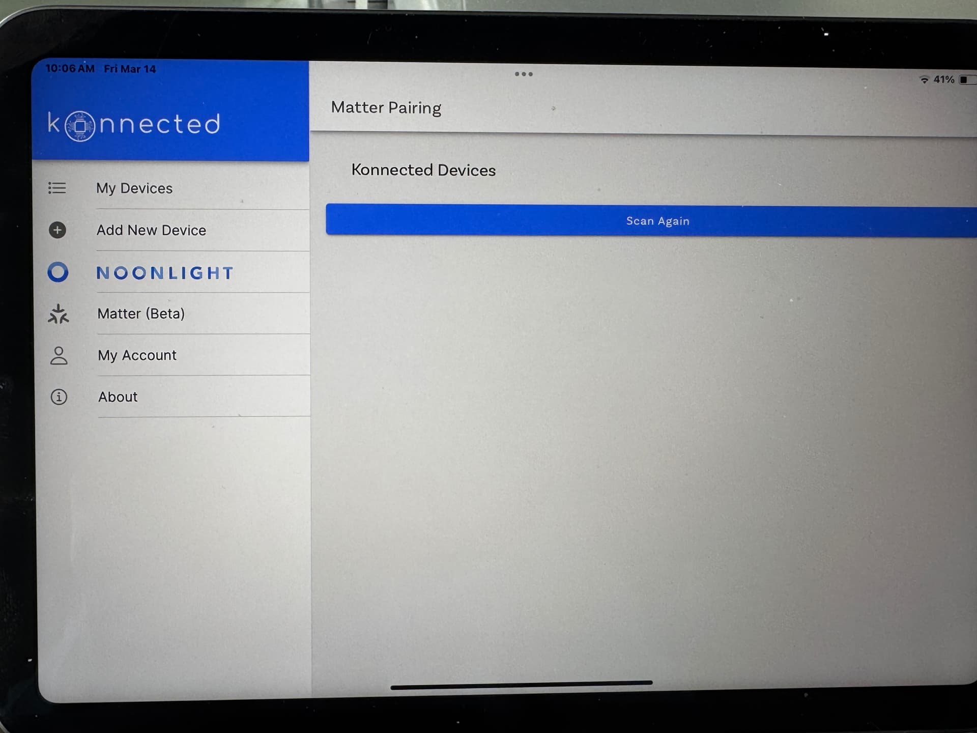

Ben Have you resolved this? I also have my two alarm panel Pros, flashed with the matter firmware and connected them to HomeKit and they appear in the HomeKit Bridges list. I can even open the object in HomeKit, and Trun on Pairing mode which gives me an Accessory Ready to Connect and the setup code. But when I use the Konnected App neither of them show up n the Matter (beta) screen as it only displays Matter Pairing at the top, Knonnected Devices below that and then the long blue bar with Scan Again text on it. Im running the app on a iPad held 12 inches away from the two Alarm Panel Pros. When i look for Bluetooth devices using both the iPad and a MacBook, the two APPs do not show up. Is this normal? Should the Scan now scan the bluetooth or wifi networks to find the APPs.? thanks for any help
It uses Bluetooth to scan for Matter devices. You should NOT put it in pairing mode to discover/configure it in the Konnected app. Pairing mode is for commissioning to another Matter controller.
The Alarm Panel Pro should be comissioned to at least one Matter controller then scan in the Konnected app to access the device configuration via Bluetooth.
I have the two APP connected to HomeKit as Matter bridges so I seem to think the Matter firmware is loaded, But when I use the Konnected App neither of them show up n the Matter (beta) screen. How do I get them to show up so I can configure them ?
It should just show up in the Konnected app on the Matter screen (via Bluetooth). Here’s the documentation: Matter Support (Experimental) for the Alarm Panel Pro
If that doesn’t work let me know and we can debug more

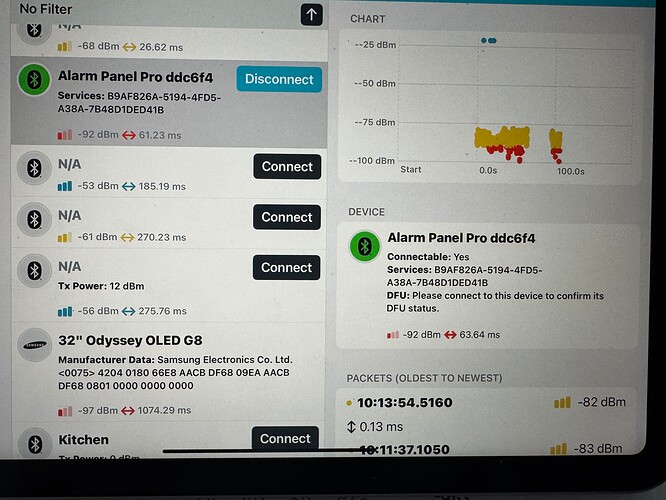

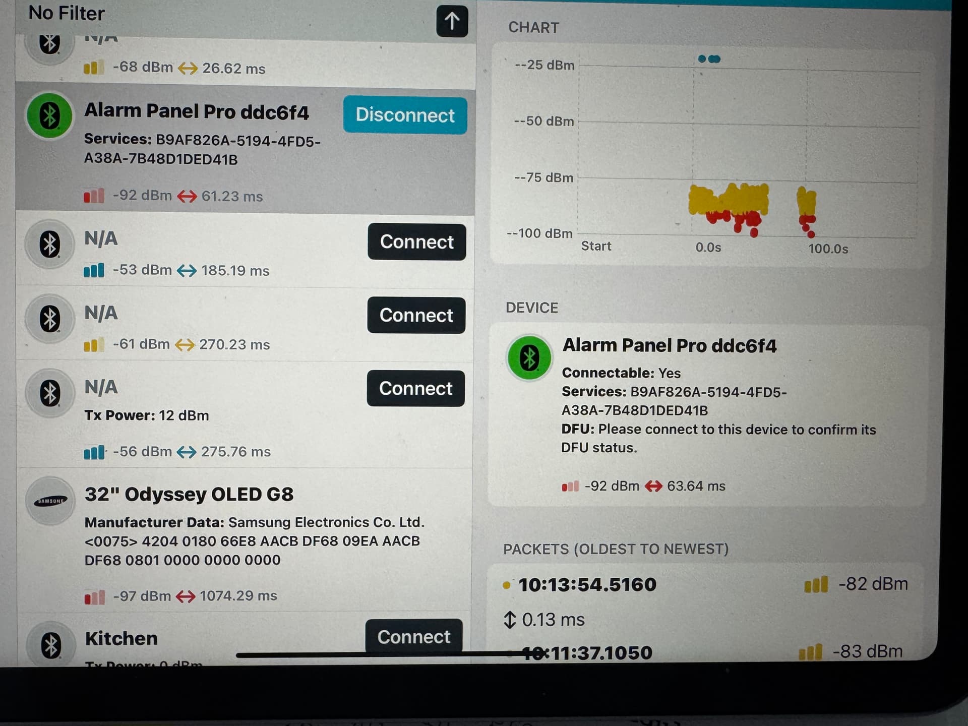

They do not show up in the Konnected app. If they are bluetooth devices shouldn’t they show up as bluetooth devices in the systems setting of IOS, Mac/OS or my router, which is a Cisco Meraki with the other blue tooth devices?
I’m not sure if you should see them in system settings… but they should be discoverable with the NRFconnect app which is a free Bluetooth debugging utility.
@Ryan_P do you have an idea what could be happening here?
Sounds like the device isn’t advertising. Scanning with nrfConnect would prove that.
Ryan, Thanks for the note, but what dos the NRF connect app do that a Bluetooth monitor on a router would not? Is this possibly not standard bluetooth signal or protocol? I assume these are BLE. I’ll get the app later today and test. thanks for the help.
Ryan, the NRFconnect app seems to connect to the Alarm Panel Pro. See attached photo.
Im making headway. I saw a note one can only add matter devices using a Smartphone, iPhone or Google. Something to do with constant certifications of matter, which makes sense. I installed the Konnected app on my iPhone and it instantly found the two Alarm Panel Pros and asked for a Bluetooth pairing request. Wala!!! enter the default pairing code 123456 and it worked for both, then they stopped working. The one started working one did not. Of the one that works, only one contact closure works the other six do not. a they were fine with the non matter connection via the Konnected app.
Ah, that makes sense! What kind of device were you using originally if it was not a smartphone?
