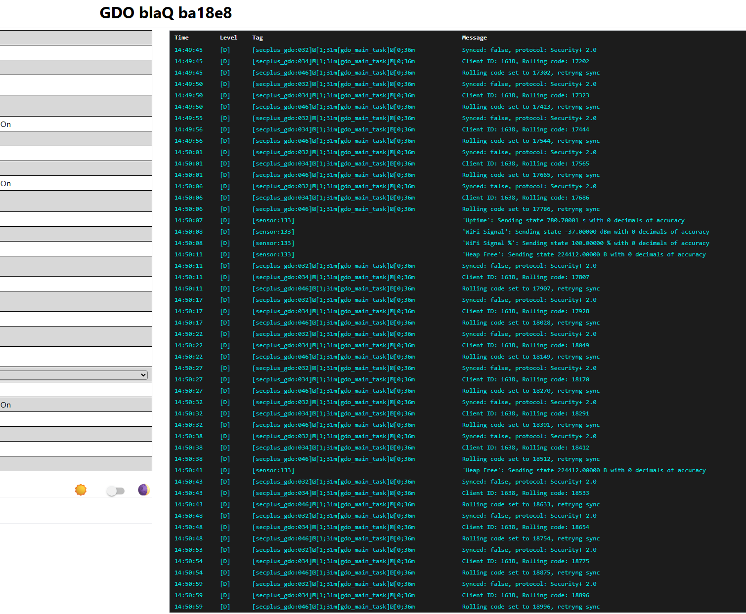

My GDO Blaq seems to be taking long time to sync on the rolling code, i have connected the Red to number 1 red on the garage door opener and the white to 2 white. updated the firware and set the security protocol to 2.0.

Is this a European model opener?
Does it have a green terminal labeled “0” or “e-serial”?
If yes, move the red wire to the green terminal and reboot it.
Hi, yes it has the green block with the ‘0’ i have moved the red connection to the green block and rebooted. but still not connected. Does it take a long time, it keep trying codes?
