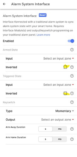

My Pro Konnected Interface Module has been successfully installed and is connected to my WiFi. The SmartThings App Bluetooth has been turned on. The Alarm System Interface has actually not been enabled as there are no available instructions regarding the what the configuration of the Tab pictured below. Also, for some reason the SmartThings App does not see the Konnected Interface Module. Please advise me on how to mitigate these issues. Thanks.
The Interface Module is just an interface module – it doesn’t show up itself as a device or entity in SmartThings. The Alarm Panel Pro orchestrates all the “zones” or devices that are connected to it and each of those show up in SmartThings individually.
Make sure you enable Konnected Cloud in the firmware settings, then link your SmartThings account to Konnected from the SmartThings app > add device > Partner devices > Konnected.
