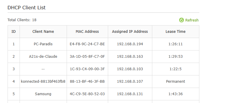

I have the same MAC address problem as John. The last digit is different and the APP is unable to find the board when Flashing.
I have exactly the same problem.
It sounds like the firmware has a different MAC address than the physical Address.
when I installed the board the first time it worked because the firmware created the entry in the router. But after adding more switches to my board and wanted to reflash, the App was unable to find the board.
It is easy to reproduce, simply unplug the power of the network cable, plug then back and try to flash again. If the MAC address in the router is different, then the problem is there.

I am wondering what happens if we do a factory reset on the board and an address already exits in the router? It happened to me that the APP tried to set a second device with no IP. The only way to get to the App was to force the IP via ESPhome.
@user394 thank you for emailing me your logs, this was helpful!
So you are right, the MAC address has changed and when used with Ethernet it’s not the same as the device ID anymore. This actually surprised me, as it used to be consistent. I did a little digging and found that this is a recent and intentional change by the chip maker (Espressif) in ESP-IDF version 5.0 and later, which we just introduced in our firmware builds in December last year.
So, long story short, up to project version 1.1.4 of our Ethernet Alarm Panel Pro firmware, the MAC address for Ethernet would be identical to the MAC address for the Wi-Fi interface. In project version 1.2.0 and later, which upgrades the internal ESP-IDF framework to version 5, the Ethernet interface MAC address is different from the Wi-Fi interface MAC address.
