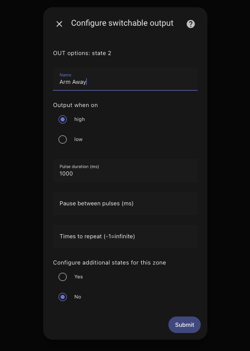

I am trying to replicate my configuration in ESPHome to that of the old Konnect integration in HomeAssistant. I was able to add multiple switchable outputs (Arm Stay and Arm Away), but unsure how I can now do this in ESP. Any help would be appreciated… Thanks

Thanks Nate - had to go down the YAML path but go there in the end.
switch:
- id: armed_away
  pin:
    number: $alarm
    allow_other_uses: true
  platform: gpio
  icon: mdi:shield-lock
  on_turn_on:
  - delay: 1500ms  # adjust to set pulse duration
  - switch.turn_off: armed_away
- id: armed_stay
  pin:
    number: $alarm
  platform: gpio
  icon: mdi:shield-home
  on_turn_on:
  - delay: 3000ms  # adjust to set pulse duration
  - switch.turn_off: armed_stay
