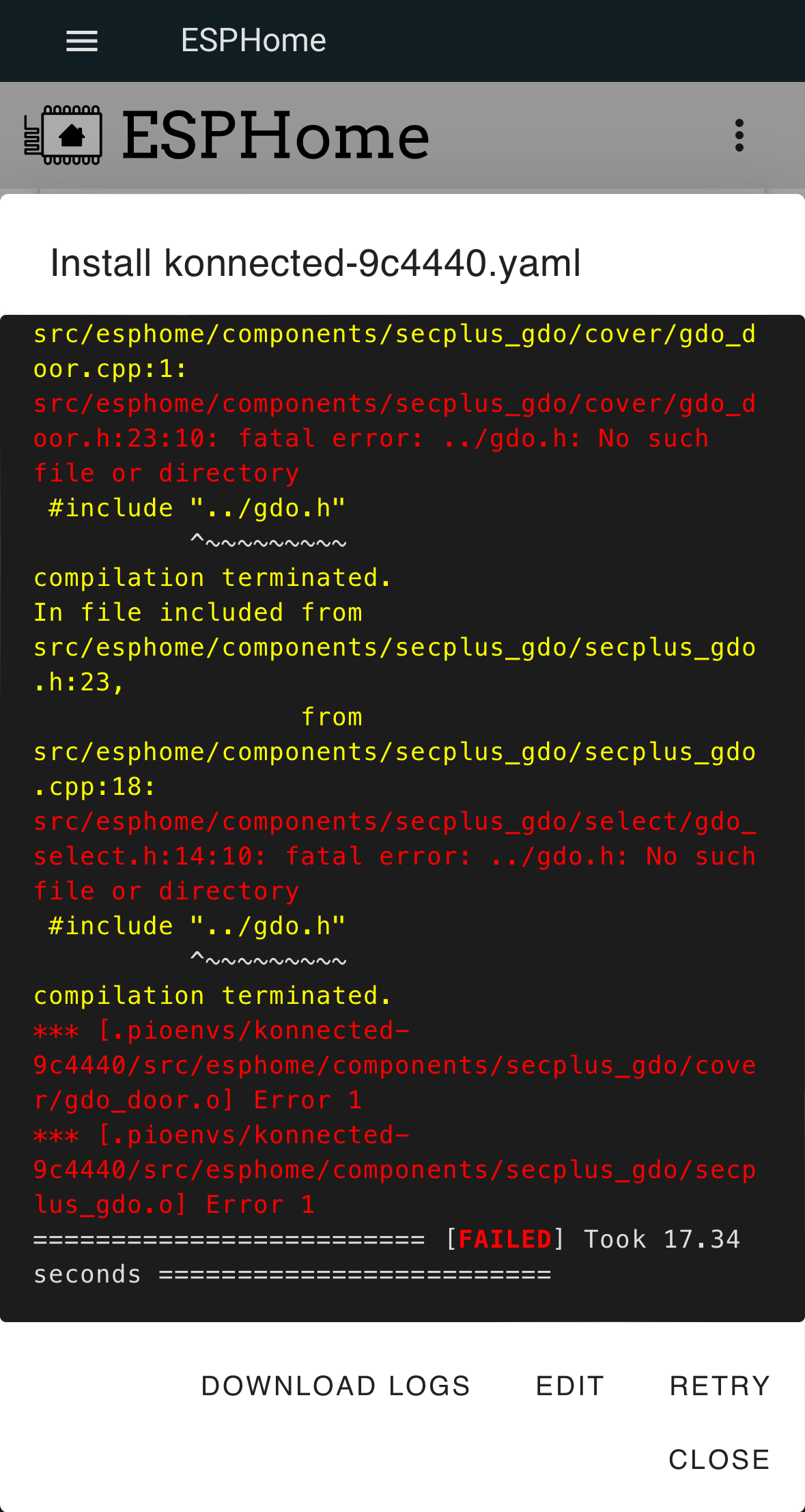

I received the same error. When I logged into ESP Home I briefly saw that there was an update available. The devices were named their generic names then they updated to the names that I had changed them to and the “Update Available” is no longer shower. @nate should I try and update by going to install.konnected.io?
No, I haven’t published a build yet on install.konnected.io. I will do that tomorrow. The update should be pulled in automatically from the updates to konnected-esphome/garage-door-GDOv2-Q.yaml at master · konnected-io/konnected-esphome · GitHub
It may take a few minutes for the GitHub updates to sync to ESPHome dashboard.
If you’re seeing an error, please post what the error is.

    Compiling .pioenvs/konnected-9c42f8/src/esphome/components/secplus_gdo/cover/gdo_door.o
    In file included from src/esphome/components/secplus_gdo/cover/gdo_door.cpp:1:
    src/esphome/components/secplus_gdo/cover/gdo_door.h:23:10: fatal error: ../gdo.h: No such file or directory
    #include “../gdo.h”
    compilation terminated.
    *** [.pioenvs/konnected-9c42f8/src/esphome/components/secplus_gdo/cover/gdo_door.o] Error 1
    ========================= [FAILED] Took 339.80 seconds =========================
The links that were in the log were preventing me from uploading.
Ok it looks like the build, when executed via ESPHome dashboard, is still having trouble linking the relative path to our gdo.h library.
I’m having my firmware engineer take another crack at fixing the build via the ESPHome dashboard method.
In the meantime you can clone the konnected-esphome repo and then run on the command line (from within the project directory):
esphome run garage-door-GDOv2-Q.yaml

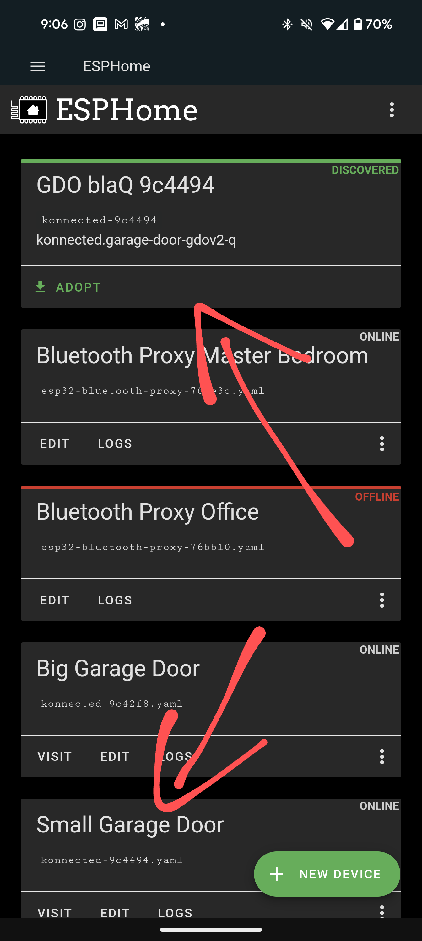

It looks like the other unit pulled in the update I saw another device with the same ID available to adopt.
It currently lists this package: konnected.garage-door-gdov2-q: github://konnected-io/konnected-esphome/garage-door-GDOv2-Q.yaml@master
Is this the expected behavior?
