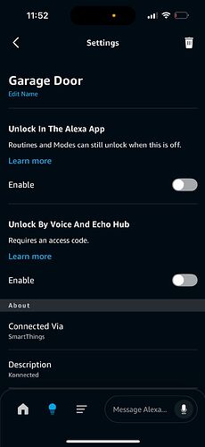

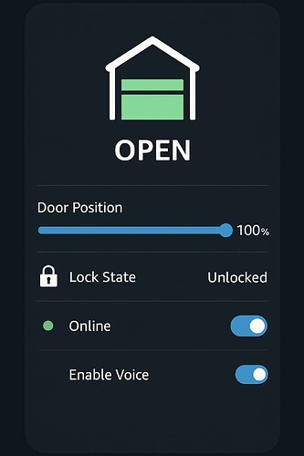

Updated the code further to add the pin functionality for voice mode.
// discovery.js
// Lambda function to handle Alexa.Discovery directives for the GDO Blaq Garage Opener
const { v4: uuidv4 } = require('uuid');
* Builds the Discover.Response for the GDO Blaq Garage Opener device.
function buildDiscoveryResponse() {
return {
event: {
header: {
namespace: 'Alexa.Discovery',
payloadVersion: '3',
messageId: uuidv4(),
payload: {
endpoints: [
endpointId: 'gdo-blaq-001',
manufacturerName: 'Konnected',
friendlyName: 'GDO Blaq Garage Opener',
description: 'Konnected GDO Blaq Garage Opener',
displayCategories: ['GARAGE_DOOR'],
cookie: {},
capabilities: [
type: 'AlexaInterface',
interface: 'Alexa.Discovery',
version: '3'
// Voice control with PIN: ModeController for open/close
interface: 'Alexa.ModeController',
instance: 'Door.VoiceMode',
version: '3',
properties: {
supported: [{ name: 'mode' }],
proactivelyReported: true,
retrievable: true
configuration: {
ordered: false,
supportedModes: [
value: { mode: 'OPEN' },
modeResources: {
friendlyNames: [
{ value: { text: 'Open', locale: 'en-US' } }
value: { mode: 'CLOSED' },
modeResources: {
friendlyNames: [
{ value: { text: 'Closed', locale: 'en-US' } }
semantics: {
actionMappings: [
"@type": 'ActionsToDirective',
actions: ['Alexa.Actions.Open'],
directive: { name: 'SetMode', value: { mode: 'OPEN' } }
actions: ['Alexa.Actions.Close'],
directive: { name: 'SetMode', value: { mode: 'CLOSED' } }
stateMappings: [
"@type": 'StatesToValue',
states: ['Alexa.States.Open'],
states: ['Alexa.States.Closed'],
// Primary widget: tap card to toggle open/close (UI only)
interface: 'Alexa.PowerController',
version: '3',
properties: {
supported: [{ name: 'powerState' }],
retrievable: true
semantics: {
actionMappings: [
directive: { name: 'TurnOn' }
directive: { name: 'TurnOff' }
stateMappings: [
value: { powerState: 'ON' }
value: { powerState: 'OFF' }
// Detail view: slider for setting door position (0–100%)
interface: 'Alexa.RangeController',
instance: 'Door.Position',
version: '3',
properties: {
supported: [{ name: 'rangeValue' }],
retrievable: true
configuration: {
supportedRange: { minimumValue: 0, maximumValue: 100, precision: 1 },
unitOfMeasure: 'PERCENT'
semantics: {
actionMappings: [
actions: ['Alexa.Actions.Open', 'Alexa.Actions.Increase'],
directive: { name: 'SetRangeValue', value: { rangeValue: 100 } }
actions: ['Alexa.Actions.Close', 'Alexa.Actions.Decrease'],
directive: { name: 'SetRangeValue', value: { rangeValue: 0 } }
stateMappings: [
// Detail view: lock/unlock button
interface: 'Alexa.LockController',
version: '3',
properties: {
supported: [{ name: 'lockState' }],
retrievable: true
// Detail view: online/offline connectivity indicator
interface: 'Alexa.EndpointHealth',
version: '3',
properties: {
supported: [{ name: 'connectivity' }],
retrievable: true
// Settings: enable or disable voice open/close
instance: 'Door.VoiceSetting',
version: '3',
properties: {
retrievable: true
configuration: {
ordered: false,
supportedModes: [
value: { mode: 'ENABLED' },
modeResources: {
friendlyNames: [
{ value: { text: 'Voice Enabled', locale: 'en-US' } }
value: { mode: 'DISABLED' },
modeResources: {
friendlyNames: [
{ value: { text: 'Voice Disabled', locale: 'en-US' } }
semantics: {
actionMappings: [
actions: ['Alexa.Actions.Enable'],
directive: { name: 'SetMode', value: { mode: 'ENABLED' } }
actions: ['Alexa.Actions.Disable'],
directive: { name: 'SetMode', value: { mode: 'DISABLED' } }
stateMappings: [
states: ['Alexa.States.Enabled'],
states: ['Alexa.States.Disabled'],
* Main Lambda handler
exports.handler = async (event) => {
const { directive } = event;
const { header } = directive;
// Handle Discovery request
if (header.namespace === 'Alexa.Discovery' && header.name === 'Discover') {
return buildDiscoveryResponse();
// If not handled, throw an error
throw new Error(`Unsupported directive: ${header.namespace}.${header.name}`);
