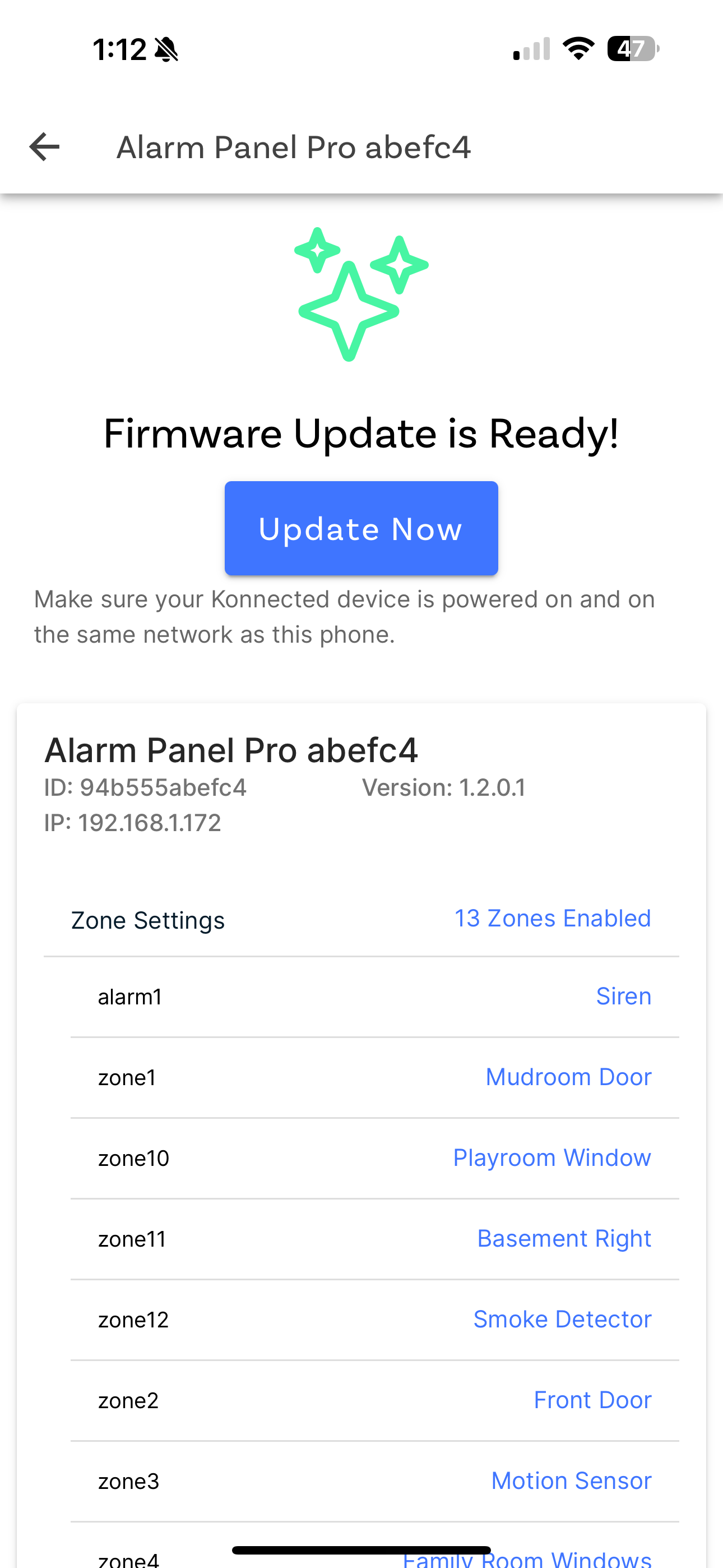

@Ron_D Your problem here is that you have “0 zones enabled” in the firmware settings. Go back to Settings > Manage Zones and enable the zones that you want to use by assigning a type and name.
I have done this probably a dozen times, it does not ever keep zones. I will try again. Tell me should I be doing ESP or legacy updates?

@Ron_D You are using the newest ESPHome-based firmware which is good. It looks like you originally set up your zones using the legacy firmware but later switched, so that’s why they are showing as offline. Please delete those zones from SmartThings, then you have to re-add them in the Konnected app. The screenshot you showed above shows 0 zones enabled. Make sure you check the “Enabled” toggle on each zone you want to enable. It should look something like this:
Once you have set up your zones, tap the back arrow, then Save & Continue, then Build now, then Update now to update the device over-the-air. You do NOT need to update it with your computer – doing it from the app is quicker and easier.

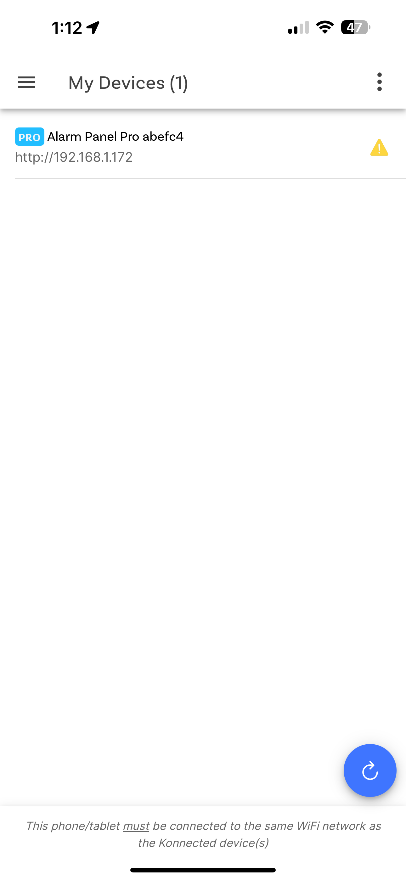

What do I do with the Yellow Triangle showing port 9123?
