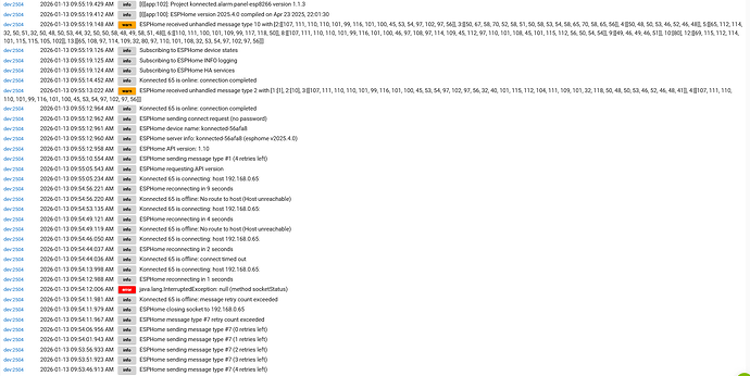

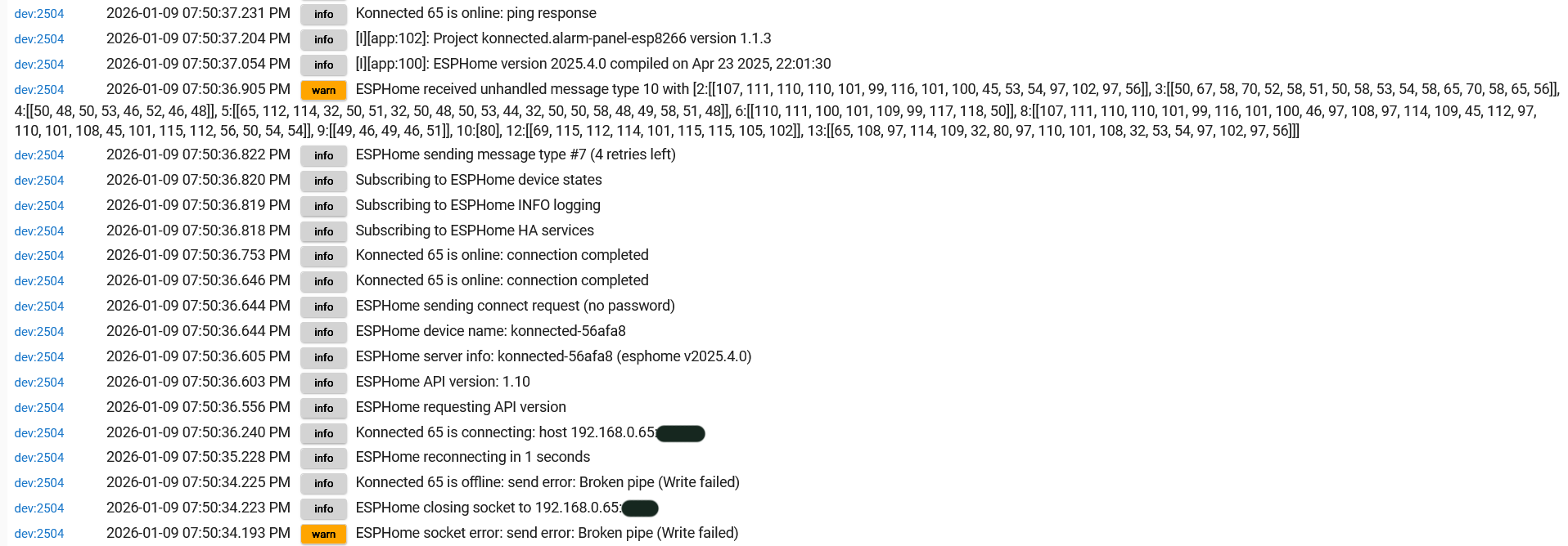

Getting this frequently every day in my Hubitat logs from both of my Konnected boards. Any concerns?

I updated per the instructions. Still getting this in my logs. Any concerns?
Try updating the device firmware as well (via the Konnected app).
I am using the Konnected app. I do not get a notification that an update is available.
Which version of ESPHome am I supposed to have? This is confusing.
ESPHome releases a new version every month. The version number is in the format of YYYY.MM.X where X is an incremental number. Our app firmware update service automatically pulls in the latest ESPHome version.
The current version is 2025.12.6 indicating it’s the 6th patch release of the December 2025 release.
The exact ESPHome version doesn’t really have too much of an impact. There’s no need to update it with every little patch release, but a good idea to update every few months or so.
