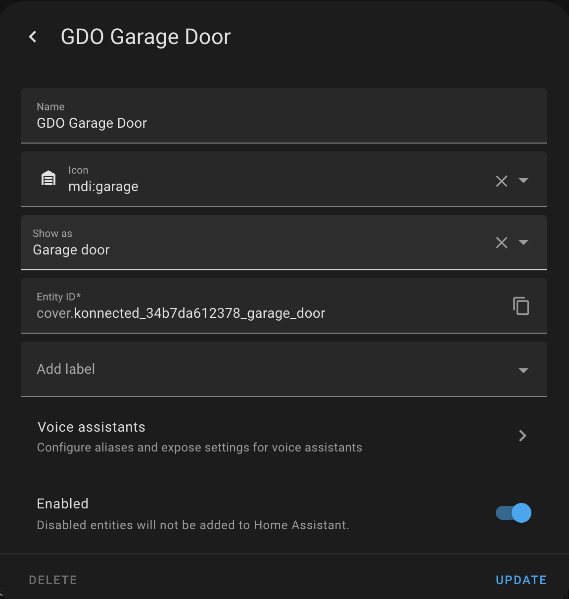

I MAY have found the fix for my situation. I removed the HomeAssistant HomeKit Bridge, edited the entity for the GDO Blaq in HomeAssistant to specify âShow Asâ as a Garage Door, and recreated the Bridge. Upon inclusion it is now seen as a Garage Door vs Shade. Off for a car ride to see if this worked:-)
I just ran into the same thing, changed from the white GDO to the BlaQ, the white always showed up as a garage door but the BlaQ was showing as a shade and so wouldnât show up automatically in Car Play and I also noticed that when I switched it to âShow as Garage Doorâ it automatically changed to notify on open/close in HomeKit so Iâm guessing it will work. Havenât been out to the car to test it yet. I tested today and it shows up automatically in CarPlay after changing the show as to garage door.

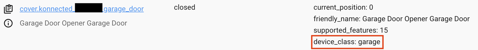

In trying to troubleshoot it, I suspected it was because the entity was not set with a âdevice classâ of âgarageâ. Changing the âShow Asâ to Garage Door sets this class on the entity:
Also note that I didnât have to delete the HomeKit bridge, it just automagically updated all the way through to the Apple Home app, and now works perfectly as expected!
