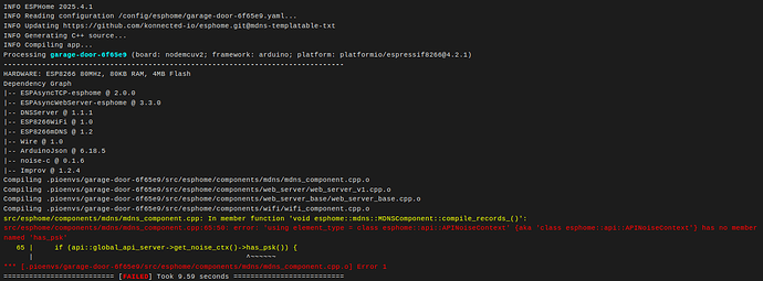

@nate Getting the following error when attempting recent ESPHome 2025.4.1 update:
Any advice would be greatly appreciated.
Compiling .pioenvs/garage-door-6f65e9/src/esphome/components/mdns/mdns_component.cpp.o
Compiling .pioenvs/garage-door-6f65e9/src/esphome/components/web_server/web_server_v1.cpp.o
Compiling .pioenvs/garage-door-6f65e9/src/esphome/components/web_server_base/web_server_base.cpp.o
Compiling .pioenvs/garage-door-6f65e9/src/esphome/components/wifi/wifi_component.cpp.o
src/esphome/components/mdns/mdns_component.cpp: In member function ‘void esphome::mdns::MDNSComponent::compile_records_()’:
src/esphome/components/mdns/mdns_component.cpp:65:50: error: ‘using element_type = class esphome::api::APINoiseContext’ {aka ‘class esphome::api::APINoiseContext’} has no member named ‘has_psk’
65 | if (api::global_api_server->get_noise_ctx()->has_psk()) {
*** [.pioenvs/garage-door-6f65e9/src/esphome/components/mdns/mdns_component.cpp.o] Error 1
========================== [FAILED] Took 9.59 seconds ==========================
See: 2025.4.0 Error: mdns_component.cpp.o] Error 1; {aka 'class esphome::api::APINoiseContext'} has no member named 'has_psk' · Issue #80 · konnected-io/konnected-esphome · GitHub
Long story short, some updates to MDNS component that I made are conflicting with some other unrelated updates added around the same time. All will be resolved in the next ESPHome release, so the simple thing to do is just wait a couple weeks for ESPHome 2025.5.

@greg9 The code that fixes it will be in 2025.5
Issue resolved with ESPHome 2025.5 update released on May 21, 2025 as suggested. Thank you as always!
