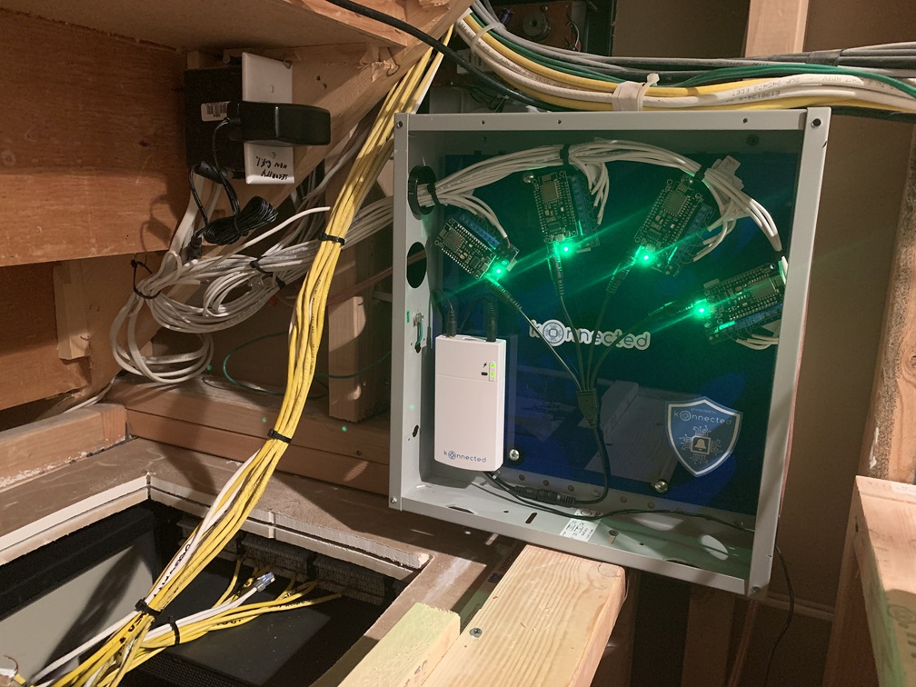

Longtime user…been running 3 Add-On Boards and 1 Add-On +Siren board for a few years. All firmware updates were completed on these V1 boards.
Recently I reflashed my Hassio Raspberry Pi 3 install due to their deprecation of 32bit OS systems. Hassio is back up and running fine. However, I am no longer able to get the Konnected boards to connect to Wifi. I have tried everything I can think of. Powering down each board, attempting to connect one at a time using the Konnected app. Sometimes it finds them and looks like it’s connecting to Wifi but the blue lights keep blinking. I’ve also powered own my entire network and Hassio, attempted to connect the Add-On boards to Wifi, same story.
As all 4 boards disconnected at the exact same time (when I upgraded Hassio) I don’t believe this is a hardware failure.

Done. I removed all the modules and was able to update them to ESPHome. I then used the app and connected each to Wifi. The blue lights are still blinking but the app sees the units now.

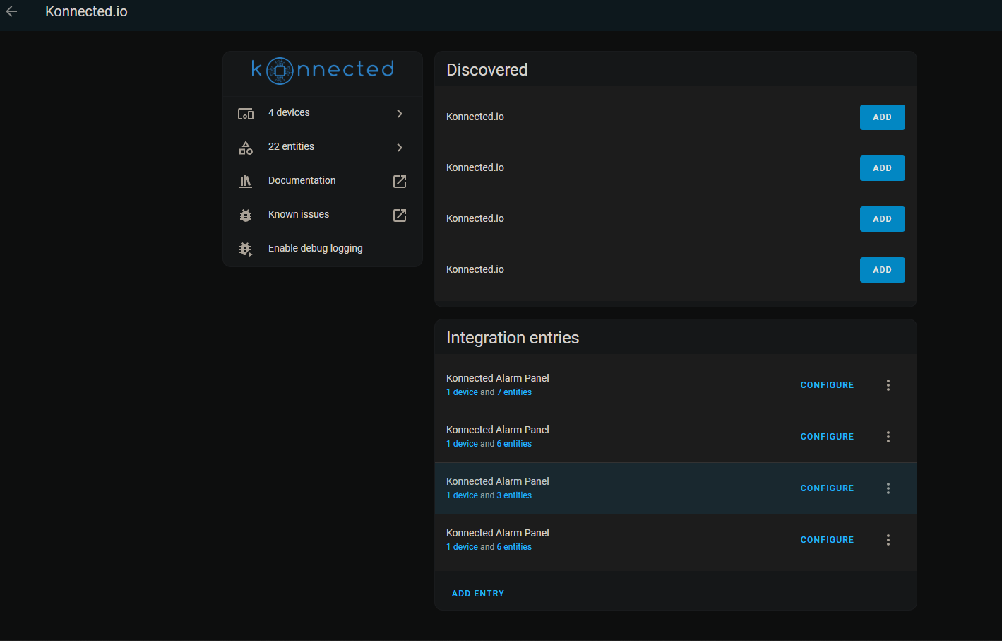

In Hassio, it sees the units but will not connect to them. It installed the ESPHome system but every time I try to ADD the 4 devices I get “Failed to Connect”.
Okay, so it takes a while for Hassio to see the new hardware. They are installed now and working with ESPHome. I have more config to do but I think I am good now. Thanks.
