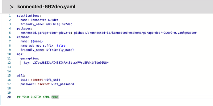

Regarding where to put the code – the best practice is to adopt the device in ESPHome Builder, then just stick your customizations at the bottom of that adopted config, like this:
If you’re compiling the firmware directly from our garage-door-GDOv2-Q.yaml file directly, that’s totally acceptable, and yes you can add it as another package if you’re doing it that way.
